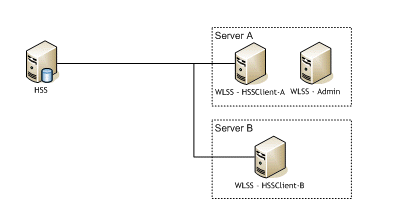

This section examines how we set up the test environment and how we drive the test with Bridgewater Systems. We start by presenting how we configure the environment, then we briefly discuss the Web application used in the test and a description of the messages exchanged between WebLogic SIP Server and the HSS. The system under test consists of two servers running the WLSS 2.2 instances, acting as a DIAMETER node, connected with the Bridgewater HSS. On one server two instances of WLSS will be running, one acting as an Admin Server, one as a DIAMETER node. The other DIAMETER node is running on the other server, as showed in Figure 3:
Figure 3. The test environment

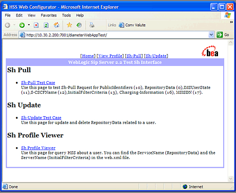

The application
The sample application presented in this article is a simple example built for testing in an easy way the message flow described in this article. The application lets you query and update the data stored in the HSS. It's possible to send out Sh-Pull, Sh-Update, and Sh-Subs-Notify requests using a simple Web interface. You can choose the user name, the type of request, the service name, in case of Sh-Pull, and the service data and service value in case of Sh-Update. This application shows that WLSS can successfully communicate with an HSS and conforms to 3GPP Technical Specification documents for the Sh interface.
Figure 4. Show the home page of the Web application used to test Sh
There are three simple JSP pages: The Sh-Pull.jsp is used to test Sh-Pull request, the Sh-Update.jsp is used to test Sh-Update, and the Sh-Subs-Notif is used to test Sh-Subs-Notif. There is another special page, the profileViewer.jsp, which is used to query the HSS and get the full user profile. All you have to do is to insert the username in the field, and submit the form. In the web.xml you can find two parameters:
- serverName - used to query for InitialFilterCriteria
- serviceName - used to query the HSS with UDR and PUR and correspond with ServiceIndication

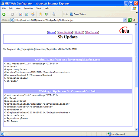

These parameters are read at startup and you can change them to meet your requirements. Once the connection with the HSS is established you can use those pages to query the HSS. In addition, the Web application prints out the ResultCode, the XML response generated by the HSS, and eventually the exception, as showed in Figure 5:
Figure 5. Show a simple PUR response (click the image for a full-size screen shot)

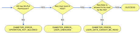

Step 2: Testing Sh-Pull
After it has established the connection WLSS could send a User-Data-Request (UDR) request to the HSS Server: The HSS should correctly read the request and send a response User-Data-Answer (UDA). Going the other way, the application should be able to read the response: Each of them should match. The following diagram shows the behavior of the UDR:
Figure 6. Show UDR behavior (click the image for a full-size screen shot)
The preconditions for a positive test result are summarized below:
- The WLSS is connected to the Bridgewater HSS.
- The Base DIAMETER Stack is configured to communicate with the HSS.
- The user exists in the HSS.
- WLSS is in the HSS table list and the authorization of Repository Data for WLSS is set to readable.

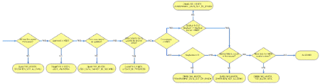

Step 3: Testing Sh-Update
This command type can be used to update user data contained in the HSS. The same command can be also used to remove user information from the HSS. WLSS sends a Profile-Update-Request (PUR) toward the HSS that executes the update and replies with a Profile-Update-Answer (PUA) containing the result of the operation.
It is important to emphasize that a SIP Application Server can update/remove data about the services it is owning.
Figure 7. Show PUR behavior

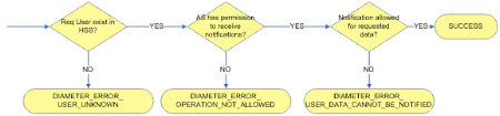

Step 4: Testing Sh-Subs-Notif
The message is used by the WLSS to subscribe to a user that exists in the HSS. The WLSS sends a Subscribe-Notifications-Request (SNR) to receive notifications of user data changes specified in the SNR. The HSS acknowledges the SNR with a Subscribe-Notification-Answer (SNA). The same command is used to remove the subscription.
Figure 8. Show SNR behavior
