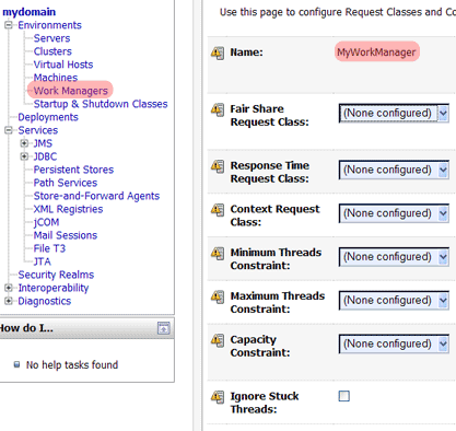

Now that we have our Work implemented we're ready to rewrite the servlet code to use WorkManager, but first we need to define WorkManager in our container.
Defining WorkManager in Container
Work Managers are container resources, just like JMS queues and connection pools. You can configure these components using the Administration Console. In essence, a WorkManager is just a thread pool with capacity parameters, with the minimum and maximum number of threads to allocate, response time strategies, and so on. None of these options are modifiable through the console in the beta version though, so the whole configuration comes down to providing a name for the newly created WorkManager. We use MyWorkManager for this example.
Figure 1
Figure 1. WorkManager configuration in WebLogic 9.0
When you've completed the configuration, restart WebLogic Server; on startup, you should see (either in the console or in log files, depending on your logging settings) that MyWorkManager is created for your application:
<Mar 31, 2005 5:42:47 PM EST> <WorkManager> \
   <Creating WorkManager from "MyWorkManager" \
   WorkManagerMBean for application "workman.war">
Now the MyWorkManager you just defined is available in the JNDI tree. The container can support an arbitrary number of independent WorkManager instances. The primary method for obtaining a WorkManager instance is through a JNDI lookup in the local Java environment (that is, java:comp/env/wm/[work manager name]). Therefore, Work Managers are configured at deployment time through deployment descriptors as resource-refs. Each JNDI lookup of a specific Work Manager (for example, wm/MyWorkManager) returns a shared instance of that WorkManager. Since WorkManager is thread-safe, the lookup could be done once, usually in init() method of a servlet or ejbCreate() method of a session EJB.
