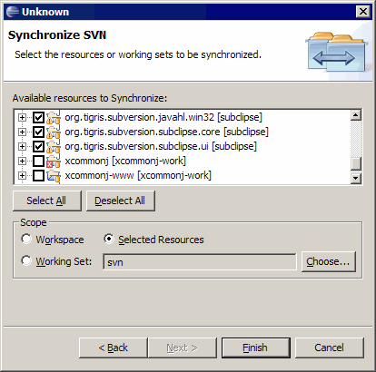

Choose the Synchronize... action in the toolbar drop-down to start the wizard. On the first screen it again allows you to select the SVN version tracking system and then shows the standard resource selection panel, where you can choose to synchronize an entire workspace, select some set of projects, or use a named Working Set.
Figure 12. Synchronize a workspace, working set, or selected resources.

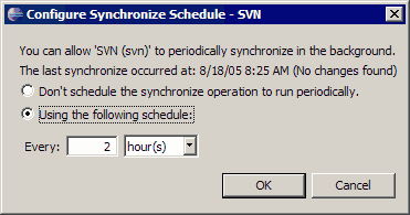

Once created, the Synchronize view can schedule an automatic refresh with the version control system. This can be configured from the Schedule... menu in a Synchronize view menu. This will help you stay up to date, and allows you to see all incoming changes from other developers.
Figure 13. Schedule automatic refreshes.

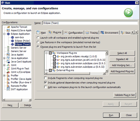

When all the projects are in your Eclipse workspace, you can try to run it. Use the Run -> Run... menu (or Debug to run under debugger), create a new launch for an Eclipse Application type, and select the Subclipse plug-ins from the Workspace Plug-Ins list. If you are running an IDE with an installed Subclipse, then you should also uncheck the Subclipse plug-ins in the External Plug-Ins list, but keep all other plug-ins selected.
Figure 14. Run the Eclipse application.
Click Run (or Debug), and if everything has been configured correctly you'll get a second Eclipse Workbench window; you should be able to open Subclipse views and connect to repositories as with the main Eclipse instance. At this time, if running under debugger you can start putting breakpoints in Subclipse classes or Eclipse core classes used by Subclipse, and the debugger will stop on those breakpoints. A good starting point is the org.tigris.subversion.subclipse.ui.actions package in the org.tigris.subversion.subclipse.ui plug-in, which contain Subclipse-specific UI actions available in menus or toolbars. Note that actions can be registered with the UI either declaratively in plugin.xml (usually action element) or programmatically in the Java code, so you have to look in both places.
