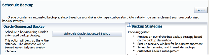

Scheduling a Full Backup
We can now proceed to schedule the database backup.

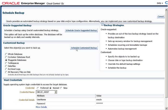

In the Enterprise Manager Cloud Control 12c console, select Availability > Backup & Recovery > Schedule Backup from the Home page of the PROD database.
Figure 8: Schedule Backup
In the Customized Backup section of the Schedule Backup screen, select Whole Database, then click Schedule Customized Backup.
The Customized Backup section also allows you to backup individual Tablespaces, Datafiles, or only the Archived Logs. The final option on this page is to backup All Recovery Files on Disk. Choose this option to backup the FRA of the database to tape.
You can create the FRA only in an Oracle Database version 10g or later. This area is where all the RMAN backup pieces, image copies, and archive logs are stored. Backing up the FRA creates a backup of your backup—ideally, as Oracle recommends—to a less expensive disk (i.e., not your tier 1 or even tier 2 disk) instead of tape. The DBA can then perform a fast recovery from the available disk-based backup, in case of any production issues, rather than waiting for the tape to be located and the tape backup to be restored to the disk.
The FRA, which contains the disk-based database backups, can then be backed up to tape once a week, allowing offsite tape backups as well as onsite disk backups. This would be a suitable Oracle backup strategy.

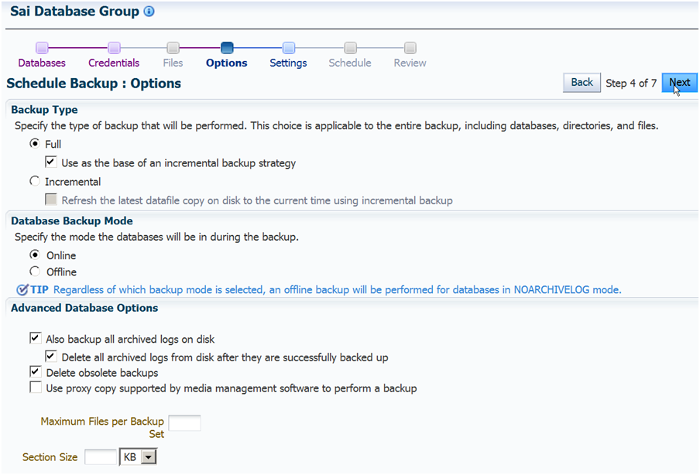

First, select Full Backup as the Backup Type, then check Use as the base of an incremental backup strategy. We are going to set up a full backup of this type on Sundays, as well as a daily incremental backup of the database.
Select Online Backup as the Backup Mode, then scroll down to the Advanced section.
Figure 10: Advanced Section
Select Also back up all archived logs on disk as well as Delete all archived logs from disk after they are successfully backed up.
Selecting these options configures the backup to include all archive logs with the full database backup and deletes the archive logs from disk after they are backed up. To delete backups marked as obsolete (as per the retention policy), select Delete obsolete backups.

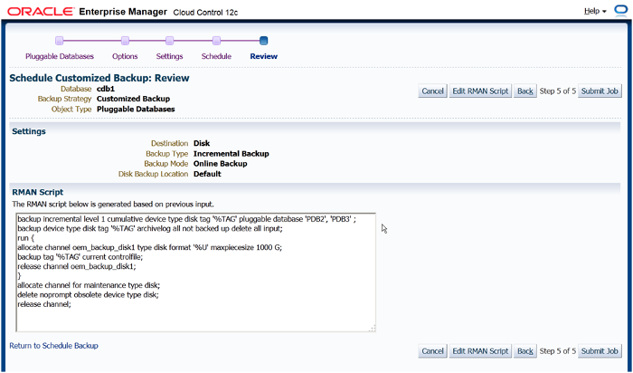

Move to the next page. This is the Scheduled Customized Backup: Review screen.
Figure 13: Review of the Scheduled Backup
Enterprise Manager Cloud Control 12c has generated the RMAN script that will be used in the backup, based on the input criteria you identified in the previous screens.
The RMAN commands perform a full database and archivelog backup. The archive logs are deleted after backup, after which the maintenance commands that delete obsolete diskbackups are executed. These actions are derived from what we previously specified in the Cloud Control backup setup and backup schedule wizard pages.
To make modifications to the generated script and then submit it, click Edit RMAN Script. Once modifications are made, you cannot return to the previous pages of the Wizard. Nevertheless, you may want to change the RMAN script to include extra maintenance commands that will crosscheck backups and archivelogs, and delete the backups and archivelogs that have expired. These commands can be:

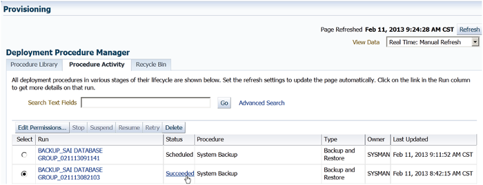

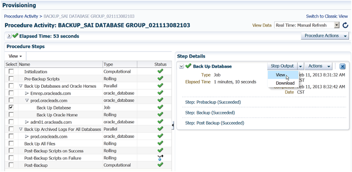

Click Submit Job. After the job is submitted successfully, you can then select View Job to see the job's status and progress:
Figure 14: Job Summary
Click the Succeeded link in the status column to view the output in detail.
The RMAN output appears as follows:
Figure 15: RMAN Output

The RMAN script generated is displayed in the Review screen, as shown below:
Figure 19: Generated RMAN Script for Incremental Backup
The RMAN script issues the backup incremental level 1 "cumulative… database" command. The full output of this job, after successful completion, is shown below:

Oracle Suggested Backups

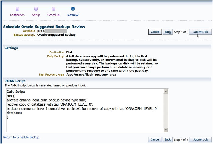

On the Schedule Backup screen, you can also create an Oracle Suggested Backup, as follows:
Figure 21: Oracle Suggested Backup
If you choose this option, an RMAN script is generated to perform backups as per this strategy, as demonstrated below:
Figure 22: RMAN Script for Oracle Suggested Backup
Using this automatically generated script, RMAN will perform a full database copy on the first backup, creating datafile copies rather than RMAN backup pieces. Consequently, an incremental cumulative backup will be performed daily that updates the datafile copies with all the changes.
This means the datafile copy backup will always be up-to-date with production. The advantage is that you can easily switch over to this backup and use it as a production database in the case of an emergency, without any restore of the backup or recovery of the database.

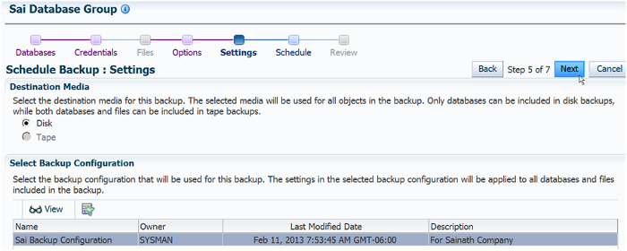

Scheduling Group Backups
From the Database Group menu, select Schedule Backup.
Figure 31: Scheduling a Group Backup
This will allow you to schedule a database backup for the entire group. The following screen appears.
Figure 32: Backup all Databases in Group

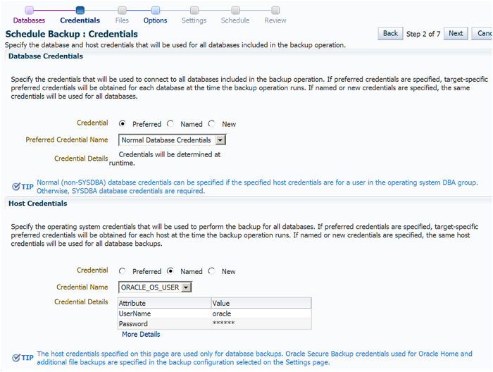

Figure 33: Credentials for Backup
In this step, you need to set up the Database and Host Credentials that will be used for all databases in this group backup operation.
Click Next to continue.
Figure 34: Options for Group
In this step, you can specify if you want a Full or Incremental database backup, Online or Offline, and other options similar to when setting up the backup for a single database.
Click Next.
Figure 35: Settings for Group Backup
On the Settings step, specify if Disk or Tape is to be used for the backup, and select the Backup Configuration that had been created before.
These settings will be applied to all the databases in the backup.
Click Next.

The Review screen now appears. Click Submit to schedule this group backup. The job is submitted and completes successfully, as shown below:
Figure 38: Successful Group Backup
As we can see, the group backup is actually a sophisticated deployment procedure that iterates in parallel through the supplied list of Databases and Oracle Homes.
We can also see that it has backed up the three databases, and that the Archived Logs have been backed up for all databases.
It is possible to select any of the steps and view the step details, as can be seen in the screenshot. The output details for the group backup of the PROD database are reproduced below:
Step: Prebackup (Succeeded)
Checking RMAN repository settings...
Step: Backup (Succeeded)

Step: Post Backup (Succeeded)
You can view the completed group backup jobs by selecting Enterprise > Provisioning and Patching > Procedure Activity from the Enterprise Manager menu.

The brand new Oracle Database 12c (released in June 2013) features a new concept of Container Databases (CDBs) and Pluggable Databases (PDBs). If you are backing up a 12c Database using Enterprise Manager, you can select either the Whole Database, or the Container Database Root, or the Pluggable Databases to be backed up in an RMAN backup when a Customized Backup is being scheduled.
This is on the Schedule Backup page (via Availability > Backup and Recovery > Schedule Backup from the Database target menu in Enterprise Manager), as seen in the screenshot below:
Figure 41: Customized Backup for Oracle Database 12c

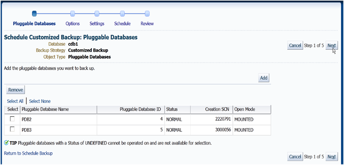

In the next page, we are asked to select the PDBs we want to backup.
We have selected only two of three PDBs to be included in this Customized Backup, as seen in the following screenshot:
Figure 42: Selected two PDBs to be included in Customized Backup of a 12c Database
On the next page, we can decide to perform either a full backup, or an incremental backup of the selected PDBs.
Figure 43: Full or Incremental Backup of the PDBs
The RMAN script generated shows the PDB backup command. This demonstrates how RMAN now understands the concept of CDBs and PDBs, in the case of Oracle Database 12c.
Figure 44: RMAN Script generated for a 12c Database
