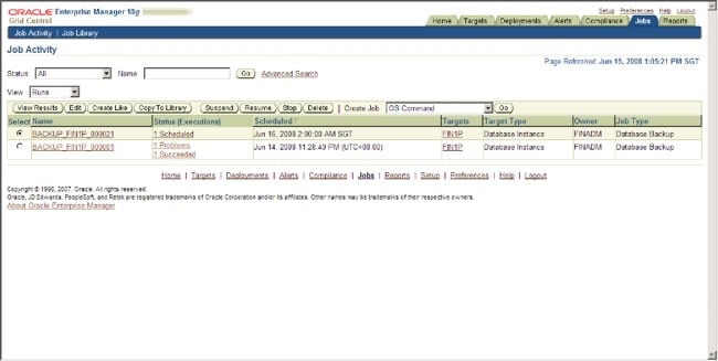

- On the next day, make sure that the scheduled Oracle RMAN backup in the UNIX cron has been started and completed successfully. If not, correct the cron entry.

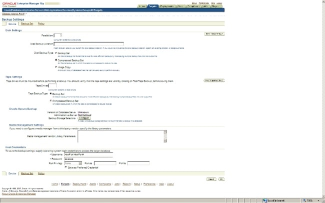

- Backup Settings is now displayed as three tabs: Device, Backup Set, and Policy. Under Device, enter 3 as the Parallelism (concurrent streams to disk drives). This means that three Oracle RMAN channels will be used to actually create the backup pieces. This will increase the speed of the backup, depending on the structure of the disk subsystem.
The Disk Backup Location is not specified, so it uses the flash recovery area set up at the database level for the purpose of the backup. In this case, we presume that the flash recovery area of the database has been set up as /U99 as per the corporate standard.
- The Disk Backup Type has three radio buttons. You can ask for either a Backup Set, a Compressed Backup Set, or an Image Copy. Compressed Oracle RMAN backups were first made available in Oracle Database 10 g. Select this option for the most optimal use of backup space.
- Enter the host credentials on the lower portion of this tab, and check Save as Preferred Credential. For a database based on a UNIX host, use the Oracle UNIX user. For a windows host, use <hostname>\<username> to log on.
The logon credentials in Windows occasionally do not work, even though <hostname>\<username> is used. The solution is to add the Log on as a Batch Job privilege to the user in the Windows Control Panel -> Administrative Tools -> Local Security Policy -> Local policies -> User rights assignment -> Log on as a Batch Job, and add the Windows user that is being used in the host credentials.
Note that the menu path mentioned here pertains to Windows XP Professional and may be slightly different for other Windows versions. This solution is as per Oracle MetaLink Note 109188.1.
- To make sure that the host credentials work correctly, click Test Disk Backup at the upper corner of the screen. This runs a physical backup test using Oracle RMAN and verifies that the actual backup can be physically created at the disk backup location, which is the flash recovery area—/U99 in this case. The backup test runs and, when completed successfully, displays the message Disk Backup Test Successful! at the top of the Backup Settings -> Device tab.
- Move to the Backup Set tab. At this point, nothing is to be changed on this tab, which specifies the maximum backup piece (file) size and certain tape settings such as copies of datafile and archive log backups. These settings are kept at the default.

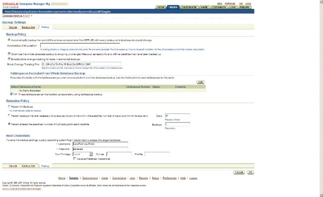

- Move to the Policy tab. This is where the backup policy is specified, and it is particularly important for the control of Oracle RMAN backups.
First check the box to Automatically backup the control file and server parameter file (SPFILE) with every backup and database structural change.
This is the control file and SPFILE autobackup. You can specify the location of the autobackup or default to the flash recovery area /U99. Checking this option is highly recommended so that the control file and SPFILE will be automatically backed up along with every database or archive log backup. This is especially important because we are using the nocatalog mode of Oracle RMAN, so the history of our backups is in the control file. This is also another reason that the binary SPFILE is recommended for every database instead of the earlier text PFILE, because the SPFILE can easily be backed up by Oracle RMAN in this way.
Check Optimize the whole database backup by skipping unchanged files such as read-only and offline datafiles that have been backed up.This is known as backup optimization.
Check Enable block change tracking for faster incremental backups. This is a new feature inOracle RMAN 10g that keeps track of all changed blocks in a small file (approximately 11MB) so that incremental backups do not need to scan the whole database for block changes, as was the case in Oracle9i Database. This technique results in a much faster incremental backup, making a compelling reason to upgrade to the latest versions of the database.
For the block change tracking file, specify the location and filename as D:\ORADATA\FIN1P\BLKCHGTRCK.DBF. This must be specified because the database area is not set for the FIN1P database.
Under Retention Policy, select Retain at least the specified number of full backups for each datafileand specify 1 as the number of backups to retain. This means that the retention policy is based on redundancy instead of a recovery window.
The redundancy is specified in terms of the number of backups to keep at any one time. If a new backup is made, then the previous backup is marked as obsolete and can be deleted. The recovery window is specified in terms of the number of days; backups are retained so that recovery is possible up to this many days in the past. For example, if a recovery window of 3 days is specified as the Oracle RMAN retention policy, it means that all backups necessary to recover up to the last three days’ worth of data will be retained. Obviously this setting may need to be changed depending on the size of the database and the free space available in the backup mount point /U99 at any time. The DBA needs to closely monitor this space and change the recovery window if necessary.

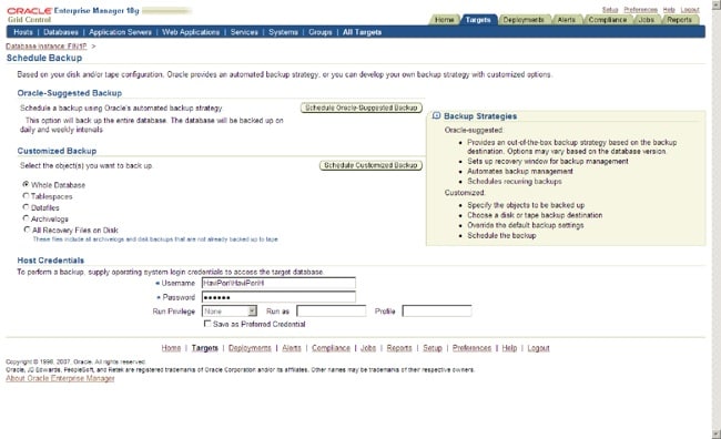

- Now click Schedule Backup on the Maintenance tab of the FIN1P database. Under Customized Backup, select Whole Database and click Schedule Customized Backup.
It is also possible to back up individual tablespaces, datafiles, or only the archive logs when selecting the Customized Backups. Another option is to back up All Recovery Files on Disk; this would back up the flash recovery area itself to tape.
Oracle’s visionary approach is to back up the database to disk—in other words, the flash recovery area—to enable fast disk-based recovery for the client and to minimize business downtime. This is the main purpose of the flash recovery area.
Once a week or at any other interval of time, the disk-based database backup—in other words, the flash recovery area—can be backed up to tape using this option.

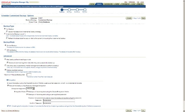

- On the Scheduled Customized Backup: Optionspage, select Full Backup, and Online Backup as the backup mode.
Under Advanced,check the following options:
- Also back up all archived logs on disk
- Delete all archived logs from disk after they are successfully backed up
- Delete obsolete backups
The first two options enable the backup of all archive logs along with the full database backup, and the deletion of the archive logs from disk after they are backed up. The Delete obsolete backups enables the deletion of backups that are marked as obsolete—those backups that are no longer required to satisfy the retention policy.
- Click the Encryption expandable icon at the end of the page. This expands the encryption fields that are new in Oracle RMAN 11g.
To create encrypted backups on-disk with Oracle RMAN, the database must have the Advanced Security database option installed. This is a licensable option; an extra license fee is payable to Oracle in addition to the Enterprise Edition license.
For creating encrypted Oracle RMAN backups directly onto tape, Oracle Secure Backup is known to be the only supported interface. This is another licensable option.
Select Secure the backup using Recovery Manager encryptionand specify a password for the user-supplied password option. Backups will be encrypted using this password. It is also possible to use the Oracle encryption wallet to encrypt the backup, and it is advised to use both encryption approaches for flexibility in using either the wallet or the password when restoring the Oracle RMAN backup.
Note that AES256 has been selected as the encryption algorithm.

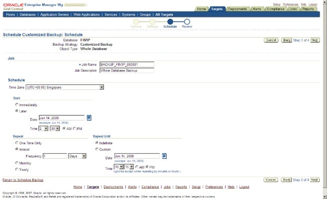

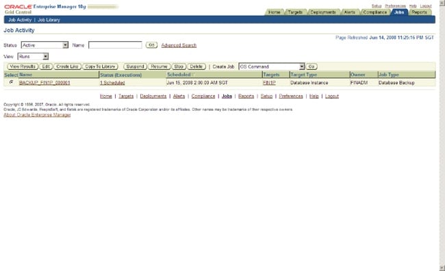

- The Scheduling page appears, where it is possible to enter the time zone of your location, the start date and time of the backup, the repeat frequency, and the end date (or if the schedule is to continue indefinitely).
The default suggested setting is 2 a.m. the following morning. The default is accepted so that the backup will start at this time.
The interval is selected as Frequency 1 Day, because as per the corporate standard a full database backup should be performed each day.
Then select Repeat until Indefinite, so that the schedule is continued indefinitely.

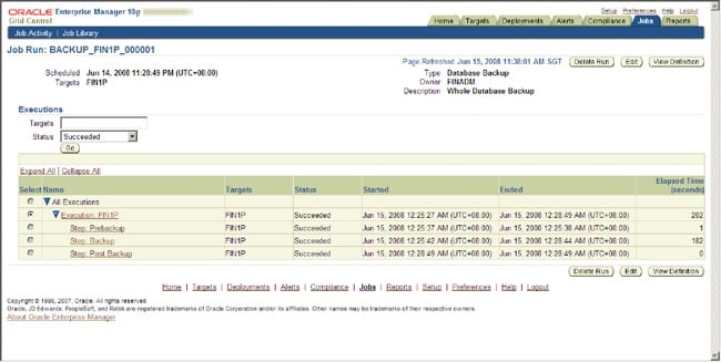

- Click Next. The Review screen now appears, on which the following settings are displayed:

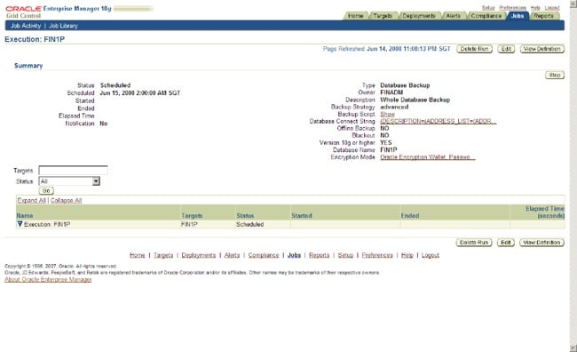

Disk Parallelism 3The Oracle RMAN script is generated by Oracle Grid Control and displayed on the screen:
set encryption on for all tablespaces algorithm 'AES256' identified by '%PASSWORD'; backup device type disk tag '%TAG' database; backup device type disk tag '%TAG' archivelog all not backed up delete all input; allocate channel for maintenance type disk; delete noprompt obsolete device type disk; release channel;These commands perform the actions selected in the Oracle Grid Control screens, such as turning on encryption when performing a full database and archive log backup, deleting archive logs after backup, and then deleting obsolete backups.
It is possible to click Edit RMAN Scriptand modify the script before submitting; however, this prevents a return to the previous screens in this wizard. Nevertheless, the Oracle RMAN script is modified manually as follows—with some extra maintenance commands added to cross-check backups and archive logs and to delete expired backups and archive logs:
set encryption on for all tablespaces algorithm 'aes256' identified by '%password'; backup device type disk tag '%tag' database; backup device type disk tag '%tag' archivelog all not backed up delete all input; allocate channel for maintenance device type disk; crosscheck backup; delete noprompt expired backup; delete noprompt obsolete device type disk; crosscheck archivelog all; delete noprompt expired archivelog all; release channel; - Click Submit Job. Once the job is successfully submitted, click View Job to see its progress. The job now appears under the Jobstab of Oracle Grid Control, under Job Activity, as a Scheduled job.
At this point, it is possible to click Backup Script -> Show to display the backup script used. This shows the Oracle RMAN script wrapped in Perl:

- After setting the Preferred Credentials, click the Jobs tab of the Oracle Grid Control console. This shows the scheduled Oracle RMAN backup job.
- For the purpose of a backup test, change the schedule of the job to make itrun immediately. When this is done and the job is submitted, the job appearswith status Running . Press F5every few seconds to refresh the browser and watch the progress of the job.

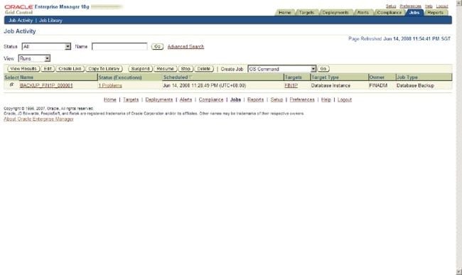

- The job disappears from the JobActivity screen. Change the status to All and click Go.This shows all jobs, including jobs with a problem. The FIN1P backup job appears as a problem.

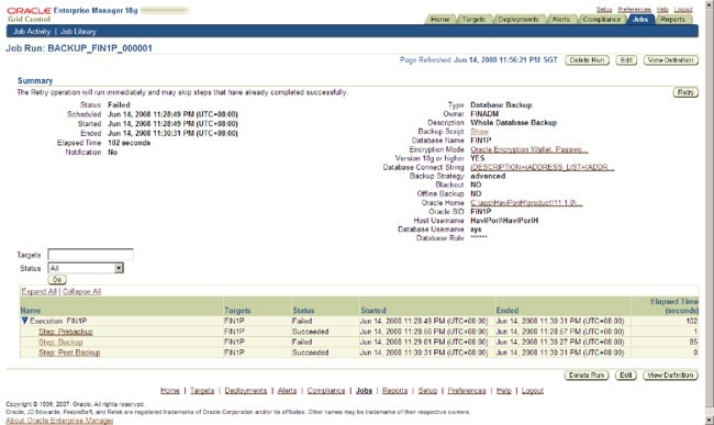

Click the Problem link. The steps of the job appear, showing exactly where the job has had a problem.
The steps for Prebackup and Postbackup appear to have succeeded. The step for Backup appears to have failed. Click this step, and the entire Oracle RMAN output is now displayed. An examination of the output reveals the error immediately.
Output Log Recovery Manager: Release 11.1.0.6.0 - Production on SatJun 14 23:29:03 2008 Copyright (c) 1982, 2007, Oracle. All rights reserved. RMAN> connected to target database: FIN1P (DBID=3660855775) using target database control file instead of recoverycatalog RMAN> echo set on RMAN> set encryption on for all tablespaces algorithm'aes256' identified by *; executing command: SET encryption RMAN> backup device type disk tag '%tag' database; Starting backup at 14-JUN-08 allocated channel: ORA_DISK_1 channel ORA_DISK_1: SID=125 device type=DISK allocated channel: ORA_DISK_2 channel ORA_DISK_2: SID=123 device type=DISK allocated channel: ORA_DISK_3 channel ORA_DISK_3: SID=122 device type=DISK channel ORA_DISK_1: starting compressed full datafilebackup set channel ORA_DISK_1: specifying datafile(s) in backup set input datafile file number=00001name=D:\ORADATA\FIN1P\SYSTEM01.DBF channel ORA_DISK_1: starting piece 1 at 14-JUN-08 channel ORA_DISK_2: starting compressed full datafilebackup set channel ORA_DISK_2: specifying datafile(s) in backup set input datafile file number=00002name=D:\ORADATA\FIN1P\SYSAUX01.DBF input datafile file number=00004name=D:\ORADATA\FIN1P\USERS01.DBF channel ORA_DISK_2: starting piece 1 at 14-JUN-08 channel ORA_DISK_3: starting compressed full datafilebackup set channel ORA_DISK_3: specifying datafile(s) in backup set input datafile file number=00005name=D:\ORADATA\FIN1P\EXAMPLE01.DBF input datafile file number=00003name=D:\ORADATA\FIN1P\UNDOTBS01.DBF channel ORA_DISK_3: starting piece 1 at 14-JUN-08 RMAN-03009: failure of backup command on ORA_DISK_1channel at 06/14/2008 23:29:35 ORA-19914: unable toencrypt backup ORA-28365: wallet isnot open continuing other job steps, job failed will not be re-run RMAN-03009: failure of backupcommand on ORA_DISK_2 channel at 06/14/2008 23:29:35 ORA-19914: unable toencrypt backup ORA-28365: wallet isnot open continuing other job steps, job failed will not be re-run RMAN-00571:================================================= RMAN-00569: ======== ERROR MESSAGE STACK FOLLOWS ========== RMAN-00571:================================================= RMAN-03009: failure of backupcommand on ORA_DISK_3 channel at 06/14/2008 23:29:37 ORA-19914: unable toencrypt backup ORA-28365: wallet isnot openThis error has occurred because the Oracle wallet is not open or has not been created for the database. To create the encryption wallet for the FIN1P database, the following lines are first added to the sqlnet.ora file on the database server:
ENCRYPTION_WALLET_LOCATION= (SOURCE=(METHOD=FILE)(METHOD_DATA= (DIRECTORY=C:\app\HaviPoriH\product\11.1.0\db_1)))The listener for the database is then restarted so that these changes take effect.
To create a new master key and begin using encrypted RMAN backups as well as Transparent Data Encryption (TDE) for the data, issue the following command:
ALTER SYSTEM SET ENCRYPTION KEY IDENTIFIED BY "<pwd>";Click the Retry button on the Job page for the failed job. The backup job now executes again, and this time it completes successfully.
Examine the Oracle RMAN output by clicking the Step Backup link on this screen. This shows that the backup of the database has indeed completed successfully. Observe each step of the output in detail.
The Oracle RMAN output is seen to first set on encryption using the AES256 algorithm. This is followed by creation of a compressed full backup set for the database, and a control file and SPFILE autobackup. After this, the archive logs are backed up as a compressed archive log backup set, and the archive logs are then deleted from disk by Oracle RMAN due to the delete input clause.
Whenever Oracle RMAN wants to perform recovery, it is able to go to the archive log backup sets and extract the archive log it requires. This is one of the great benefits of Oracle RMAN. It contrasts with the manual recovery that DBAs performed in the past, extracting the archive logs from backup archives (UNIX tape archives or “tars”) and placing them where the recovery mechanism of Oracle could find them and use them.
The Oracle RMAN backup pieces for the database and archive logs, and the control file and SPFILE autobackups, are created in their respective directories under the flash recovery area (/U99 in this case):
<Flash Recovery Area>\FIN1P\BACKUPSET\2008_06_15\ <Flash Recovery Area>\FIN1P\AUTOBACKUP\2008_06_15\The creation of the subdirectories for the database name, backup set, autobackup, and the date the backups have taken place are all automatically performed by Oracle due to the fact that the database is using the flash recovery area.
The archive log backup is followed by another control file and SPFILE backup. This happens because autobackup of these important files occurs after any backup, whether it’s a backup of the database or of the archive logs. This is then followed by the maintenance actions. These cross-check the existing backups and archive logs and make sure that they are present on-disk. All expired (not found) and obsolete (as per the retention policy) database, archive log, and control file backup entries are deleted from the control file records. The maintenance commands also ensure that the obsolete database backups and control file autobackups are physically deleted from the disk.

ORA-19914: unable to encrypt backup ORA-28365: wallet is not openThis is resolved by opening the wallet again using the following command:
alter system set wallet open identified by "<pwd>"; - The Oracle RMAN output has been examined in detail, and the backup job has been verified as fully successful. At the Oracle Grid Control console, move to the Jobs tab. Select status All and click Go to find the verified job.
If you edit this job again, you are only able to change the access, not the schedule. So you need to re-create the job using the same steps, but this time use the schedule of the daily early morning run, repeated each day, indefinitely.
When the job is scheduled thus, it appears in the Jobs tab of the Oracle Grid Control console with the status of Scheduled.
When the job is thus set up as a scheduled execution, it runs each day and the Oracle Grid Control repository stores the Oracle RMAN log of each run, whether successful or not. The DBA is able to examine the status of all Oracle RMAN backup jobs for all databases from the central Oracle Grid Control console and can take corrective action if necessary. It is also possible to receive e-mail notifications from Oracle Grid Control on the failure of any scheduled jobs.
