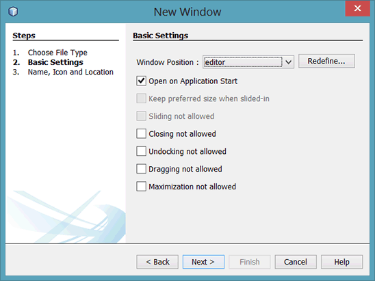

The new module contains a package called todo.view. You now need to create your view. But instead of creating a JFrame form, as you do in the Swing application, you’ll create its RCP equivalent, a TopComponent. If the View module isn't already open, right-click it and select New -> Window.
The dialog box asks you for the window position. The NetBeans IDE has various windows that can be positioned; the Editor window is the main area, Output is the lower area where messages are displayed, and so on. Make the selections shown in Figure 6 and click Next.
rcp-todo-f6
Figure 6
The Class Name Prefix field specifies the name of the frame or panel that will be created along with some other help files. Enter the name Tasks (instead of TasksWindow, as in the original article) and click Finish. (See Figure 7.)

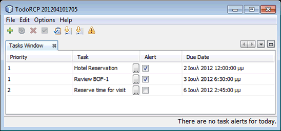

As shown in Figure 1, the task list consists of a menu bar, a toolbar, a table, and a status bar. Apart from the table, which in RCP is called OutlineView, the platform handles all the rest. To add OutlineView, you need to add a dependency to the Explorer & Property Sheet API. Right-click the Libraries folder of the View module and select Add Module Dependency, select Explorer & Property Sheet API, and click OK. Right-click TopComponent in the Design view and change its layout to BorderLayout.

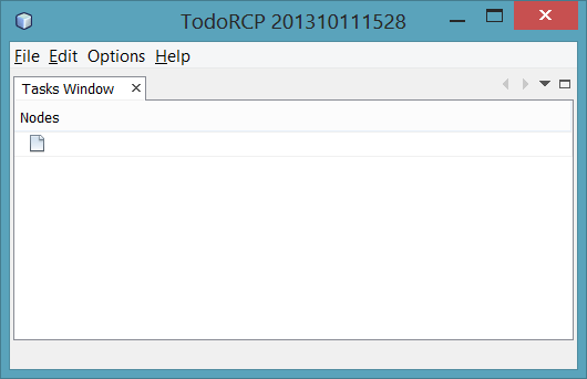

When you run the application, you will see what's shown in Figure 10.
rcp-todo-f10
Figure 10
Look at how many things you get out of the box with NetBeans IDE, which in a normal Swing application you would have to develop yourself: a menu bar and a toolbar (which need customization), a status bar, and a strange tree-table component—and all of these have just one line of code.

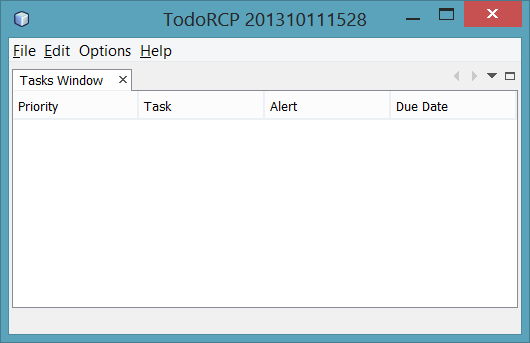

Now you can start building your prototype. If you followed Option 1 earlier, open TasksTopComponent and at the end of the constructor, add the lines of code shown in Listing 2:
OutlineView ov = (OutlineView)outlineView;
//Set the columns of the outline view,
//using the name of the property
//followed by the text to be displayed in the column header:
ov.setPropertyColumns(
       "priority", "Priority",
       "description", "Task",
       "alert", "Alert",
       "dueDate", "Due Date");
//Hide the root node, since we only care about the children:
ov.getOutline().setRootVisible(false);
TableColumnModel columnModel = ov.getOutline().getColumnModel();
ETableColumn column = (ETableColumn) columnModel.getColumn(0);
((ETableColumnModel) columnModel).setColumnHidden(column, true);
Listing 2

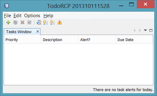

Now create the status bar. To display a StatusBar in NetBeans, a class must implement the StatusLineElementProvider interface and declare it as a service. Right-click the todo.view package and select New -> Java Class. Name it StatusBar and click Finish. Then copy the code shown in Listing 4 and paste it in:
package todo.view;
import java.awt.Component;
import javax.swing.JLabel;
import org.openide.awt.StatusLineElementProvider;
import org.openide.util.lookup.ServiceProvider;
 * The application's status bar.
 * @author jnk
@ServiceProvider(service=StatusLineElementProvider.class, position=1)
public class StatusBar implements StatusLineElementProvider {
    @Override
    public Component getStatusLineElement() {
        return new Jlabel("There are no task alerts for today.");
Listing 4
Don't forget to right-click and select Fix imports. Then right-click and select Format to format the code.
So, what's going on here? As you can see, the StatusLineElementProvider interface is flexible; you can return any component you want—a JLabel, JButton, JPanel, and so on. But of course, the magic thing is the first line, which declares the StatusBar class as a service provider of StatusLineElementProvider.class.
What does this mean? Well, this is where lookups come in. In short, this line adds your class to the application's default lookup, which NetBeans IDE then searches for StatusLineElementProvider.class, and then it adds all the providers it finds to the status bar.
Now it's time to create the toolbars. A toolbar contains actions, so you'll create the actions and insert them into the appropriate toolbars in the central registry. You'll need the icons from the original to-do application, so if you haven't done so, download the zip file and unzip it on your disk.

Also, make sure that you use the Options toolbar and menu (see Figure 17) for the actions that belong to them, that is, Show completed tasks, Sort by priority, Sort by due date, and Show Alerts.
The static visual prototype should look similar to Figure 18. If the order of the toolbars isn't correct, you can modify it either by right-clicking XML Layer and selecting Open or by right-clicking the Toolbars node and selecting Go to Declaration. The layer.xml file opens and you can locate the toolbars and change their Position attribute (a smaller value means that the toolbar is displayed first).
rcp-todo-f17
Figure 17
rcp-todo-f18
Figure 18

OutlineView is populated with mock data, as shown in the method createKeys() in Listing 12. NetBeans IDE prompts you to create two new constructors in Task. Finally, TasksTopComponent needs to be modified, as shown in Listing 13.
public final class TasksTopComponent extends TopComponent implements
ExplorerManager.Provider {
 private final ExplorerManager em = new ExplorerManager();
    public TasksTopComponent() {
      em.setRootContext(new AbstractNode(Children.create(new TaskChildFactory(), true)));
  // asynchronously
    @Override
    public ExplorerManager getExplorerManager() {
        return em;
Listing 13
ExplorerManager, which is the controller of the explorer views, needs a root node element. Pass it an AbstractNode; its Children are derived from the TaskChildFactory.
With many fewer lines of code than in the original Swing to-do application, you now have a running prototype with populated data. Build and run it to see a view similar to that shown in Figure 21:

To customize the outline view so that it displays a collection of Task objects, change the background color of each row according to the task status: red for late tasks, yellow for tasks with an alert set, blue for completed tasks, and white otherwise.
TasksTopComponent needs to be modified as shown in Listing 15:

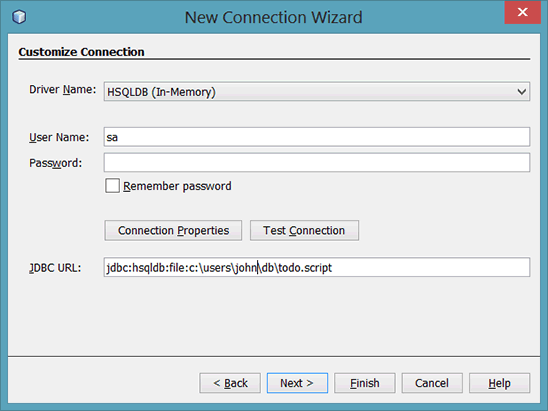

Inspecting the Database
When developing and debugging persistence code, developers usually need a way to tap into the database. Maybe they need to check the effect of an update or change some table definition. NetBeans IDE provides direct support for browsing any JDBC-compliant database and submitting SQL commands.
To connect to the database, switch to the Services tab or open it from the Window menu. Expand the Databases category and then expand the Drivers category. Open the Drivers folder. If the HSQLDB driver isn't there, right-click Drivers, select New Driver, and add the location of the hsqldb.jar archive. NetBeans IDE often sets the database driver class name by itself.
Now right-click the HSQLDB driver icon, and choose the Connect using menu item. Provide the parameters to connect to your local RCP to-do application's database, using the Figure 23 as a template.
rcp-todo-f23
Figure 23
The default database location is db/todo under the {user.home} folder, which is usually /home/<user> under Linux or C:\Users\<UserName> under Windows. Then you can open the connection and browse the database catalog for tables, indexes, and other database objects. Each item has a context menu for operations such as creating new tables, altering columns, and viewing data. Most operations have easy-to-use wizards.

A last thing to mention: you might notice that the Tasks window tab contains an x button, which you can click to close this window without any way to bring the window back. To disable this x button, add the following lines in the TasksTopCompnent constructor:
	putClientProperty(TopComponent.PROP_CLOSING_DISABLED, Boolean.TRUE);
    putClientProperty(TopComponent.PROP_UNDOCKING_DISABLED, Boolean.TRUE);
