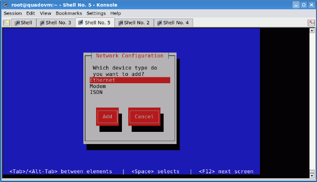

    11. Now you will have to decide which Ethernet interface will be used as the management interface. In our case it is "eth0" (first detected Ethernet PCI network card). After selecting the network card you will have to setup the right IP address:
      1. Select only "Enable IPv4 support" and "Activate on boot" options.
      2. Configure IP address by entering it into "IPv4" field, in this scenario it was "10.99.1.2". Don't forget to put right prefix/netmask (eg. "24" for "255.255.255.0")
      3. Accept configuration by clicking OK.
      4. You will be asked for IPv4 gateway and DNS name servers, e.g. "10.99.1.1".
      5. In the Hostname Configuration select manual mode and enter some descriptive hostname for this server -- e.g. "quadovm".

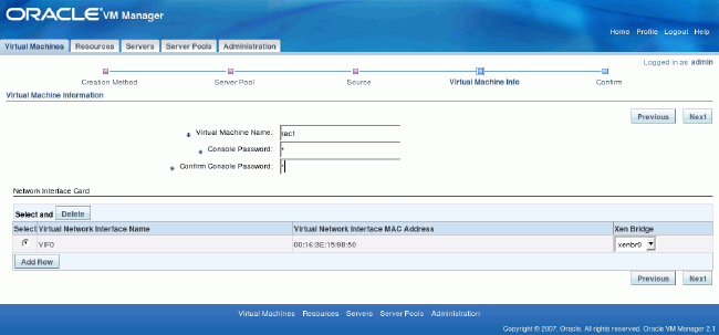

5. Setting up Virtual Machines

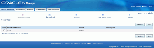

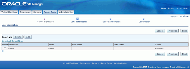

First you must register our Oracle VM Server (quadvm) in Oracle VM Manager as master of the new “spool”, a logical autonomous region that contains one or more physical servers.
Go to Servers Pools tab, then to Create Server Pool, and enter information about the quadvm Oracle VM Server (make it Server Pool Master, Virtual Machine Server, and also Utility Master) also pick an intuitive name for spool, e.g. spool1.
Figure 3
On next screen, select the “admin” user.
Figure 4
Check everything and confirm creation of new spool.
Figure 5
Figure 6

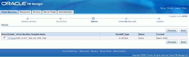

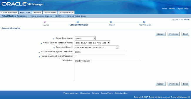

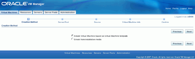

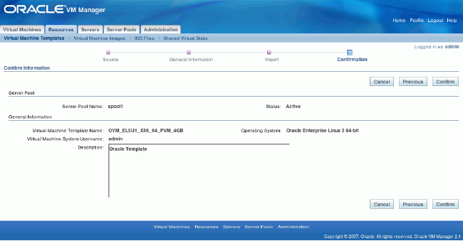

As stated previously, virtualization allows you to clone systems by copying template images. Here's how.
Uploading templates
First you have to transfer your VM template and OpenFiler to your VM Server:
[vnull@xeno OracleVM]$
                                 scp -r  OVM_EL5U1_X86_64_PVM_4GB root@10.99.1.2:/root/
root@10.99.1.2's password:
vm.cfg                                                       100%  318      0.3KB/s   00:00
system.img                                                   100%  6144MB   8.8MB/s   11:41
README                                                       100%  158      0.2KB/s   00:00
[vnull@xeno OracleVM]$ cd ~/ISO
[vnull@xeno ISO]$
                                 scp openfiler-2.2-x86_64.img.gz  root@10.99.1.2:/root
openfiler-2.2-x86_64.img.gz                                  100%   175MB  10.9MB/s   00:16
[vnull@xeno ISO]$
Then you have to move the VM template to its special directory where it can be later auto-detected by VM Server subagent:

Describe template details (template name OVM_EL5U1_X86_64_PVM_4GB should be autodected if it is not, please logout and login again):
Figure 8
Confirm import action:
Figure 9
Template should be visible, now just select it and click on the Approve button.
Figure 10
Creating RAC VMs Based on OEL Template
Logout and Login again, go to Virtual Machines -> Create Virtual Machine, select Create Virtual Machine based on Virtual Machine template.
Figure 11
Select your “spool1” server pool.
Figure 12
In the Source tab, select our freshly added template (should be just one).
Figure 13
In the Virtual Machine Info tab, enter the desired VM name (here: rac1), its password, and just one interface.
Figure 14
Double check everything at the summary screen and click Confirm.
Figure 15
At main the Virtual Machines screen your fresh rac1 VM should be visible with state Creating. Oracle VM is now copying the template to the new system.
Figure 16
Repeat this step for “rac2” node. At this stage you should have two Linux systems ready for Oracle RAC installation. Next, you should customize them by reconfiguring for more memory and space for Oracle software installation.

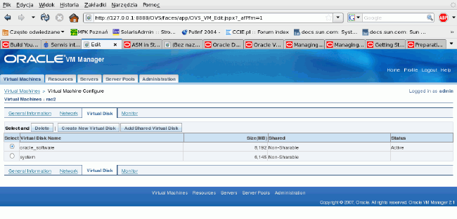

Go to Virtual Machines, click on “rac1” or “rac2”. At General Information go to Edit. Change RAM from 1,024MB to 2,048MB.
Figure 17
Go to Virtual Disk tab, click on Create New Virtual Disk. Here you specify your needed space on additional disk to the system one. Values used:
Virtual Disk Name: oracle_software
Virtual Disk Size (MB): 8,192
After creation the status screen of Virtual Disks should specify that 8GB disk has been created.
Figure 18

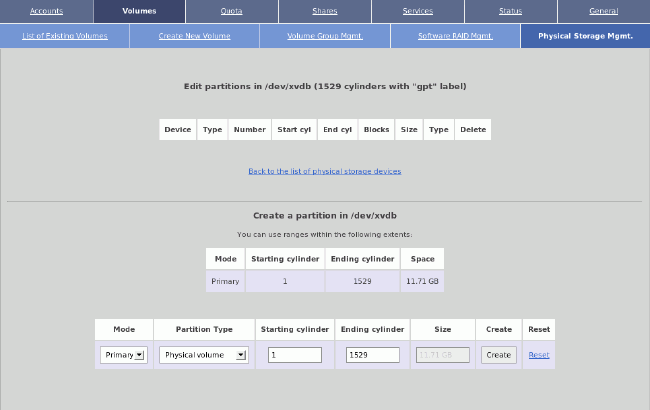

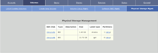

Go to Volumes tab and then Physical Storage Mgmt. then click on /dev/xvdb (second image 12GB datafile you created manually).
Figure 20
Go to Physical Storage Mgmt. and create single big x86 partition with type “Physical volume” (for LVM use).
Figure 21

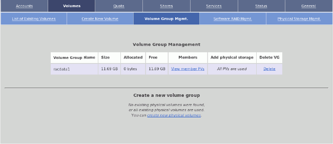

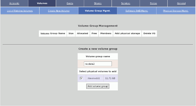

Go again to Volume Group Mgmt. and create volume group named “racdata1” / “racdata2” with only /dev/xvdb1 physical volume (“PV” in LVM's terminology).
Figure 22

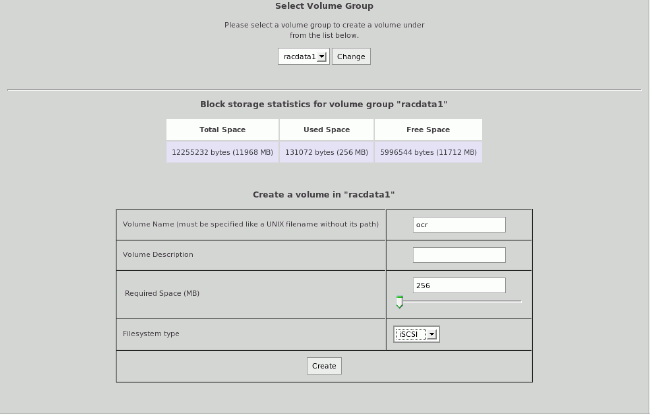

After creating you should be presented with a single volume group. Go to Create New Volumes tab.
Figure 23
You now have to create three iSCSI LUNs:
  • ocr (320MB)
  • voting (320MB)
  • asmdata1 (all free space, ~11GB in my case)
Figure 24
After creating those LUNs you can look at the graph representing your storage allocation volume group named “racdata1” / “racdata2”.

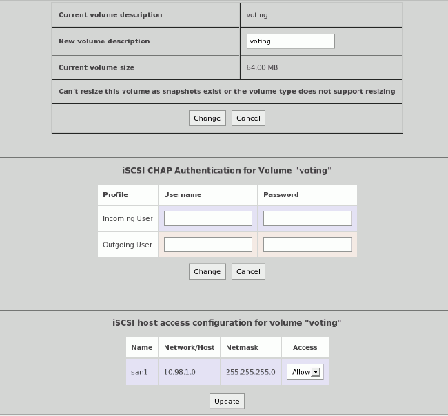

Go to General -> Local Networks, create “san1” under Network Access Configuration to allow iSCSI connection from 10.98.1.0/24 network (our SAN network).
Figure 27
Switch to iSCSI LUNs (Volumes -> List of existing volumes) and edit every iSCSI LUN. Confirm under the section named “iSCSI host access” that this iSCSI LUN should be accessible from the san1 network. Click update to save.
From now on, you have two iSCSI systems exporting LUNs ready for Oracle RAC's use.

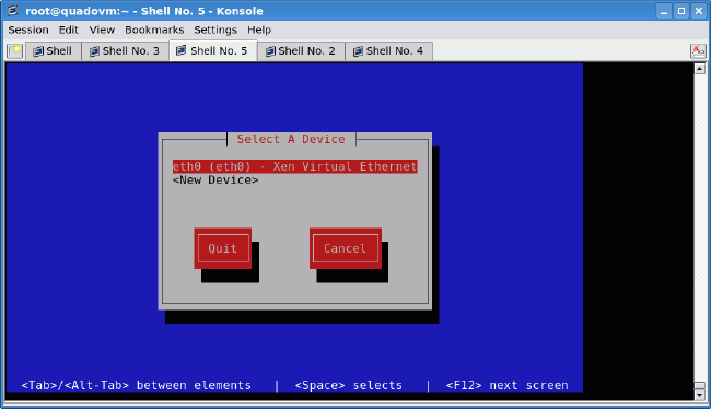

Reconfiguring RAC VMs for Extended RAC
As you don't have more physical Ethernet adapters than eth0, you have to emulate them manually as Oracle VM won't create bridges without physical interfaces. Specifically, you want to add the SAN network for iSCSI traffic and Interconnect network for RAC's Cache Fusion.

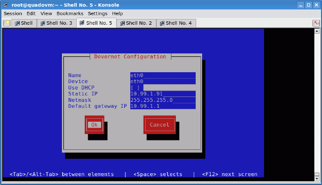

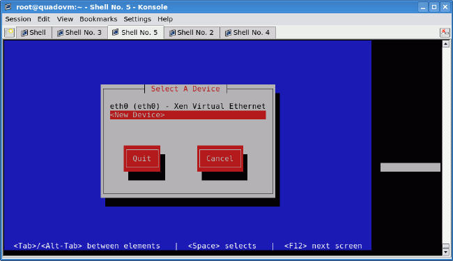

Run the network configuration utility:
[root@localhost ~]#
                                 export TERM=linux
[root@localhost ~]#
                                 system-config-network-tui
Setting up networking using system-config-network-tuiis pretty easy. Configuring public interface (also the management interface with an IP network that is visible from outside of Oracle VM) consists of selecting “eth0” and setting up IP addresses, netmasks, gateways, etc.
Figure 28
Figure 29
After successfully configuring “eth0” you can configure “eth1” (interconnect). Just create a new interface by selecting <New device>, then Ethernet, and then your IP networking. Repeat this step for eth2 (SAN).
Figure 30
Figure 31
Figure 32
After quitting, finish the network configuration (setting up DNS resolver, hostname, and MTU change ):
