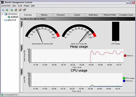

Console
Looking at endless printouts of verbose GC statistics is tedious at best. Fortunately there are better tools for this. The JRockit Management Console can display a graph of the heap usage. With this graph it is easy to see if the heap usage is growing over time.
Figure 1
Figure 1. The JRockit Management Console
The management console can even be configured to send you an email if the heap usage is looking bad (or on a number of other events). This obviously makes watching for memory leaks much easier.
