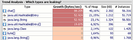

Let's take a deeper look at the tool and how it can be used for tracking down memory leaks. After you know you have a memory leak, the first step is to try to figure out what data you are leaking—what class of objects are causing the leak. The JRockit Memory Leak Detector does this by computing the number of existing objects for each class at every garbage collection. If the number of objects of a certain class increases over time (the "growth rate") you've probably got a leak.
Figure 2
Figure 2. The trend analysis view of the Memory Leak Detector
Because a leak may be just a trickle, the trend analysis must run over a longer period of time. During short periods of time, local increases of some classes may occur that later recede. However, the overhead of this is very small (the largest overhead consists of sending a packet of data from JRockit to the Memory Leak Detector for each garbage collection). The overhead should not be a problem for any system—even one running at full speed in production.
At first the numbers will jump around a lot, but over time they will stabilize and show you which classes are increasing in size.

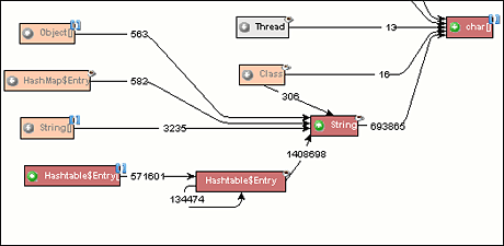

What we want to know is which other objects are holding on to the leaking objects, Strings in this case. Why are the leaking objects still around? Who has references to these objects? But a list of every object that has a reference to a String would be way too large to be of any practical use. To limit the amount of data we can group it by class, so that we see which other classes of objects are holding on to the leaking objects (Strings). For example, it is very common that the Strings are in a Hashtable, in which case we would see Hashtable entry objects holding on to Strings. Working backward from the Hashtable entries we would eventually find Hashtable objects holding on to the entries as well as the Strings (see Figure 3 below).
Figure 3
Figure 3. Sample view of the type graph as seen in the tool

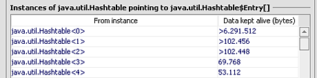

Since we are still looking at classes of objects here, not individual objects, we don't know which Hashtable is leaking. If we could find out how large all the Hashtables in the system are, we could assume that the largest Hashtable is the one that is leaking (since over time it will accumulate enough of a leak to have grown to a fair size). Therefore, a list of all the Hashtable objects, together with how much data they are referencing, will help us pinpoint the exact Hashtable that is responsible for the leak.
Figure 4
Figure 4. Screenshot of the list of Hashtable objects and the size of the data they are holding live

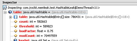

For example, the Hashtable may be referenced from an object of type MyServer in a field called activeSessions. This will often be enough information to dig into the source code to locate the problem.
Figure 7
Figure 7. Inspecting an object and its references to other objects
