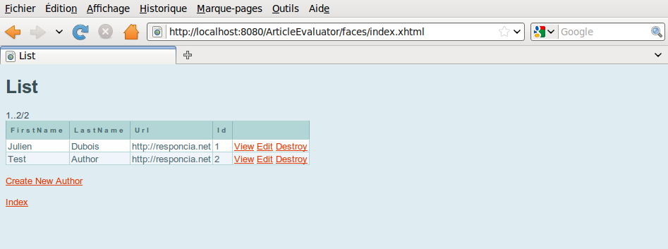

Let's start by creating two authors and then clicking the "list all authors" link. Here is the resulting page:
Note that the URL is http://localhost:8080/ArticleEvaluator/faces/jsf/author/Create.xhtml.
You can also see the same page if you click the "list all authors" link from the first page:
The problem is that the URL on this page is http://localhost:8080/ArticleEvaluator/faces/index.xhtml.
As you can see, while our application is perfectly correct from an end-user point of view, its URLs do not represent the entities that are being worked on. Indeed, for finding all authors in a REST way, we would have issued a GET request on the http://localhost:8080/ArticleEvaluator/resources/authors URL.

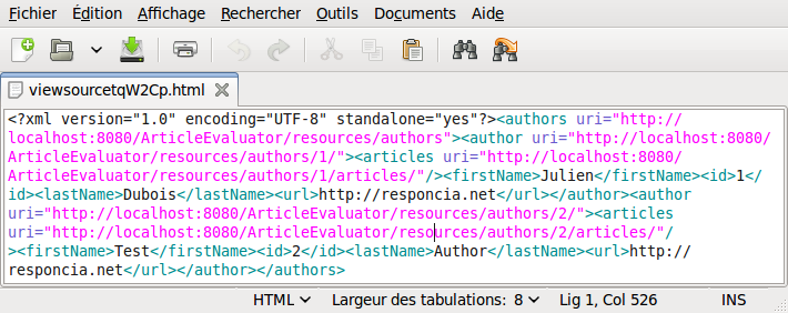

The three resources Author, Article, and Vote are now available through a REST interface. If you look at the classes in the resources package, you can see how the URLs are constructed as well as the type of representations that are available for those resources: application/xml and application/json.
Because we already created two authors in the previous section, test the URL http://localhost:8080/ArticleEvaluator/resources/authors. A Web browser asks for an XML or HTML representation of a resource; that's why the application sends back the application/xml representation of the AuthorsResource:
As you can see from this XML code, it is possible to browse through the different AuthorResource instances by using the URLs that are provided. For example, using the http://localhost:8080/ArticleEvaluator/resources/authors/1/ URL, you can find the first author as well as the list of articles he has written.
