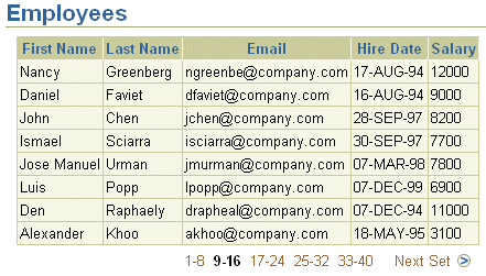

  • Figure 3 shows a report with eight rows per page, the pagination style used in this example is called "row ranges with set pagination", clicking on "next set" takes you to the next set of row ranges, in this example you would see rows starting at row 41.
  • Fig. 3: Report with 8 rows per page

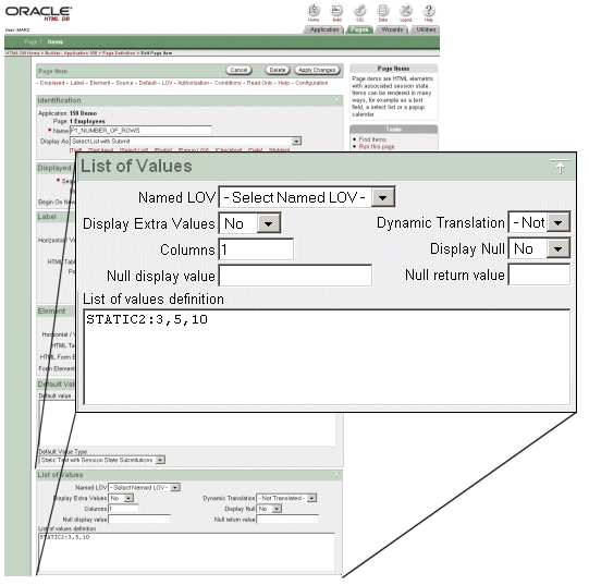

    • For your select list item, you need to define a list of values from which the user can pick a new number of rows value. You can define
    • In this example we will use a static list of values with the values 3, 5 and 10 (see Fig. 6), to use a static LOV, prefix your list of values with STATIC: or STATIC2:. You could also query a table or pick a pre-defined LOV from the Named LOV select list
    • Fig. 6: Page Item, List of Values
