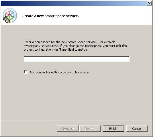

Open Visual Studio and select File > New > Project. From Visual C# (or Visual Basic), Templates, click Smart Space Service. If you wish, you may modify the service name, the location and the solution name. Click OK. Enter a namespace and click Finish.
Tip: If you change the namespace later, you must edit the type field in the configuration.xml file to match.
