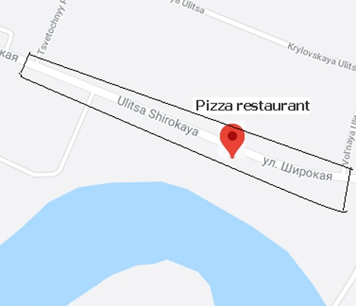

In Figure 1, you saw how an area of interest can be marked on a map. But how can you transfer this information to the database? To be more specific, how can the area enclosed by a polygon on a map be represented as a row in a database table, so you can use SQL to check whether a certain location is within this area?
In the context of this article, a location is a geographical reference defined by a pair of coordinates: longitude and latitude.
In a nutshell, to store information about a spatial object (like a polygon area) in an Oracle database, you’ll need a table with a column of type SDO_GEOMETRY. This type is specifically designed to store the spatial attributes of an object. In this same table, you may also need to define columns of common types, such as VARCHAR2 and NUMBER, to hold nonspatial attributes of spatial objects.
An example of such a table is Places, which you should have created in your database after the execution of the db_setup.py script. The Places table uses the shape column of type SDO_GEOMETRY to store the polygon’s coordinates that define an area on a map. The Places table also has other columns—such as name, address, and place_id—for storing nonspatial attributes of the area.
So, by inserting a row in the Places table, you create an object in the database, which represents a polygon area. You can do it right now by executing the insert_area.py script included with this article. The code found in this script is provided below with explanatory comments.

In the line below, you invoke the above function to construct a Python object to be used as a bind variable in the insert statement. This example uses coordinates (fake ones) that describe a quadrilateral similar to the one shown in Figure 1.
pizzaRestaurantCoords = CreateGeometryPolygon(46.080453, 39.994143, 46.079943, 39.994057, 46.077989, 40.000344, 46.078774, 40.001288, 46.080453, 39.994143)
