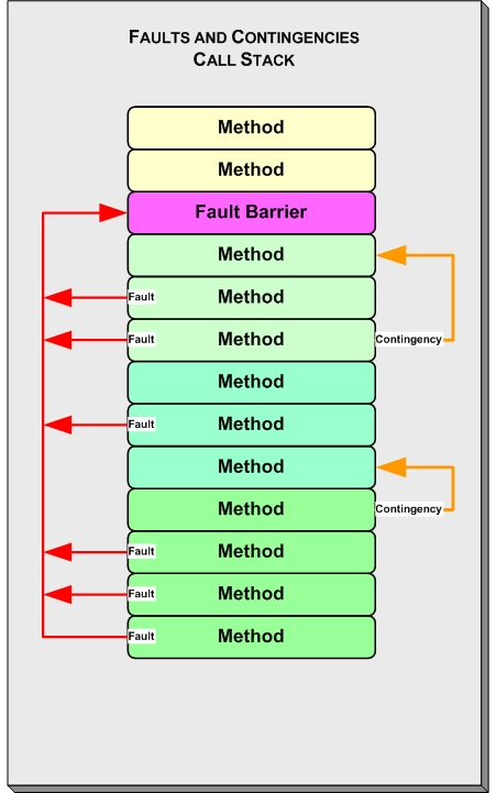

Establish a fault barrier
Deciding which exception to throw and when to throw it are important decisions for your fault-handling framework. Just as important are the questions of when to catch a fault exception and what to do afterward. The goal here is to free the functional portions of your application from the responsibility of processing faults. Separation of concerns is generally a good thing, and a central facility responsible for dealing with faults will pay benefits down the road.
In the fault barrier pattern, any application component can throw a fault exception, but only the component acting as the "fault barrier" catches them. Adopting this pattern eliminates much of the intricate code that developers insert locally to deal with faults. The fault barrier resides logically toward the top of the call stack where it stops the upward propagation of an exception before default action is triggered. Default action means different things depending on the application type. For a stand-alone Java application, it means that the active thread is terminated. For a Web application hosted by an application server, it means that the application server sends an unfriendly (and embarrassing) response to the browser.
The first responsibility of a fault barrier component is to record the information contained in the fault exception for future action. An application log is by far the best place to do this. The exception's chained messages, stack traces, and so on, are all valuable pieces of information for diagnosticians. The worst place to send fault information is across the user interface. Involving the client of your application in your debugging process is hardly ever good for you or your client. If you are really tempted to paint the user interface with diagnostic information, it probably means that your logging strategy needs improvement.
The next responsibility of a fault barrier is to close out the operation in a controlled manner. What that means is up to your application design but usually involves generating a generic response to a client that may be waiting for one. If your application is a Web service, it means building a SOAP
<fault> element into the response with a
<faultcode> of
soap:Server and a generic
<faultstring> failure message. If your application communicates with a Web browser, the barrier would arrange to send a generic HTML response indicating that the request could not be processed.

Figure 2. Contingency and fault exceptions

When your architecture includes a fault barrier and developers are made aware of it, the temptation to write one-off fault exception handling code decreases dramatically. The result is cleaner and more maintainable code throughout your application.
