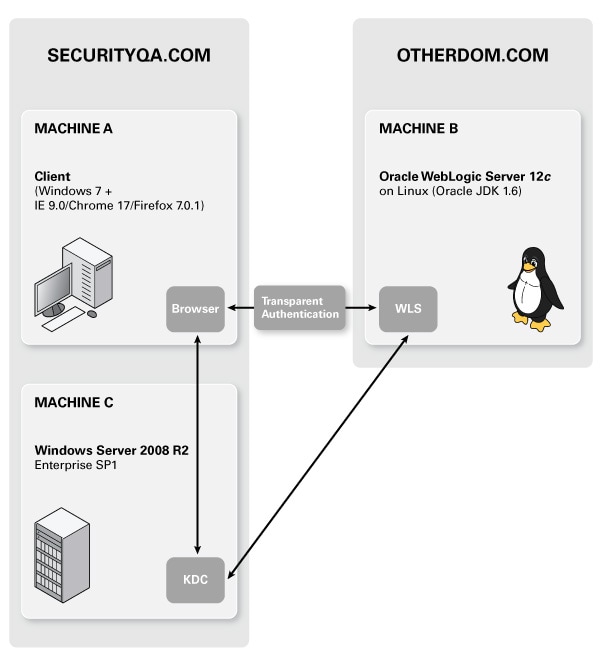

Following configuration is used to demonstrate this scenario:
  • Browser Client (MACHINEA): Windows 7 Enterprise (IE 9.0/Firefox 7.0.1/Chrome 17 installed)
  • Oracle WebLogic Server (MACHINEB) – Linux version 2.6.18-238.0.0.0.1.el5xen with Oracle WebLogic Server 12c (Oracle JDK 1.6) installed.
  • KDC (MACHINEC) - Windows Server 2008 R2 Enterprise SP1
Note that although above configuration is used for this scenario, SPNEGO should work for older versions of browsers, Oracle WebLogic Server, JDK, and so on.
Figure 1: Machine Configuration for SPNEGO/Kerberos scenario
The following list of steps are a detailed breakdown of the cross-platform authentication design shown above.
  • When the logged-on user (MACHINEA) requests a resource from Oracle WebLogic Server (MACHINEB), it sends the initial HTTP GET verb.
  • Oracle WebLogic Server (MACHINEB), running the SPNEGO Token Handler code, requires authentication and issues a 401 Access Denied, WWW-Authenticate: Negotiate response.
  • The client (Browser on MACHINEA) then requests the session ticket from the TGS/KDC (MACHINEC).
  • The TGS/KDC (MACHINEC) supplies the client with the necessary Kerberos Ticket (assuming the client is authorized) wrapped in a SPNEGO Token.
  • The client re-sends the HTTP GET request + the Negotiate SPNEGO Token in an Authorization: Negotiate base64(token) header.
  • Oracle WebLogic Server's SPNEGO Token Handler code accepts and processes the token through GSS API, authenticates the user and responds with the requested URL.

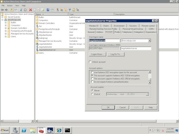

Create a User “negotiatetestserver” in Active Directory for Your Oracle WebLogic Server instance
Figure 2: Account tab showing properties for “negotiatetestserver” user on KDC
  • Launch Programs/Administrative Tools/Active Directory Users and Computers tool.
  • Right click on theUsersnode and selectNew/User. (Do not selectMachine.)
  • Type in the user “negotiatetestserver” in the "Full Name" field and in the "Logon Name" field.
  • ClickNext, and enter a password (and of course, memorize it)
  • Verify that none of the password options are checked. ClickNext.
  • ClickFinish.
Configure Your User to Comply with the Kerberos Protocol
  • Locate your newly created user in the Users tree in the left hand pane and double click it.
  • On the "Account" tab for user “negotiatestserver”,
  • For AES128-SHA1 cipher strength, make sure This account supports AES 128 bit encryption is checked; all others (except password never expires) are unchecked.
  • For AES256-SHA1 cipher strength, make sure This account supports AES 256 bit encryption is checked; all others (except password never expires) are unchecked.
  • For RC4-HMAC-NT cipher strength, make sure all options (except password never expires) are unchecked.
  • For DES-CBC-CRC cipher strength, make sure Use Kerberos DES encryption types for this account and make sure all options (except password never expires) are unchecked.
  • Click OK.

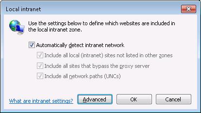

  • Select Local intranet and click Sites.
  • In the Local intranet popup, ensure that the Include all sites that bypass the proxy server and Include all local (intranet) sites not listed in other zones options are checked.
  • Click Advanced.
  • In the Local intranet (Advanced) dialog box, add all relative domain names that will be used for Oracle WebLogic Server instances participating in the SSO configuration (for example, myhost.example.com) and click OK.

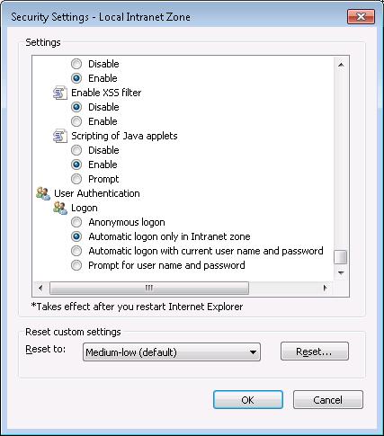

Figure 5: Configure Intranet Authentication
  • Select Tools > Internet Options.
  • Select the Security tab.
  • Select Local intranet and click Custom Level... .
  • In the Security Settings dialog box, scroll to the User Authentication section.
  • Select Automatic logon only in Intranet zone. This option prevents users from having to re-enter logon credentials, which is a key piece to this solution.
  • Click OK.

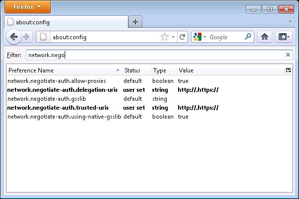

Configuring Mozilla Firefox Browser
To configure a Firefox browser to use Windows Integrated authentication, complete the following steps:
  • Start Firefox.
  • Enter about:config in the Location Bar.
  • Enter the filter string network.negotiate.
  • Set the preferences as shown in Figure below:
python-nopool-gif
Figure 6: Preferences Required in Firefox for Windows Integrated Authentication

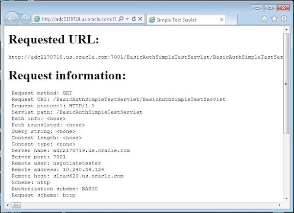

  • Open browser and access url of the web application. In this case, we are accessing a servlet which provides basic HTTP header information:
python-nopool-gif
Figure 8: Servlet displaying HTTP info after SPNEGO authentication

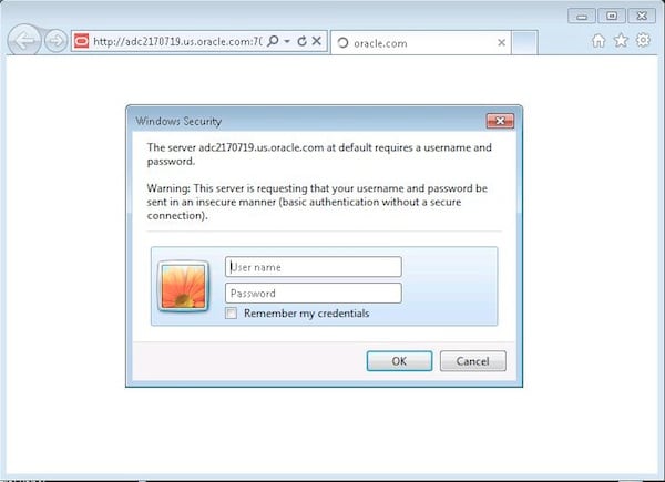

  • If the SSO was unsuccessful you will be prompted for username/password by the browser. In this case you need to check wls server logs for exception (Check Troubleshooting section below).
python-nopool-gif
Figure 9: Browser prompting for username/password after SPNEGO failure
