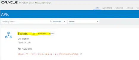

Once logged in, look for the Tickets API (the one we created in the previous article):
Figure 2
Click on it and you will be redirected to the API configuration:
Figure 3

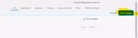

Publish to Portal will be disabled. To enable it, simply click the Save Changes button at the top right of the screen.
Figure 9

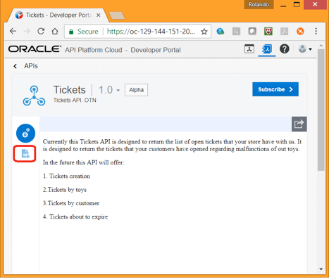

Now let's write a brief description of our API in the Developer Portal API Overview (Figure 11).
Figure 11
Whatever we write/document here will appear in the Developer Portal as the description for our API. You must write something appealing in order to get the attention of possible users. Simply click on the HTML/Markdown button (Figure 12).
Figure 12
The following options for the overview will appear (Figure 13):
Figure 13

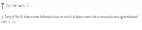

Let's use the Text tab to write a very simple HTML for our overview. Simply copy and paste the following html into the Text tab (Figure 14).
 <p>Currently this Tickets API is designed to return the list of open tickets
that your store has with us. It is designed to return the tickets that
your customers have opened regarding malfunctions of our toys.</p>
 <p>In the future this API will offer:</p>
 <p>1. Tickets creation</p>
 <p>2.Tickets by toys</p>
   <p>3.Tickets by customer</p>
 <p>4. Tickets about to expire</p>
Figure 14
Click the OK button and you will see:

We have finalized the configuration to publish the API on the API Portal. Simply click the Save Changes button at the top right of the screen:
Figure 23

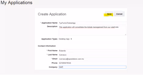

Click New Application, then fill in the information (Figure 27):
Figure 27
Click Save.

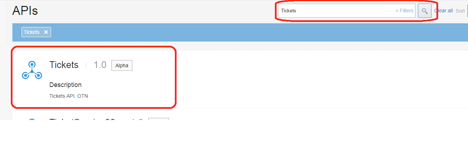

Use the search text box to find the Tickets API (Figure 29):
Figure 29
Click on Tickets. The API information is displayed (Figure 30).
Figure 30
Note that the description we entered earlier now appears.
Click the Documentation button, as indicated in Figure 31:
Figure 31
The API documentation created in the previous article opens in Oracle Apiary (Figure 32).

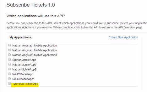

Now simply click on the blue Subscribe button in the upper right (as seen in Figure 31).
You will see the following:
Figure 33
Select the application that we created earlier (TysForUsTicketsApp). After checking the box, you will see the following at the right side of the screen:
Figure 34
Click on Subscribe API button. You will return to the documentation screen, but now you will see this:

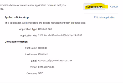

Click on the TysForUsTicketsApp link (highlighted in yellow in Figure 35).
Figure 36
The API Key that the application needs to use the Tickets API is displayed. You can also manage grants for users (Figure 37):
Figure 37
