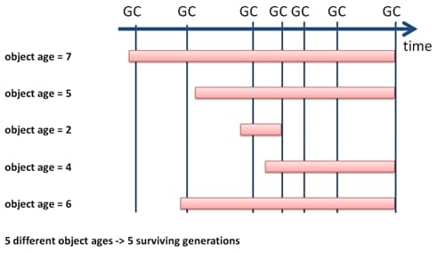

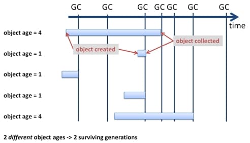

The lifetime of the objects (illustrated as horizontal bars) plotted over time, might appear as shown in the following diagram.
The diagram shows a pretty low number of surviving generations.
In the case of a memory leak this will be different. Objects are still created at various times, however, they keep living (due to a coding error) and are never collected.
So for the same number of objects, the number of different object ages (the surviving generations metric) is much higher.

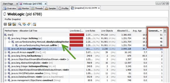

VisualVM can be used to profile memory and calculate the surviving generations metric for all classes. In the screenshot below you can see the surviving generations displayed while profiling the memory usage of an application.
The surviving generations metric is shown on the right, the call tree of a method with a rather high surviving generations metric is shown on the left.

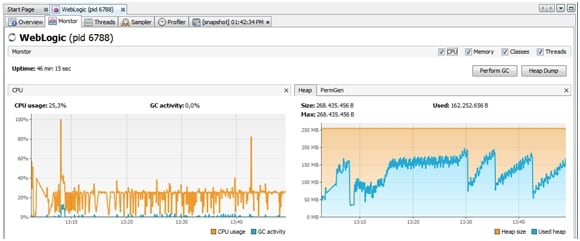

While the code was running, CPU and heap appeared as illustrated in the diagram below. The small memory leak in the code cannot be seen in the heap diagram.
