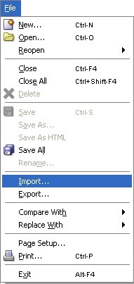

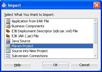

- Select File | Import from the JDeveloper Menu.

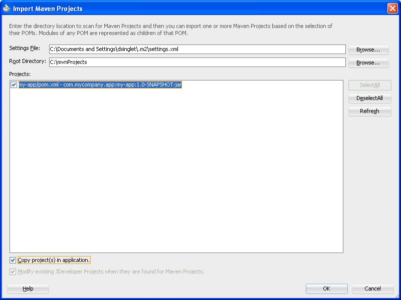

- Select what you want to import. In this case "Maven Project".
- Provide a the Root Directory for your Maven Projects, select the project(s) you want to import, and select the checkbox Copy project(s) in application. Select OK.

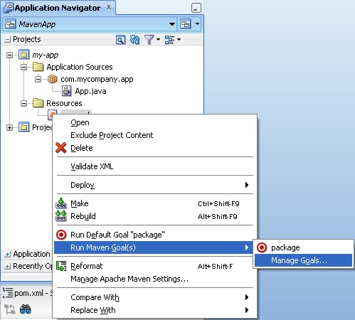

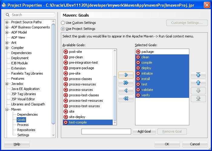

- Right select the pom.xml file and select "Manage Goals". Notice that you can also Manage Apache Maven Settings which you can also do from Project Properties as illustrated below.
- Shuttle additional Goals from Available to Selected so that the options are available from context upon choosing to run goals when right-selecting on the pom.xml and seleting the goal of your choice from context.

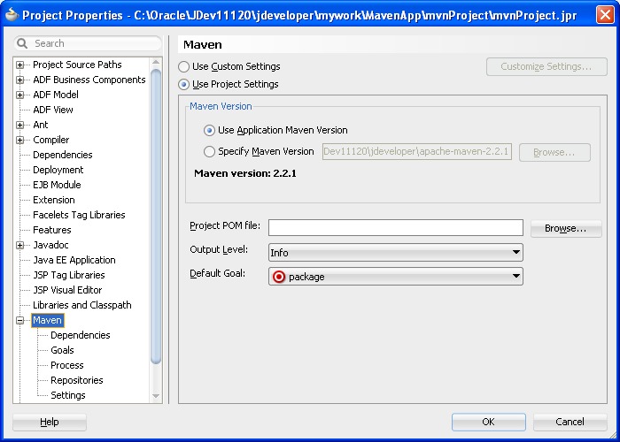

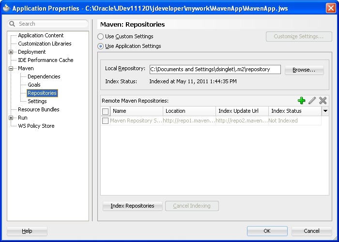

- Optional Maven Configuration.
- Here you can Customize your Maven Setting, Specify your Maven Version, Add Proxy to Settings if you're behind a firewall and more.

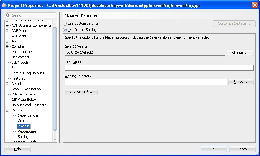

- Here you can customize the Maven Process as needed. Add Java Options, change the Java SE Version, specify the Working Directory and more.

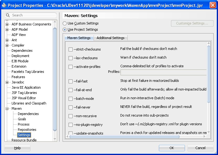

- Here you can specify additional Maven Settings and customize as needed. Review the available options.

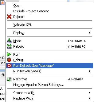

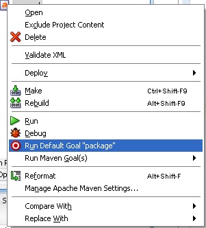

- Right select the pom.xml and select Run Goal(s) from context. Choose the goal that you would like to run. For detailed information on the various goals please refer to the Apache Maven Build Lifecycle Page.

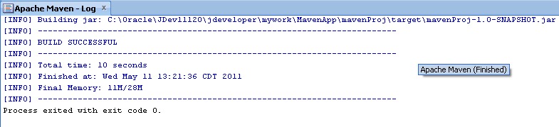

- Run the package goal to take the compiled code and package it in its distributable format, sucha as a JAR.

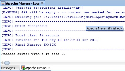

- Ensure the build is successful as illustrated below.

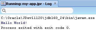

- Run the application.

Import.
Select "Maven Project".
Select Maven Project(s) to import.

Manage Goals.
Maven: Goals.
Maven Project Properties.
Maven: Process.
Maven: Settings.
Run the Goal of your choice.
Run the package goal.
Review the package goal completed successfully.

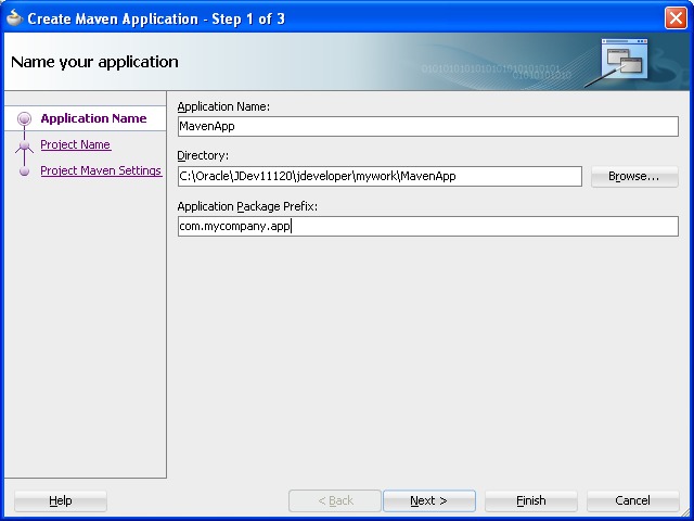

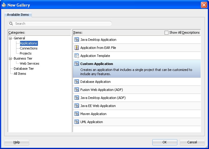

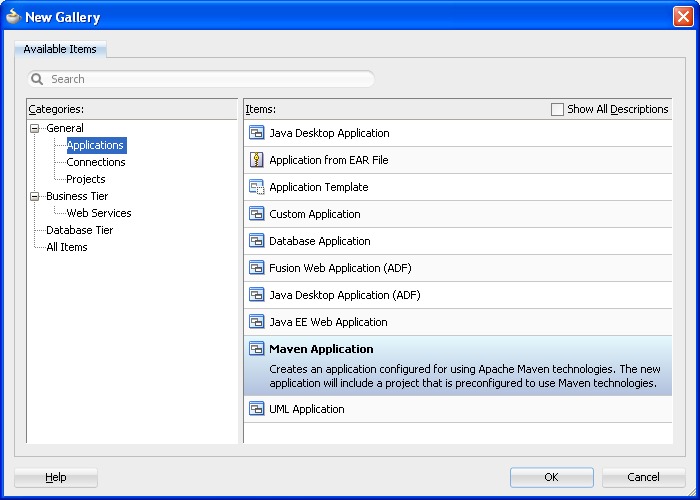

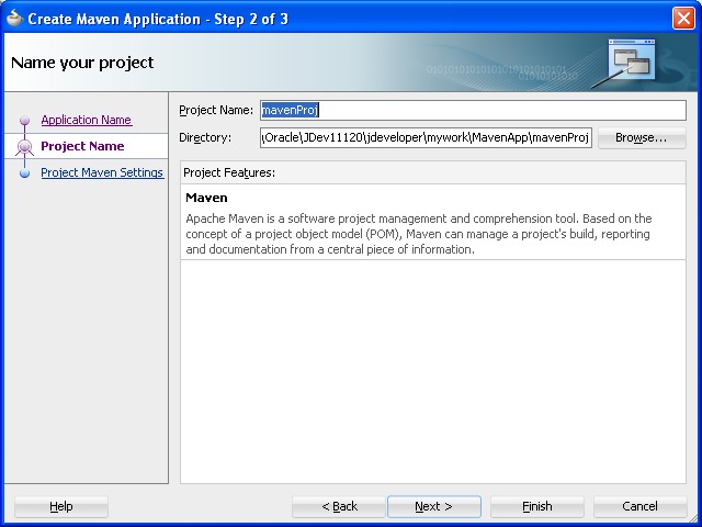

The first thing to do is to create a new application workspace in JDeveloper. Here are the steps:
- Create a new application workspace either from the File menu or Application Navigator within JDeveloper. Provide a name or go with the default.
- Name the Application Workspace appropriately and provide an Application Package Prefix.
- Name the project or go with the defaults. Ensure that the Maven Project Technology is included by default.
- Configure your Maven settings as required.

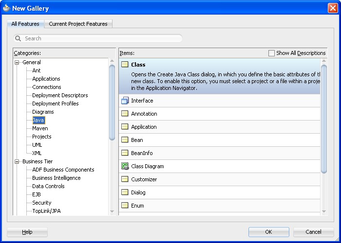

- Create a new java object by right selecting on your project and selecting New from context.
- Select "Java Class" followed by OK.
- Give your java class an appropriate name and select Main Method below if you want a quick method of testing your application.

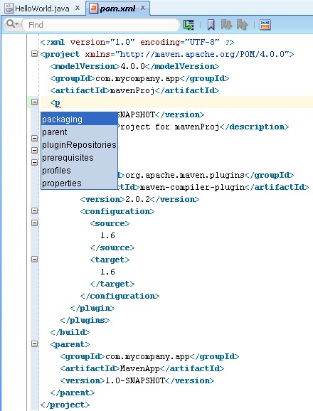

- Open your pom.xml and begin to enter a new tag element such as packaging and you will notice Code Insight is provided on your pom.xml file.
- Review the contents of your pom.xml.
- Configure your Maven Project Properties as illustrated in the previous section. Here I'm adding some Goals in addition to the default one of package. Save your workspace.

- Review the status of running the package goal to ensure that the build was successful.

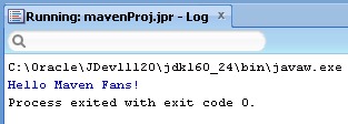

- Run the application and see the results.
Create a new Application workspace and select the Maven Application Template.
Name the Application.
Name the project or go with the default.
Configure Maven settings.

Create a New Java Object.
Name your Java Class.
Code Insight provided on your pom.xml.

Configure Maven Project Properties.
Review status of running the package goal.
Run application.

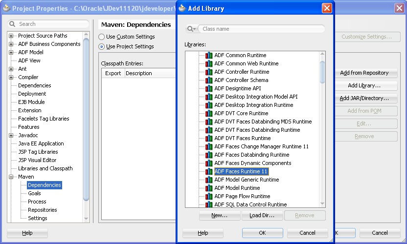

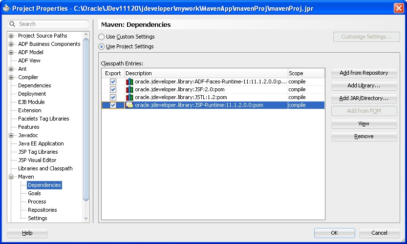

- You select project properties and add libraries to your POM file. In this example, I'll add ADF Faces Runtime 11 libraries. Once you select ok on the Project Properties dialog, you'll notice that the selected libraries are added to you Maven repository such that POM can manage the project.
- Once you select ok on the Project Properties dialog, you'll notice that the selected libraries will be added to your Maven repository such that the POM can manage the project.
- Select the Export checkbox and ok to add the dependency.
- Review the POM file to see that the dependency has been added.

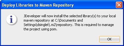

- One last point here before moving on to another feature is that during the creation of a POM for a project, the dependencies from the project jpr will be copied to the POM file as expected..
Add a ADF Faces Runtime 11 libraries.
Add libraries to the Maven repository.
Add the dependency.

</dependency>
</dependencies>
pom.xml.
Notice the alert that the project POM has dependencies that are not listed..
Add POM dependency to Project and review the POM file again to see that the dependency has been added.
Repository Management
Oracle JDeveloper now allows for better management of Maven repositories.- Right select on the Application workspace and select Application Properties.
- Notice you can add additional remote repositories, change the local repository, as well as use custom settings. You can also add Goals, additional Dependencies as well as work with the Maven settings.
- Likewise you can right select on the Project and select Project Properties and have access to additional configuration properties such as the ability to specify the options for the Maven process, including the Java version and environment variables..
Project Properties.

- Create POM.xml for project, application
- Configure, run Maven goals
