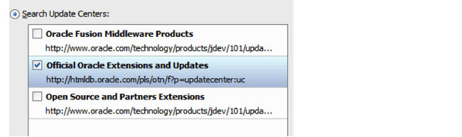

2. Ensure that, at a minimum, you have selected the “Official Oracle Extensions and Updates” update center, and click Next:

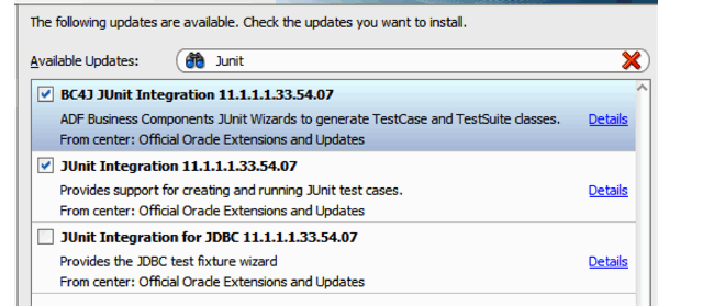

3. Type JUnit in the search box to search for the updates. At a minimum, include the BC4J JUnit Integration and JUnit Integration extensions, and click Next:
Figure 3 Selecting the JUnit Extensions

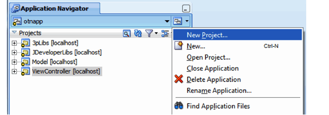

Creating the Unit Test Project
Because keeping unit tests separate from the rest of the application code will make it easier to create deployment artifacts such as EAR files that do not include the unnecessary-for-deployment unit tests, I usually create a separate project to hold the unit tests. Because we are going to create unit tests for our Model (Business Components) project, let us create a new project called “ModelTests” to hold the unit tests. With the otnapp application open in the Oracle JDeveloper IDE, choose New Project from the Application Navigator shortcut menu:
Figure 4 Creating a New Project

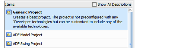

Leave Generic Project selected in the New Gallery dialog box and click OK:
Figure 5 Selecting a Generic Project

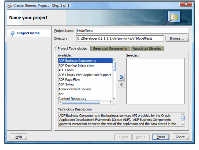

Provide an appropriate name (such as “ModelTests”) for the project and click Finish:
Figure 6 Naming the Tests Project

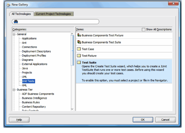

Now that we have a project, we can use the Business Components Test Suite Wizard to set up a basic set of JUnit tests for the Oracle ADF Business Components in our Model project, as well as a JUnit Test Fixture (for setting up the database connection) and a JUnit test suite (for running the generated tests). To do so, right-click the ModelTests project and select New... from the context menu:
Figure 7 Invoking New from the Context Menu

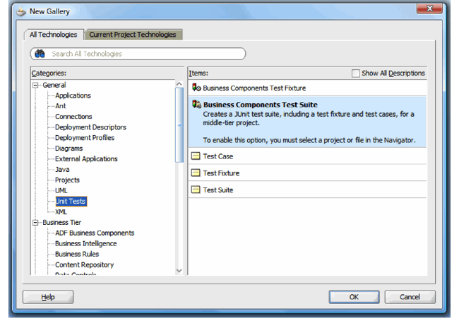

When the New Gallery appears, select the Unit Tests category and Business Components Test Suite item and click OK:
Figure 8 Invoking the Business Components Test Suite Wizard

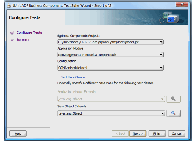

On the first page of the JUnit ADF Business Components Test Suite Wizard, ensure that the Business Components Project (Model.jpr) is selected and that the proper Application Module (OTNAppModule) and Configuration (OTNAppModuleLocal) are selected, and clickFinish:
Figure 9 JUnit ADF Business Components Test Suite Wizard
Once you finish the wizard, Oracle JDeveloper will create the following files in the ModelTests project:

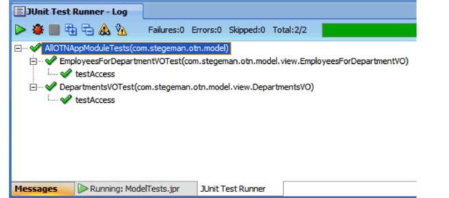

Before we have a look at the code itself, let’s run the generated test cases and see what happens. JUnit uses the concept of a test suite to group tests together, so let’s run the generated test suite using Oracle JDeveloper’s JUnit test runner. To do so, right-click the test suite class (AllOTNAppModuleTests.java) in the Application Navigator and choose Run from the context menu:
Figure 10 Running the Test Suite

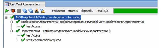

Once the tests run, you will be able to see the results in the JUnit Test Runner – Log window:
Figure 11 Test Suite Results
From this example, you can see that two unit tests were run and that both of them were successful (no failures or errors). Now, let’s have a look at the actual code behind the generated unit tests and add some of our own tests. Double-click the DepartmentsVOTest.java file in the Application Navigator to open the source code for the unit tests of the DepartmentsVO View Object:

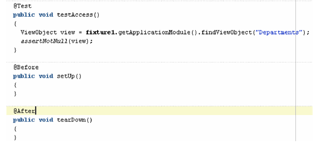

Figure 12 Source Code for DepartmentsVO Unit Tests
The first thing you will notice is the use of Java 5 annotations in the code; these annotations are used to indicate to JUnit which methods are unit tests (with the @Test annotation) and which methods are run @Before or @After each unit test in the class. Unlike in previous versions of JUnit, the methods do not have to follow a specific naming convention for @Test, @Before, or @After methods. One thing to note is that JUnit does not guarantee the order of calling the @Before methods, the @Test methods, or the @After methods; the only guarantee is that all @Before methods are called before each @Test method, and all @After methods are called after each @Test method.
The Oracle JDeveloper –generated test class has one test method called testAccess that attempts to get a View Object instance from an application module (the application module was created by a test fixture— more on that later) and uses a JUnit assertion to ensure that the obtained View Object is not null. This is a common pattern for a unit test within JUnit: perform a test and then use one of the assert methods to verify the result. If the assertion is not true, then JUnit will flag the particular unit test as failed.

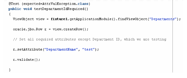

As you can see, the basic unit test generated by the wizard is quite simplistic. Let’s write our own unit test for this View Object to test that the Department ID attribute is being enforced as required. We can write such a unit test by creating a row, not setting the Department ID, validating the row, and seeing that the proper exception is thrown. But, how do we tell JUnit that we expect to see an exception (and furthermore that the test should fail if the exception is not thrown)? We do that by using the expected attribute of the @Test annotation to tell JUnit that we expect to see a certain exception. Oracle ADF should throw an oracle.jbo.AttrValException in the case we don’t supply a required attribute, so we can code our unit test like this:
Figure 13 Unit Test to Ensure Department ID is Required
If you run the test suite class again, you should see the additional test run successfully:

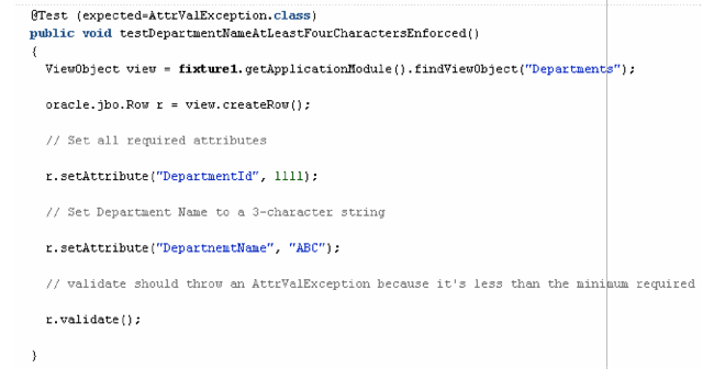

So far, all of our tests have succeeded. Let’s do a bit of TDD now, based upon a new requirement just in from the user community: the Department Name must be at least 4 characters long. In the spirit of TDD, before we write a single line of code to implement this requirement, we must write the test for it and observe it failing. We can write a unit test for this requirement by trying to set the Department Name to a three-character string (with an expected exception) and running the test suite. Here is the test method:
Figure 15 Unit Test for Department Name 4-character Minimum

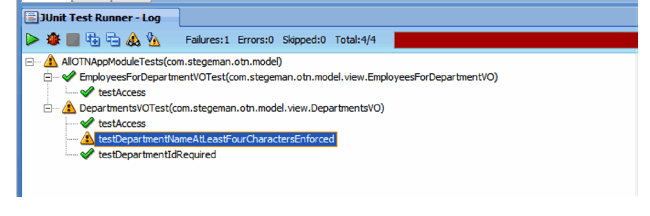

Here is what happens when we run the test suite:
Figure 16 Test Failure for New Requirement
If you click on the failed test, you can even see why the test failed:
Figure 17 Reason for Test Failure

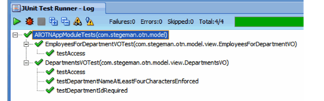

We now have done the first step of TDD, namely to write a unit test for the new requirement and observe it failing (because we haven’t implemented the requirement yet). The next step is to implement the requirement. (I won’t show the steps here; simply add a length validation rule to the Departments Entity Object to enforce a minimum length of four characters.) Once we have done that, we can rerun the test suite and observe all tests succeeding:
Figure 18 All Tests Succeeding Again

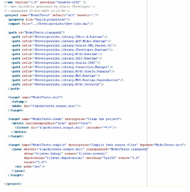

Once you have performed these steps, your ANT build.xml file should look something like this:
Figure 22 Initial build.xml File

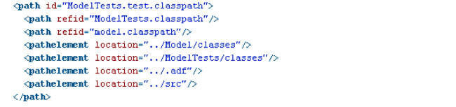

Next, we need to define a classpath for executing the Tests. The classpath will need to include the ModelTest project’s classpath, the Model project’s classpath, the output from both of those projects, and the .adf and src directories for the application (to get connection information). The resulting classpath in build.xml looks like this:
Figure 26 Test Execution Classpath

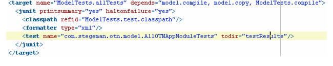

Finally, we can create the Ant task to actually execute our test suite. In the task, we specify the classpath, the test suite(s) to run, and the format to use for the test reports . XML is the best format to use with a CI server, so we’ll use it here:
Figure 27 Ant Task for Running the Test Suite

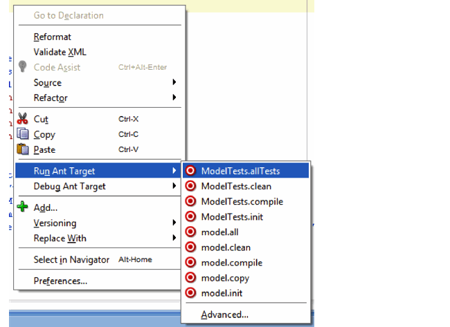

Now, we should be able to run our test suite by executing the appropriate Ant task.One option is to run it from within Oracle Jdeveloper:
Figure 28 Running the Test Suite via the Context Menu
