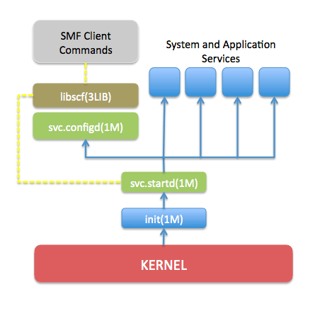

The SMF framework is always active on an Oracle Solaris 11 system, and it is started (and restarted) through the default init process, as shown in Figure 1.
Figure 1
Figure 1. SMF Framework
