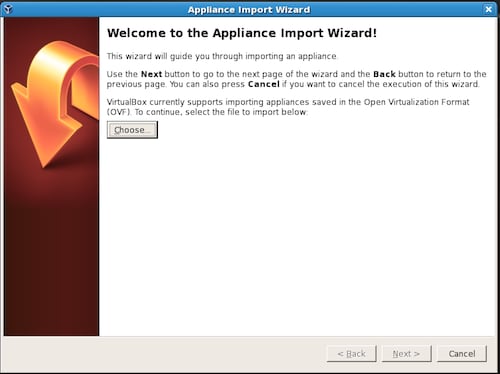

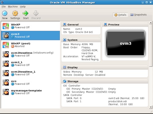

Start Oracle VM VirtualBox on your local system. If you already have a number of Virtual Machines created, you will see something similar as in this screenshot. Go to File -> import Appliance to import the Oracle VM Manager template.
oraclevm-vm-f2

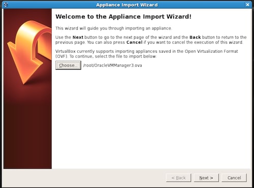

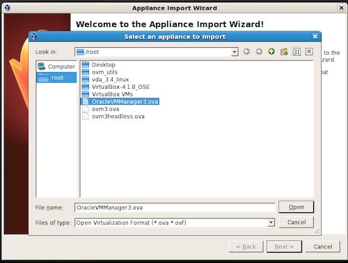

In the import appliance wizard, click on Choose, and locate the OracleVMManager3.ovafile that you downloaded.

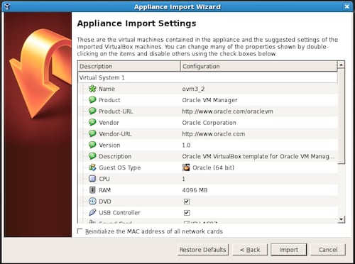

Click on Next to move to the import settings screen.
oraclevm-vm-f4
If you want to change the default Name of the Virtual Machine that will be created, double-click on Name and enter a different one. Click on Import to start the import process.

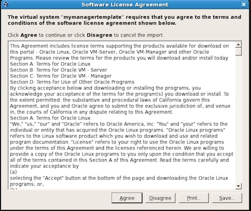

The first step of the import process is accepting the license for this template. Read the license and click on Agree or Disagree. If you Agree then the import will continue. Depending on the performance of your host system, the import can take a number of minutes to complete.

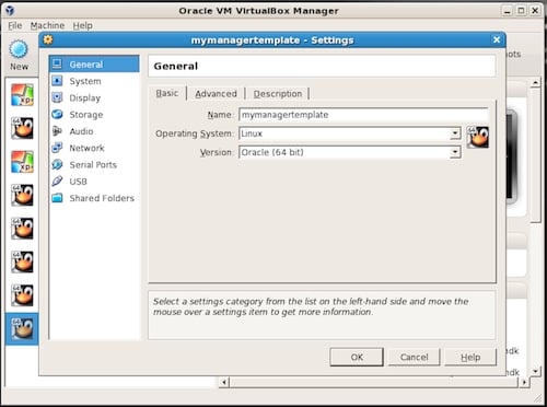

When the Import process finishes you will see the VM show up in the list on the left. In this example it is called “mymanagertemplate”. Click on the template name and then on the Settings icon at the top to modify the VM settings if needed.
oraclevm-vm-f7
You can modify various settings but it is recommended to use the defaults, to avoid any difficulties running the pre-configured environment.

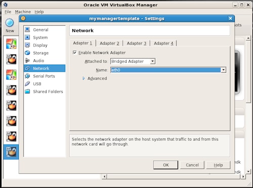

Before you start, go to the Network settings and make sure that the correct host network is assigned to the Virtual Network Adapter. Click on the Name dropdown to find the networks that Oracle VM VirtualBox detected on your system. Pick the correct network from the list. When finished click OK.

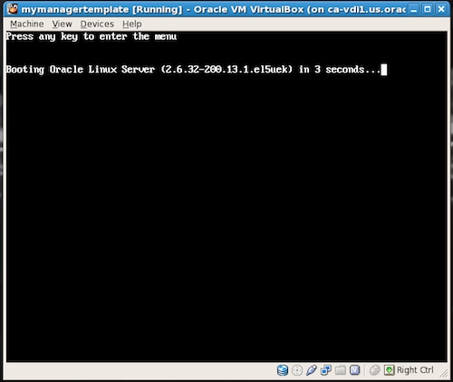

To start the Virtual Machine click on the Start Icon and the VM console will pop up showing the Virtual Machine booting into Oracle Linux. This process can take a moment.
oraclevm-vm-f10

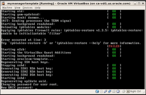

During the boot process, you will see various OS services start, including start-up of Oracle Database 11g Express Edition.
oraclevm-vm-f11
The next step is to provide a new password for the root (administrator) user of the Virtual Machine. Please enter and re-enter a new password when prompted to do so.

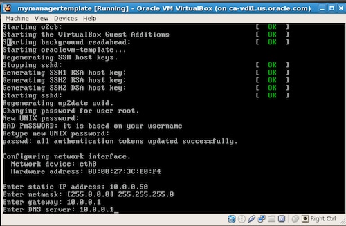

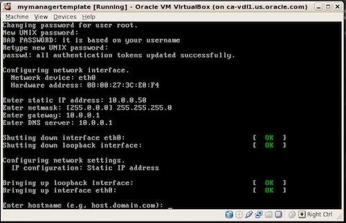

After the root password change, enter the Network settings for this VM template. Please have the static IPaddress, netmask, gateway and DNSserver IP addresses handy during first boot. This information is required to finish the configuration and installation.
oraclevm-vm-f13
After the network has re-started, the system will try to determine the host name and domain name. If it fails, it will prompt for a new hostname to be entered. If it finds the hostname, confirm by just hitting Enter.
oraclevm-vm-f14

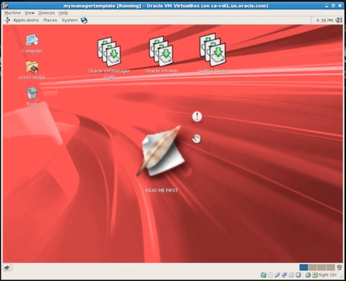

The boot process is complete when the template starts the Gnome desktop and automatically logs in as the user OVM. The desktop contains a number of links to provide easy access to get started. First double-click on the READ ME FIRST icon.
oraclevm-vm-f16

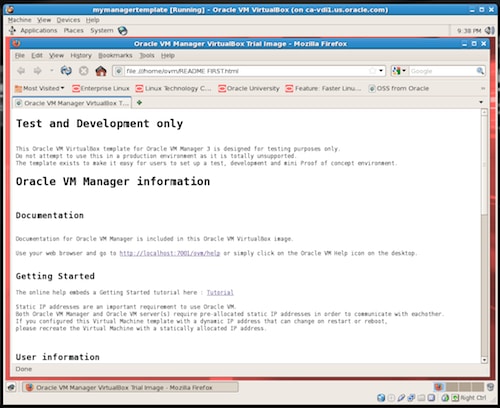

This icon will start the web browser and display a local document that contains an overview of the content of the Oracle VM Manager template including the pre-created userIDs and passwords.
oraclevm-vm-f17

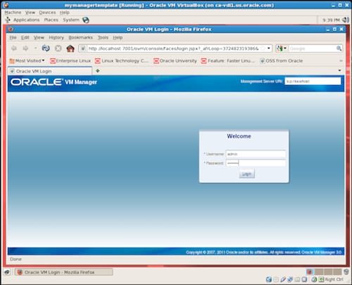

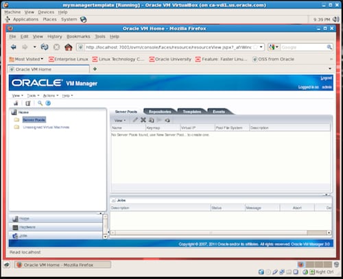

To log into the Oracle VM Manager console, double click on the OracleVM Manager Login icon on the desktop. Enter username admin and default password Welcome1 to log into Oracle VM Manager.
oraclevm-vm-f18
Once logged into the application, you can start discovering Oracle VM servers and learn about the product.

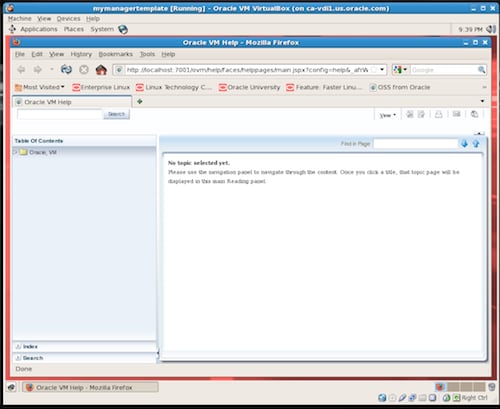

The complete Oracle VM documentation is included in the template. Simply click on the Oracle VM Help or Getting Started icons on the desktop to read the documentation. We highly recommend you read the Getting Started manual prior to experimenting with Oracle VM.
