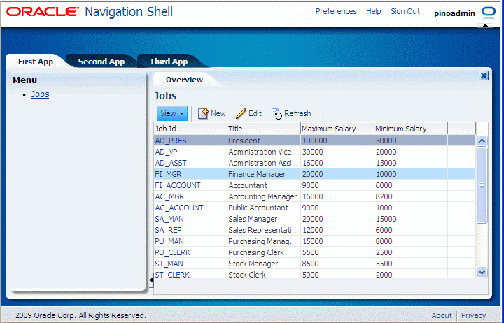

Figure 1:User clicks Jobs link to open the Overview tab within the ADF UI Shell
Overview tab when user clicks on jobs link
When the user opens the application, the option to click on the “Jobs” link is presented. When the user clicks this link, the Overview tab is launched within the ADF UI Shell, displaying the list of jobs in a table, based on the job-list-task-flow. From the Overview tab, the user has the option, for each job listed, to view the associated record in read only mode, or edit the record. Clicking one of the Job Id links in the Overview tab will launch a new tab based on the job-details-task-flow.

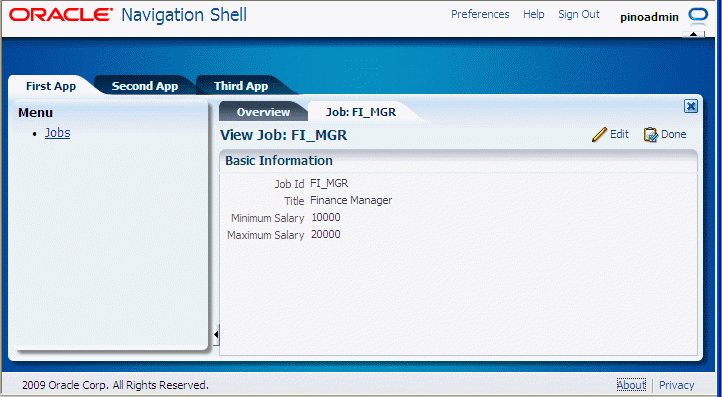

Figure 2: Detailed display of the selected record from the Overview tab.
Detailed view of the selected record
The new tab is designed to display the details of the selected record in either read-only or edit mode depending on how the task flow was invoked. In view mode this prevents the user from making inadvertent changes. In this tab the user has two options: edit or done. Clicking Done will close the current tab.

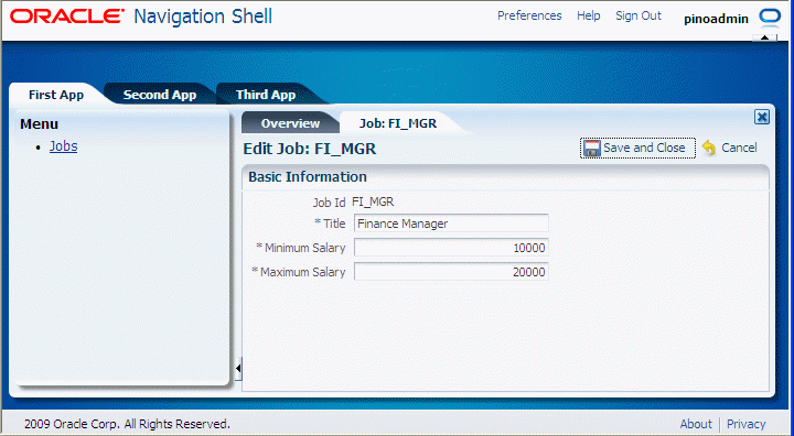

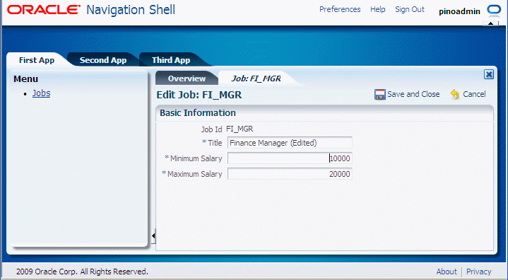

Figure 3: Detailed display of the selected record in edit mode.
Edit mode of the record
Alternatively if the user clicks the Edit button, this sets the form into edit-mode. In edit-mode the user can modify the current record. Thereafter the user has two options: Save and Close; or Cancel.

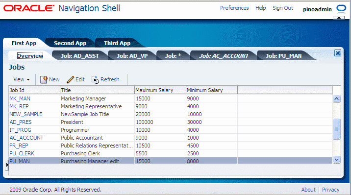

Figure 4: Modified records marked as dirty will set the tab title to italic.
Dirty tab indicates the user done modification with italic title of the tab
After modifying any attribute and existing the field, the current tab is marked as dirty (unsaved/modified) and the tab title is set to italic to reflect this fact. Clicking Save and Close updates the record and closes the current tab.

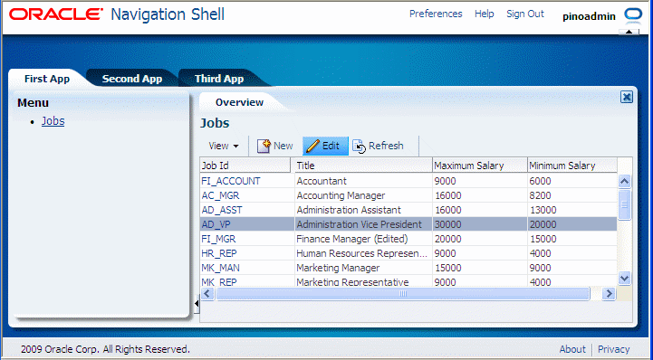

Figure 5:Users can edit a selected record from the Overview tab (Edit), or create a new record from the Overview tab (New)
Edit the selected data by Edit tab and can synchronize data by Refresh tab
Alternatively, the user can edit by selecting the record in the table and clicking the Edit button in Overview tab. The Refresh button facilitates synchronizing the list from the database. This is particularly useful if there are some other users who are also working on the same table data. If not, which seems rare in an enterprise context, automated refresh could occur as some users would expect it. This is done via ADF contextual events. However, in the interest of keeping this pattern sufficiently focused, that along with other design choices (e.g., security) was not added.

Figure 7: Collapse the splitter for the left navigation area to provide more screen real estate to the tab region.
After collapse of left splitter will get more space for multiple tabs
The user can open multiple tabs of the same task flow definition from the same Jobs table. Further, the user can collapse the splitter for the left navigation area to provide more screen real estate to the tab region. Each tab may have its own state: read-only, edit, or new. The user can change the row selection in the Overview table without affecting the view of any opened tab.

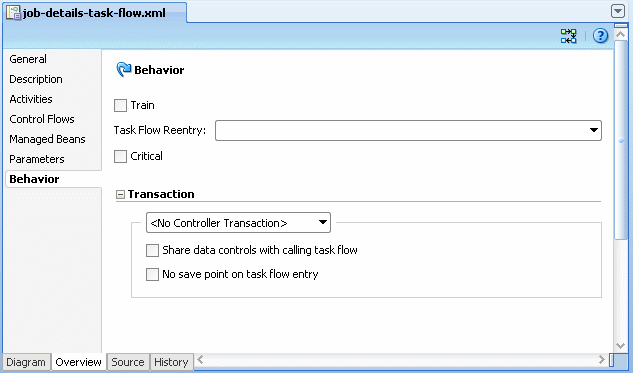

    Figure 9: The "job-details-task-flow" is set as isolated by unchecking the “Share data controls with calling task flow” checkbox.
    The job-details-task-flow is set as isolated by unchecking the Share data controls with calling task flow checkbox.
    The "job-details-task-flow" is set as isolated to prevent concurrency issues especially in new record creation. It takes resources, but on the other hand it prevents re-querying of data from the service layer every time the user navigates between tabs of the same task-flow definition.

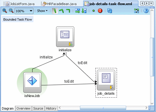

    This task flow has the following activities:
    1. The default Router activity, isNewJob, checks if the task flow parameter jobId is null. If null, this flags the creation of a new record, or alternatively, a not null jobId displays that job.
    2. Figure 10: The "job-details-task-flow" contains a router to check if the instance is for record creation or just for viewing of an existing record.
      The job-details-task-flow contains a router to check if the instance is for record creation or just for viewing of an existing record.
    3. If the Router decides to create a new record, the Method Call, initialize, function creates a new record via the EJB/JPA records.
      public void initialize(){
       Job job =
       (Job)getBindings().getOperationBinding("findJobById").execute();
       //do some initialization
       job.setJobTitle("Default Job Title");
       //ensures that form is displayed in edit-mode
       getPageFlowScope().put(EDIT_MODE, true);
    4. The final page fragment activity, job_details.jsff, is used to view, edit, or create a new Job. This fragment utilizes findById so that multiple record viewing is possible.

Design Page Fragment: Overview Tab
  1. At the base of the editor pane for the job-list-task-flow, select Diagram.
  2. Drag and drop a view activity onto the task flow diagram from the Component Palette
  3. Change the name to job_list.
  4. Open the job_list view activity by double clicking it.
    1. This should result in the Create ADF Page Fragments dialog with the file name defaulted to job_list.jsff.
  5. Click on the Browse button to the right of the Directory field.
  6. Choose Directory dialog, click the Folder icon in the upper right corner.
  7. In the Create New Directory dialog, type fragments.
  8. Click OK.
  9. Click Select.
    1. Notice “fragments” appended to the path shown in the Directory field.
  10. Click OK.
    1. Note in the Structure Window only one component is showing: jsp.root and it should be selected by default.
  11. In the Layout section of the Component Palette, select the Panel Header component to insert it into the page fragment.
  12. In the Common section of the Property Inspector, change the Text value to Manage Jobs.
  13. With the Panel Header – Manage Jobs component selected in the Structure Window, click on the Panel Header option again in the Component Palette.
    1. This results in a nested Panel Header.
  14. In the Common section of the Property Inspector, change the Text value to Jobs.
  15. While Panel Header – Jobs remains selected in the Structure Window, click on Panel Collection in the Component Palette.
    1. The result is Panel Collection nested with Panel Header – Jobs.
  16. In the Behavior section of the Property Inspector, type detach for the FeaturesOff value.
    1. This optional step hides the detach feature from the Panel Collection toolbar.
  17. In the Data Control panel of the Application Navigator expand the HRFacadeLocal data control
  18. From the Data Control panel locate the findAllJobs data control type, expand it and drag and drop the Job option onto the Panel Collection in the Structure Window (in design view).
  19. From the Create popup that displays, select ADF Read Only Table.
  20. In the Edit Table Columns dialog, select Single Row.
  21. Click OK.
    1. The result is a read only table added to the page fragment.
  22. In the Structure Window locate the table component then select the jobId af:column.
  23. In the Component Palette select Link.
  24. With the new commandLink selected in the Structure Window change the text property in the Property Inspector to #{row.jobId}
  25. For the same commandLink change the actionListener property in the Property Inspector to #{backingBeanScope.jobListForm.view}
  26. Within the same jobId af:column you'll note an af:outputText. Select and delete this.
  27. From the Menus and Toolbars section of the Component Palette, drag and drop the Toolbar into the toolbar facet of the Panel Collection in the editor.
  28. From the Menus and Toolbars section of the Component Palette, drag and drop a Toolbar Button into the toolbar in the Panel Collection you just created.
  29. In the Common section of the Property Inspector, change the Text value to New.
  30. In the Common section of the Property Inspector, click Edit from the property menu of the ActionListener property.
  31. In the Edit Property: ActionListener dialog, select jobListForm in the Managed Bean dropdown.
  32. In the Method dropdown select the create option.
  33. Click OK.
  34. In the Structure Window, select the Toolbar component.
  35. From the Menus and Layouts section of the Component Palette, click once on the Toolbar Button.
  36. In the Common section of the Property Inspector, change the Text value to Edit.
  37. In the Common section of the Property Inspector, click Edit from the property menu of the ActionListener property.
  38. In the Edit Property: ActionListener dialog, select jobListform in the Managed Bean dropdown.
  39. Select the first instance of edit in the Method dropdown.
  40. Click OK.
  41. In the Data Control panel expand the findAllJobs data control type.
  42. Expand the child Operations node.
  43. Drag and drop the Execute operation on to the Toolbar component of the Structure Window
  44. In the Create popup, select the ADF Toolbar Button.
    1. The toolbar button should appear to the right of the Edit button.
  45. In the Common section of the Property Inspector, change the Text value to Refresh.
  46. In the Behavior section of the Property Inspector, reset the Disabled property to default by selecting the option from the right most edit button drop down icon.
  47. Save the application.
Create Taskflow: Job Details
  1. Open a context menu on the Taskflows node within the Application Navigator
  2. Select New.
  3. In the New Gallery under the Web Tier node, select the JSF category.
  4. On the right hand side, select the ADF Task Flow.
  5. In the Create Task Flow dialog, type job-details-task-flow for the task flow name
    1. Notice “Taskflows” has been appended to the path name in Directory
  6. Click OK.
Register JobDetailsForm Bean
  1. At the base of the editor pane for the job-details-task-flow, select Overview.
  2. In the Overview, select the Managed Beans tab.
    1. A managed bean is a registered backing bean.
  3. Click [+] (Add) to open an entry in the Managed Beans table.
  4. In the table type jobDetailsForm for the Name.
  5. In the next column, type or select src.view.backing.JobDetailsForm for the Class.
  6. In the next column, select backingBean for the Scope.
  7. Select the Parameters tab
  8. Click [+](Add) to open an entry in the Input Parameter Definitions table.
  9. In the table type tabContext for the Name.
  10. In the next column, type or select oracle.ui.pattern.dynamicShell.TabContext for the Class.
  11. In the next column, type or select #{pageFlowScope.tabContext}
  12. In the next column, enable Required.
  13. Click [+] (Add) to open another entry in the Input Parameter Definitions table.
  14. In the table type jobId for the Name. Note the case of the name is important.
  15. In the next column, type or select java.lang.String for the Class.
  16. In the next column, type or select #{pageFlowScope.jobId}
  17. In the next column, enable Required.
  18. Click [+] (Add) to open another entry in the Input Parameter Definitions table.
  19. In the table type editMode for the Name.
  20. In the next column, type or select java.lang.Boolean for the Class.
  21. In the next column, type or select #{pageFlowScope.editMode}
  22. Select the Behavior tab.
  23. Under Transactions, make sure the Share data controls with calling task flow check box is unchecked. If it shows a blue square or dash this is wrong. It must be completely unselected, or in other words the checkbox must be empty.
Diagram of JobDetailsForm Taskflow
  1. At the base of the editor pane for the job-details-task-flow, select Diagram.
  2. From the Component Palette drag and drop the Router component.
  3. Type isNewJob for the name.
  4. From the Component Palette drag and drop the Method Call component.
  5. Type initialize for the name.
  6. From the Component Palette drag and drop the View component.
  7. Type job_details for the name.
  8. Drag and drop a Control Flow Case from the Component Palette onto the Router and drag it to the initialize Method Call.
  9. Type initialize for the name of the Control Flow Case.
  10. Drag and drop another Control Flow Case from the Component Palette onto the Method Call and drag it to the job_details View.
  11. Type toEdit for the name of this Control Flow Case.
  12. Drag and drop another Control Flow Case from the Component Palette onto the Router and drag it to the job_details view.
  13. Type toEdit for the name.
  14. Select the Router in the diagram.
  15. In the General section of the Property Inspector, select toEdit in the Default Outcome drop down.
  16. Click [+] (Add) for Cases in the Property Inspector.
  17. Type #{pageFlowScope.jobId eq 'EMPTY'}for Expression.
  18. Select initialize in the Outcome drop down.
  19. Select the Method Call in the diagram.
  20. In the General section of the Property Inspector, type #{backingBeanScope.jobDetailsForm.initialize} for the Method property.
  21. Type toEdit in the Fixed Outcome drop down.
  22. Still in the task flow diagram right click the Method Call and select Create Page Definitions.
  23. Click [+] (Add) button next to the Bindings section.
  24. In the ensuing Insert Item dialog select methodAction.
  25. Click Ok.
  26. In the Create Action Binding dialog select the HRFacadeLocal data collection option.
  27. In the Operation drop down select findJobById
  28. In the Value of the parameter jobId enter #{pageFlowScope.jobId} Click Ok.
  29. Save your application.

    1. Notice fragments appended to the path shown in the Directory field.
  5. Click OK.
  6. In the Layout section of the Component Palette, select the Panel Header component to insert it into the page fragment.
  7. In the Common section of the Property Inspector, change the Text value to #{pageFlowScope.editMode? 'Edit ':'View '}Job: #{bindings.jobId}
  8. While Panel Header remains selected in the Structure Window, click on Panel Header in the Component Palette.
  9. In the Common section of the Property Inspector, change the Text value to Basic Information.
  10. From the Data Controls palette in the Application Navigator locate the findJobById node and the Job child node, and drag and drop the Job node onto the Basic Information Panel Header.
  11. In the Create popup, select ADF Form
  12. In the resulting Edit Forms Fields dialog select Ok.
  13. Select the jobId af:inputText box in the Structure window
  14. In the Structure Window select the jobId inputText control.
  15. For the Value of the parameter jobId set the Value to #{bindings.jobId.inputValue}.
  16. In the Property Inspector under the Behaviour node override the ReadOnly property with the following EL expression (open the expression builder): #{!pageFlowScope.editMode or bindings.findJobByIdIterator.currentRow.dataProvider.jobId ne null}
  17. The bindings.findJobByIdIterator.currentRow.dataProvider.jobId line may be underlined with red. Ignore this for now.
  18. In the Structure Window select the jobTitle, minSalary and maxSalary fields at the same time (ensure they're all selected).
  19. In the Property Inspector under the Behaviour node, override the ReadOnly property with the following EL expression: #{!pageFlowScope.editMode}
  20. Still in the Structure Window select all four fields, the jobId, jobTitle, minSalary and maxSalary.
  21. In the Property Inspector under the Behaviour node, set autoSubmit = true.
  22. In the Structure Window right click the jobId, select Insert Inside af:inputText, JSF and Value Change Listener.
  23. Repeat the last step for the other three field jobTitle, minSalary and maxSalary.
  24. Select each of the f:valueChangeListeners you just created for the four inputText components, and within the Property Inspector for each, change the type property to: src.view.listeners.DirtyListener
  25. Within the Structure Window select the parent Panel Header.
  26. Within the Structure Window still, locate the toolbar facet of the parent Panel Header.
  27. From the Component Palette drag in a Toolbar into the toolbar facet
  28. With the new Toolbar component selected in the Structure Window, drag four (4) Toolbar Buttons into the toolbar.
  29. Select the first Command Toolbar Button in the Structure Window.
  30. Via the Property Inspector change the text property to Edit.
  31. Again via the Property Inspector change the Rendered property to #{not pageFlowScope.editMode}
  32. Now in the Property Inspector dialog enter #{backingBeanScope.jobDetailsForm.edit} in the actionListener property.
  33. Select the second Command Toolbar Button in the Structure Window
  34. Via the Property Inspector change the text property to Cancel.
  35. Again via the Property Inspector change the rendered property to #{not pageFlowScope.editMode}
  36. Yet again in the Property Inspector dialog type #{backingBeanScope.jobDetailsForm.cancel} in the actionListener property.
  37. Select the third Command Toolbar Button in the Structure Window
  38. Via the Property Inspector change the text property to Save and Close.
  39. Again via the Property Inspector change the rendered property to #{pageFlowScope.editMode}
  40. Yet again in the Property Inspector dialog type #{backingBeanScope.jobDetailsForm.saveAndClose} in the actionListener property.
  41. Select the fourth and final Command Toolbar Button in the Structure Window
  42. Via the Property Inspector change the text property to Cancel.
  43. Again via the Property Inspector change the rendered property to #{pageFlowScope.editMode}
  44. Second last time, in the Property Inspector type #{backingBeanScope.jobDetailsForm.cancel} for the actionListener.
  45. And finally in the Property Inspector for the fourth button only, set it's Immediate property to true.
  46. In the Structure Window select the panelForm that wraps the four inputText controls.
  47. In the Property Inspector enter the id of the first Command Toolbar Button you created into the Partial Triggers property.
  48. Save your application
  49. With the jobs_details.jsff page fragment still open select the Bindings tab at the bottom of the editor.
  50. Click [+] (Add) button next to the Bindings section.
  51. In the resulting Insert Item dialog select methodAction.
  52. Click Ok.
  53. In the Create Action Binding dialog select the HRFacadeLocal data collection option.
  54. In the Operation drop down select persistJob
  55. In the Value of the parameter job type #{bindings.findJobByIdIterator.currentRow.dataProvider}
  56. Select Ok.
  57. Still with the bindings select the [+](Add) button once again and select a methodAction.
  58. In the Create Action Binding dialog select the HRFacadeLocal data collection option.
  59. In the Operation drop down select mergeJob
  60. In the Value of the parameter job type #{bindings.findJobByIdIterator.currentRow.dataProvider}
  61. Select Ok.
