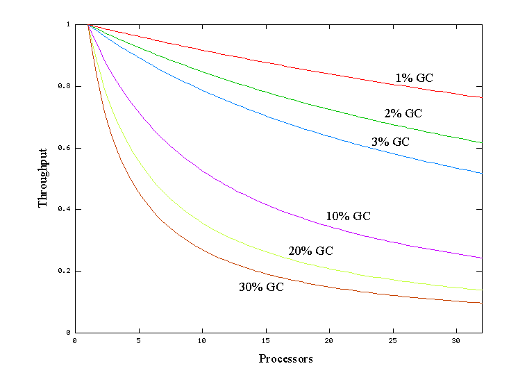

Amdahl observed that most workloads cannot be perfectly parallelized; some portion is always sequential and does not benefit from parallelism. This is also true for the Java™ platform. In particular, virtual machines from Sun Microsystems for the Java platform prior to J2SE 1.4 do not support parallel garbage collection, so the impact of garbage collection on a multiprocessor system grows relative to an otherwise parallel application.
The graph below models an ideal system that is perfectly scalable with the exception of garbage collection. The red line is an application spending only 1% of the time in garbage collection on a uniprocessor system. This translates to more than a 20% loss in throughput on 32 processor systems. At 10% of the time in garbage collection (not considered an outrageous amount of time in garbage collection in uniprocessor applications) more than 75% of throughput is lost when scaling up to 32 processors.
This shows that negligible speed issues when developing on small systems may become principal bottlenecks when scaling up to large systems. However, small improvements in reducing such a bottleneck can produce large gains in performance. For a sufficiently large system it becomes well worthwhile to select the right garbage collector and to tune it if necessary.

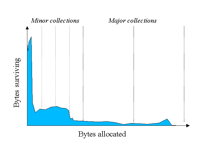

The blue area in the diagram below is a typical distribution for the lifetimes of objects. The X axis is object lifetimes measured in bytes allocated. The byte count on the Y axis is the total bytes in objects with the corresponding lifetime. The sharp peak at the left represents objects that can be reclaimed (i.e., have "died") shortly after being allocated. Iterator objects, for example, are often alive for the duration of a single loop.
Some objects do live longer, and so the distribution stretches out to the the right. For instance, there are typically some objects allocated at initialization that live until the process exits. Between these two extremes are objects that live for the duration of some intermediate computation, seen here as the lump to the right of the initial peak. Some applications have very different looking distributions, but a surprisingly large number possess this general shape. Efficient collection is made possible by focusing on the fact that a majority of objects "die young."
To optimize for this scenario, memory is managed in generations, or memory pools holding objects of different ages. Garbage collection occurs in each generation when the generation fills up. The vast majority of objects are allocated in a pool dedicated to young objects (the young generation), and most objects die there. When the young generation fills up it causes a minor collection in which only the young generation is collected; garbage in other generations is not reclaimed. Minor collections can be optimized assuming the weak generational hypothesis holds and most objects in the young generation are garbage and can be reclaimed. The costs of such collections are, to the first order, proportional to the number of live objects being collected; a young generation full of dead objects is collected very quickly. Typically some fraction of the surviving objects from the young generation are moved to the tenured generation during each minor collection. Eventually, the tenured generation will fill up and must be collected, resulting in a major collection, in which the entire heap is collected. Major collections usually last much longer than minor collections because a significantly larger number of objects are involved.

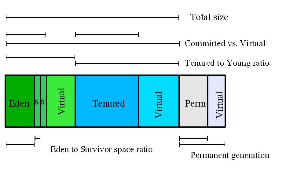

A number of parameters affect generation size. The following diagram illustrates the difference between committed space and virtual space in the heap. At initialization of the virtual machine, the entire space for the heap is reserved. The size of the space reserved can be specified with the -Xmx option. If the value of the -Xms parameter is smaller than the value of the -Xmx parameter, not all of the space that is reserved is immediately committed to the virtual machine. The uncommitted space is labeled "virtual" in this figure. The different parts of the heap (permanent generation, tenured generation and young generation) can grow to the limit of the virtual space as needed.
Some of the parameters are ratios of one part of the heap to another. For example the parameter NewRatio denotes the relative size of the tenured generation to the young generation. These parameters are discussed below.
