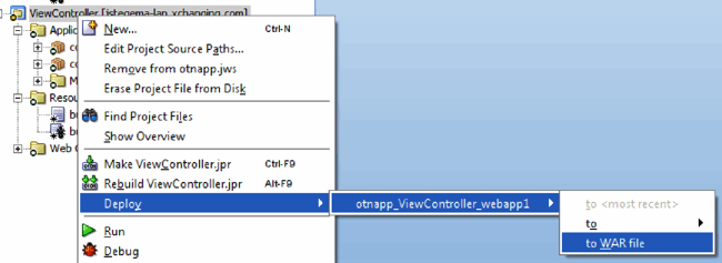

- Create an Ant build script to create WAR/EAR files.

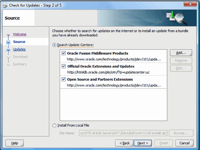

3. Ensure that at least the Open Source and Partners option is selected:
Figure 3 Selecting the Update Center to search
Select the JDevLibsForAnt extension and click Next.
Figure 4 Selecting the JDevLibsForAnt extension

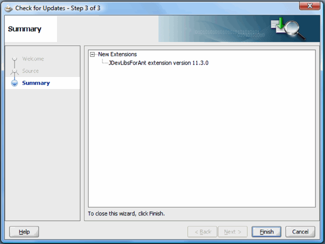

4. Click Finish on the Check for Updates summary page.
Figure 5 Check for Updates summary page
The project is now visible in the Application Navigator, although there are no files visible when expanding it:
5. Restart Oracle JDeveloper when you are prompted to finish installing the extension. When asked whether you want to migrate user settings from a previous release, answer No.

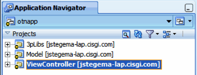

If you have been following along with the example project in this series, you will have an application containing three projects as shown here.
Figure 6 Current application with three projects

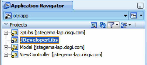

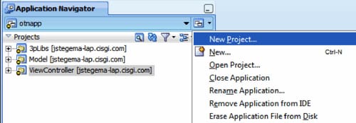

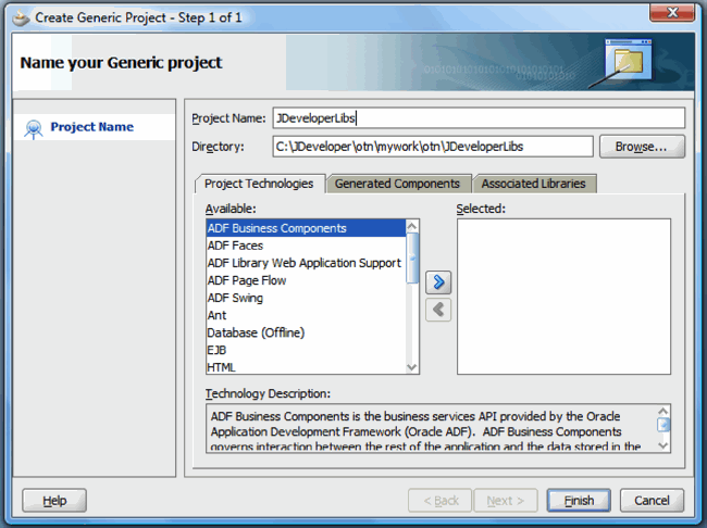

The first step is to create a new project to hold the Oracle JDeveloper libraries. To do this, go to the shortcut menu in the Application Navigator and select New Project
Figure 7 Creating a new project
When prompted, choose the Generic Project type.
Figure 8 Selecting a generic project
Finally, provide a descriptive name for the project, such as JDeveloperLibs. You do not need to select any technologies for the project, because the project is just a placeholder for the required libraries and an associated Ant script you will create in the next step:
Figure 9 Naming the new project
Your new application should now look like this screen shot:
Figure 10 Application with new JDeveloperLibs project
If you are using version control for your project, now would be a good time to add the new project (that step isn’t shown here).

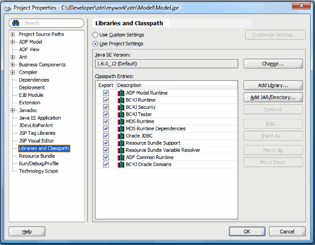

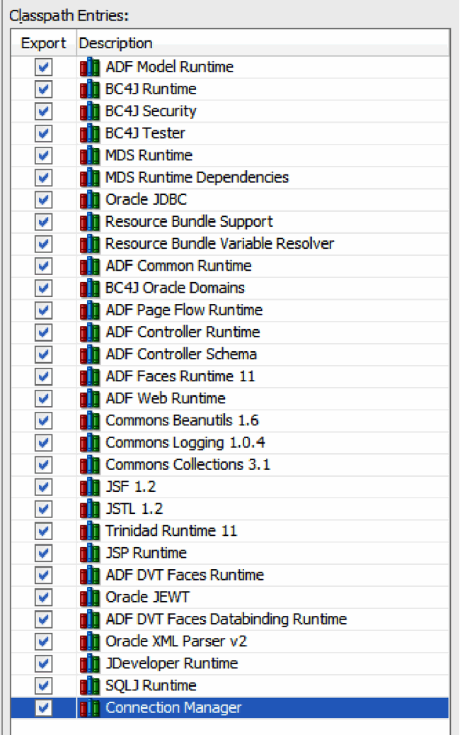

The next step is to set up the new project to reference all the required libraries for the application. To do so, you determine all the libraries referenced by all the projects in the application. First, let’s find out what libraries are used by the Model project. To do that, double-click theModel project to show the project’s properties and then select the Libraries and Classpath category in the properties window.
Figure 11 Model project’s libraries
Make a note of all the libraries referenced by this project (there are 11 in this example). Then cancel the Project Properties dialog box and double-click the JDeveloperLibs project to display its properties. Finally, click the Add Library button to add all the libraries you noted from the Model project. The order of the libraries doesn’t matter, although you may find it easier to reconcile if they are. Next, repeat this same process with the ViewController project to add any other library references from the ViewController project to the JDeveloperLibsproject. Note that there will be some overlap between the libraries from the Model project and ViewController project; you do not need to add the libraries a second time. When you are finished, the list of libraries referenced by your JDeveloperLibs project should look like this (again, the order of the libraries isn’t important):
Figure 12 Complete list of libraries for the JDeveloperLibs project

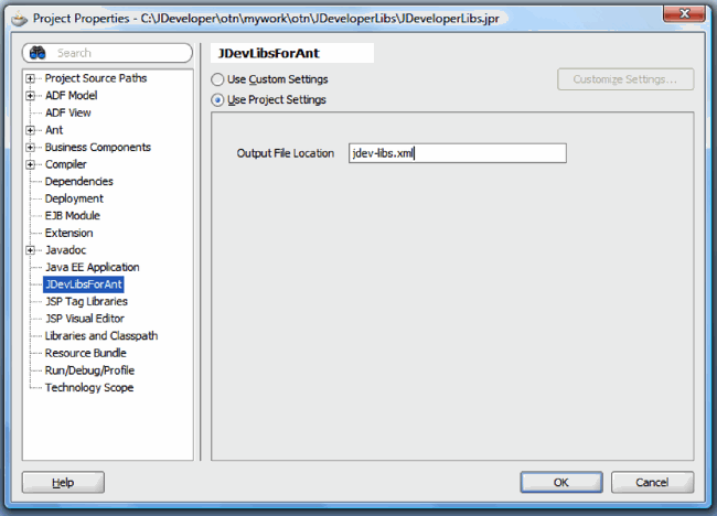

The next step is to create an Ant script that contains library definitions for all the libraries referenced for the application. To do this, you will use the JDevLibsForAnt extension you installed earlier. You first need to configure the extension; to do that, double-click theJDeveloperLibs project to display the Project Properties dialog box, and select the JDevLibsForAnt category. Then provide the filename jdev-libs.xml as the output file location and click OK.
Figure 13 Configuring JDevLibsForAnt

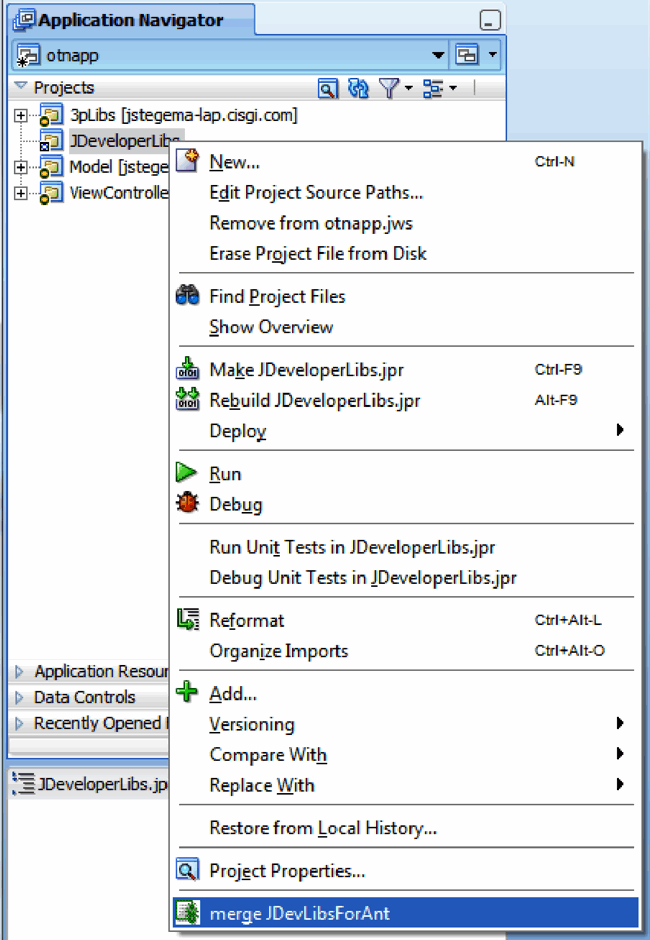

Now you can use the JDevLibsForAnt extension to create a file (it will be called jdev-libs.xml) that contains path references for all the Oracle JDeveloper libraries. To do this, right-click the JDeveloperLibs project and select merge JDevLibsForAnt.
Figure 14 Running merge JDevLibsForAnt

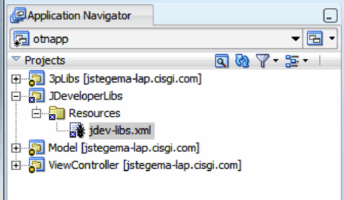

After running merge JDevLibsForAnt, click the Refresh button in the Application Navigator to see the jdev-libs.xml file that was created.
Figure 15 The jdev-libs.xml file in the hierarchy

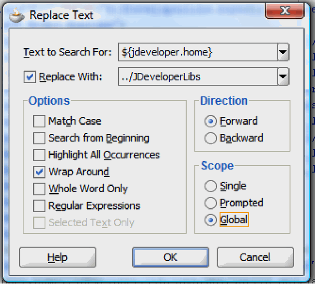

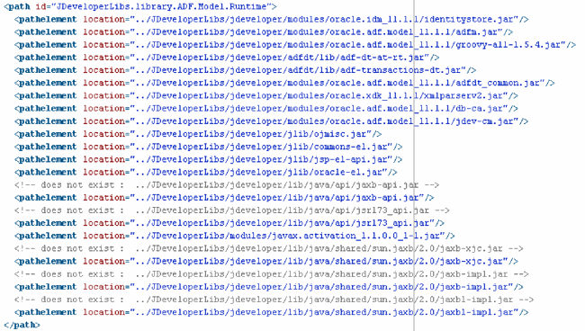

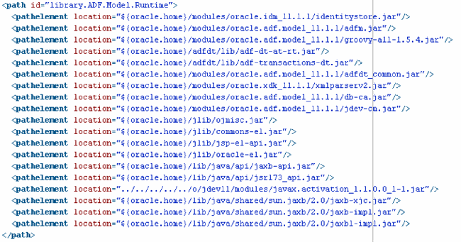

Finally, remove references to the JDeveloper home directory in jdev-libs.xml, by doing a global search-and-replace as shown here:
Figure 16 ADF Model Runtime library definition
This will ensure that the path references point to the JDeveloperLibs project directory instead of the JDeveloper installation directory.

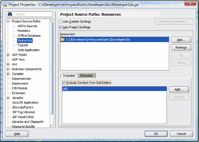

To copy the libraries’ JAR files, you will use the jdev-libs.xml file as a reference. You need to copy the JAR files from the JDeveloper home directory, maintaining the same general directory structure. As an example, let’s take the ADF Model Runtime library:
Figure 17 Including content from subfolders
To copy the JAR files for this library, you need to create the same directory structure in your JDeveloperLibs project directory and copy the referenced JAR files from the JDeveloper installation directory. One thing to note is that some of the supplied JDeveloper library definitions refer to files that don’t exist! The JDevLibsForAnt extension helpfully flags these files in its generated script; for this example, there are five “missing” JAR files you do not need to copy.
As an example, let’s take a look at the first JAR file that’s part of the ADF Model Runtime library definition, identitystore.jar. You can find that file in the <JDEVELOPER_INSTALL_DIRECTORY>/jdeveloper/modules/oracle.idm_11.1.1 directory. You should create the jdeveloper/modules/oracle.idm_11.1.1 directory structure inside the JDeveloperLibs project directory and copy identitystore.jar there. You should also configure the JDeveloperLibs project’s Resources folder to show the JAR files you’ve copied. To do this, double-click theJDeveloperLibs project to display the Project Properties dialog box. Next, expand the Project Source Paths node and select theResources subnode. Then click the Include Contents from Subfolders check box:
Figure 18 Excluding the classes folder
Finally, on the Excluded tab, click the Add button; in the Add Exclude Filters dialog box, select the classes folder and click OK.

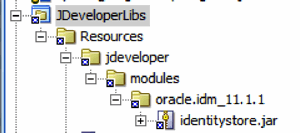

Figure 19 The identitystore.jar file shown in the Application Navigator
You should now be able to see the identitystore.jar file in the Application Navigator in the appropriate directory structure:

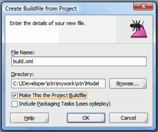

Now you can create the default Ant build file by right-clicking the Model project and selecting New. Next, in the New Gallery, select Antfrom the General category, select Buildfile from Project, and click OK:
Figure 22 Creating the build file for the Model project
In the Create Buildfile from Project dialog box, leave all the default options selected and click OK:
Figure 23 Buildfile options

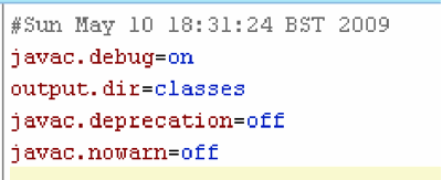

Once you have completed these steps, you will see two new files in the Resources category for the Model project. The build.xml file contains the Ant targets and library definitions, and the build.properties file contains some properties used by the build script. You will now make some small changes to the properties and build files to enable the build to work on a clean machine. The first change is to thebuild.properties file. There are two properties you can comment out (remove) from the file. First, the oracle.home property refers to JDeveloper installation directory. Because you have set up the library references to be independent of the JDeveloper home directory, you can remove this line from the build.properties file. Similarly, the build.compiler property specifies that Ant should use the Oracle Java compiler to compile the Java files. You can also remove this line from the file, because the clean machine will not have the Oracle Java compiler installed. After you have removed the two unnecessary properties, your build.properties file should look something like this:
Figure 24 Modified build.properties file

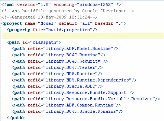

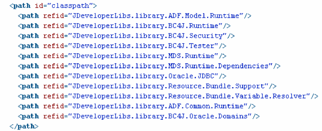

Now you can change the build.xml script to replace the library references that are hard-coded to the JDeveloper installation directory with the references you created in the JDeveloperLibs project. To do this, open the build.xml file for the Model project. You should see a series of <path> definitions (11 of them, to be exact) that correspond to the 11 libraries that are referenced by your project. For example, the ADF Model Runtime path looks like this:
Figure 25 ADF Model Runtime <path> element
You should delete all these path definitions, because they all point to the JDeveloper installation directory (be sure to leave the “classpath” path reference). Once you’ve removed the <path> elements corresponding to the libraries, the start of your build.xml file should look like this:
Figure 26 Start of build.xml with <path> elements removed
Now you can add an <import> element to the file to incorporate the jdev-libs.xml file you created earlier. Add the <import> element before the classpath <path> element like this:
Figure 27 Importing jdev-libs.xml
The <import> element will put the jdev-libs.xml file into the build.xml script when the Ant targets are invoked. Finally, you may have noticed that the <path> IDs used in jdev-libs.xml are slightly different from the <path> IDs expected in build.xml; for example, inbuild.xml, the ADF Model Runtime has a <path> ID of library.ADF.Model.Runtime whereas the <path> ID for that library in jdev-libs.xml is JDeveloperLibs.library.ADF.Model.Runtime. To reconcile these differences, edit all the refids in build.xml to include JDeveloperLibs. at the start, as shown here:
Figure 28 Changing the path IDs in build.xml

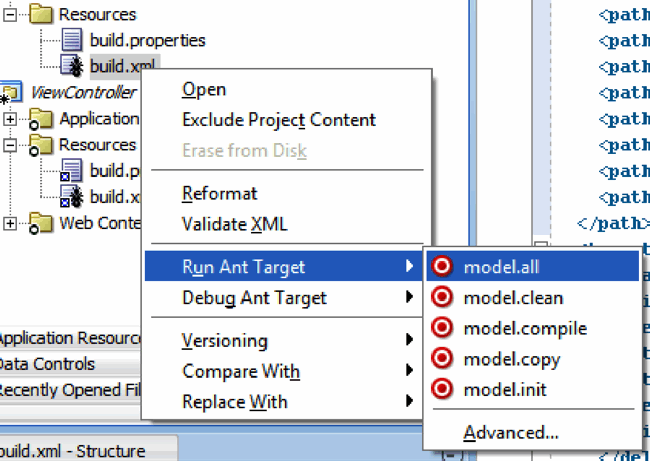

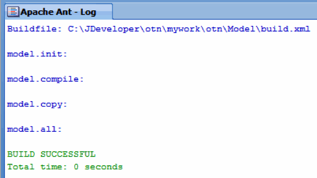

You can now also test the Ant targets from within Oracle JDeveloper. Let’s do this by running the all target. To do this, right-click thebuild.xml file and select the model.all target from the Run Ant Target submenu:
Figure 30 Running the model.all Ant target

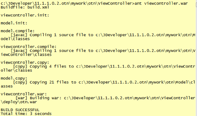

You can verify that the target executed successfully, by looking at the Apache Ant - Log window:
Figure 31 Apache Ant - Log window

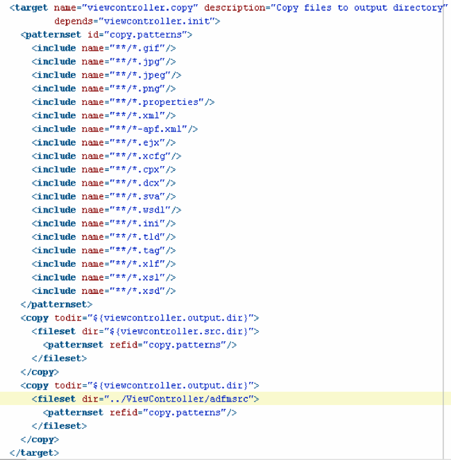

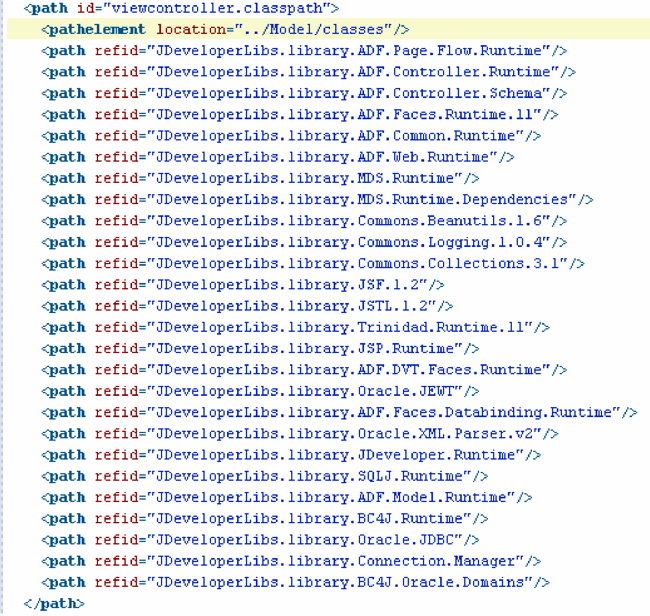

A few more steps are needed for completing the ViewController project’s build.xml file. The first step is to remove all the pathelement items that correspond to the JDeveloper libraries. You will find these under the top-level <path id="viewcontroller.classpath"> element in the file. Be sure you don’t remove the <pathelement location="../Model/classes"/> item, because it corresponds to the classes from the Modelproject. When you have done this step, you should have something like this for the viewcontroller.classpath path:
Figure 32 Updated viewcontroller.classpath path

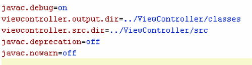

To fix up all the directory references, you will need to edit the build.properties and build.xml files for both the Model project and theViewController project. Let’s start with the Model project. First, in the build.properties file, change the name of the output.dir variable to model.output.dir (to avoid a name collision with output.dir for the ViewController project) and change the path reference as shown here:
Figure 35 model.output.dir
Next, add a variable called model.src.dir, like this:
Figure 36 model.src.dir
Do the same thing to the build.properties file for the ViewController project, so that it looks like this:
Figure 37 build.properties for the ViewController project

5.In the model.compile target, change the path property of the src element (use the newly defined model.src.dir variable):
6. In the model.copy target, change the copy and fileset elements (change the variable name and use the newly defined variable for src):
Once you have made the above changes for both the Model and ViewController build files, you should be able to successfully run the viewcontroller.compile target and see the following output:
Figure 38 Ant output for successful viewcontroller.compile
Adding a WAR Target
Now that you are able to compile the entire application, you can create additional Ant targets to create the deployment artifacts (WAR and EAR files) for the application. Because Ant already includes tasks for building such files, it is quite easy to add these targets. The easiest way I have found to create the Ant targets properly is to use Oracle JDeveloper to create the appropriate file (WAR or EAR) and then to unzip the file to have a look at the structure. By doing this, you can ensure that the resulting file will have the correct structure. For example, you can right-click the ViewController project and use the context menu to create a WAR file:
Figure 39 Creating a WAR file
If you then expand the WAR file, using any unzip utility, you will find that the file contains:

Armed with this knowledge, you can create the appropriate target in the build.xml file. To follow the pattern we have used so far, let’s create three additional properties in the ViewController project’s build.properties file for use in the Ant script:
Figure 40 Adding three more properties

Next, you may notice that the viewcontroller.copy target does not copy the page definition and related ADF Model configuration files. You can fix that by changing the viewcontroller.copy target to look like this:
Figure 42 Updated viewcontroller.copy target

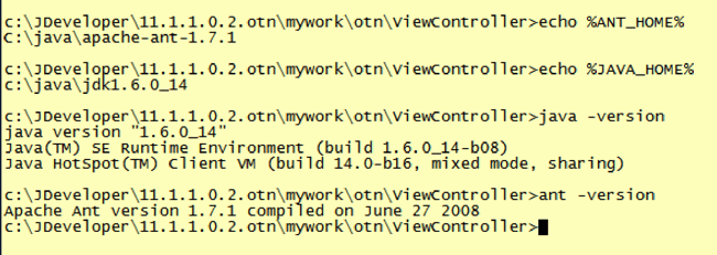

Now that you have a build.xml file that you can use to build your application, it’s time to try running the build from outside Oracle JDeveloper. Because you have added all the ADF libraries required for compilation to the project, you should be able to check out the application from Subversion on a machine without Oracle JDeveloper installed and build the application (provided you have installed Apache Ant and a suitable JDK on the machine). In the example below, the machine has both Ant and a JDK installed and has environment variables set for Ant_HOME and JAVA_HOME pointing to those installations:
Figure 45 JDK and Ant are installed
Now you can run Ant from the command line to build the WAR file like this:
Figure 46 Building the WAR file from a command prompt
