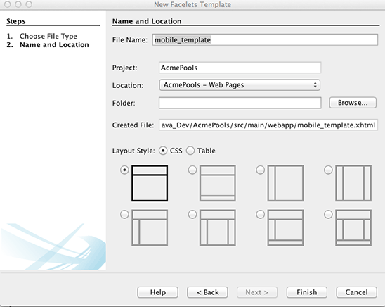

Next, we want to create a template that can be utilized by all of the views within our mobile solution. Begin by right-clicking the mobile folder you just created, choosing New, and then selecting Facelets Template. Name the template mobile_template.xhtml, and save it (see Figure 1). At this point, it does not matter which layout style you choose, because we will overwrite it anyway.
Figure 1. NetBeans New Facelets Template wizard

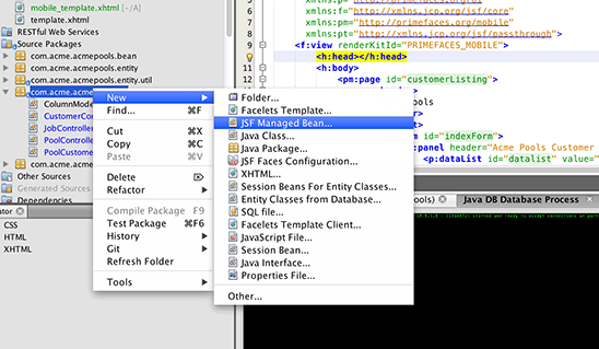

Next, let's create the MobileNavigationController class by navigating to the Source Packages folder in our project, right-clicking the com.acme.acmepools.jsf package, selecting New, and then choosing JSF Managed Bean (see Figure 2).
Figure 2. Creating a JSF managed bean in NetBeans IDE
In the dialog box that opens, change Class Name to MobileNavigationController, set Scope to session, and leave all of the other default values. Click Finish to create the class.

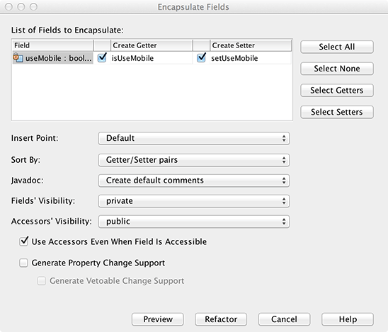

Add a private boolean field to the class, and name it useMobile. Set the value to false within the field declaration. Now, generate accessor methods for the field by right-clicking the field name, selecting Refactor, and choosing Encapsulate Fields. Ensure that both Create Setter and Create Getter are selected, and click Finish (see Figure 3).
Figure 3. Encapsulate Fields screen

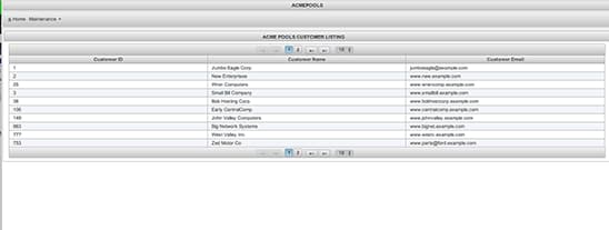

Next, we want to load the initial application view, which displays a list of Acme Pools customers, within the mobile user interface. Figure 4 shows what the initial view of the AcmePools application looks like in the standard web application. As a first step in creating a mobile UI for AcmePools, we wish to make this view more mobile-friendly.
Figure 4. Standard Acme Pools customer listing

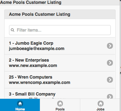

We've now successfully created the first mobile page of the AcmePools mobile application. If you run the application now, and traverse to the URL http://localhost:8080/AcmePools/faces/mobile/index.xhtml, you should see a view resembling Figure 5 in your browser.
Figure 5. AcmePools mobile customer listing

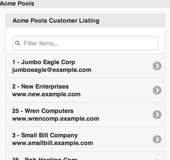

When a customer is selected from the listing, a page that looks like Figure 6 will be displayed.
Figure 6. Customer detail page

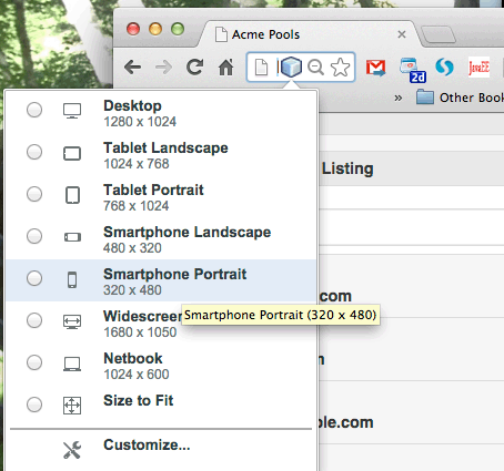

Note: For an exceptional mobile test viewer, install the Google Chrome browser plugin for NetBeans IDE. The browser plugin not only enables live content editing, but it also allows you to easily change the size of the view according to the size of screen being targeted for development (see Figure 7).
Figure 7. NetBeans IDE Chrome plugin
Follow the guidelines above to develop the different mobile views for your application. I recommend trying out each of the navigational transitions and also the touch events to see what works best for your application.

Now we are ready to embed the new menu into the footer sections of our mobile pages. Do so by adding a <ui:include> tag, as shown below, inside the <pm:footer> section within each mobile view. Also specify the fixed=true attribute for the footer, because this will allow the footer to remain onscreen at all times. If a user touches somewhere on the screen, the menu will slide down and become hidden.
<pm:footer fixed="true">
<ui:include src="menu.xhtml"/>
</pm:footer>
The resulting mobile view for index.xhtml will look like Figure 8, once loaded in the browser.
Figure 8. Complete index.xhtml mobile view
