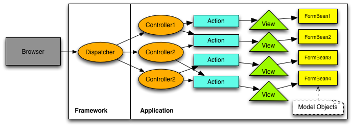

Action Oriented MVC == MVC 1.0
In contrast to UI component oriented MVC, the kind of MVC being advocated in MVC 1.0 can be called “action oriented MVC”. This style is shown in Figure 2 and was popularized in frameworks such as Apache Struts and Spring MVC.
Diagram illustrating Action Oriented MVC
Figure 2: Action Oriented MVC
The controller dispatches to a specific action, based on information in the request. Each action does a specific thing to transform the request and take action on it, possibly updating the model tier. This approach does not try to hide the request/response model of the underlying HTTP, and it also says absolutely nothing about the specifics of the HTML/CSS/JS comprising the UI.
Though the API for MVC 1.0 is wide open, one piece of prior art that will certainly influence its design is the Jersey MVC system. The Jersey source code includes numerous examples, including the Bookstore Webap, which is excerpted here. Again, we start with the view, this time a simple JSP page.
