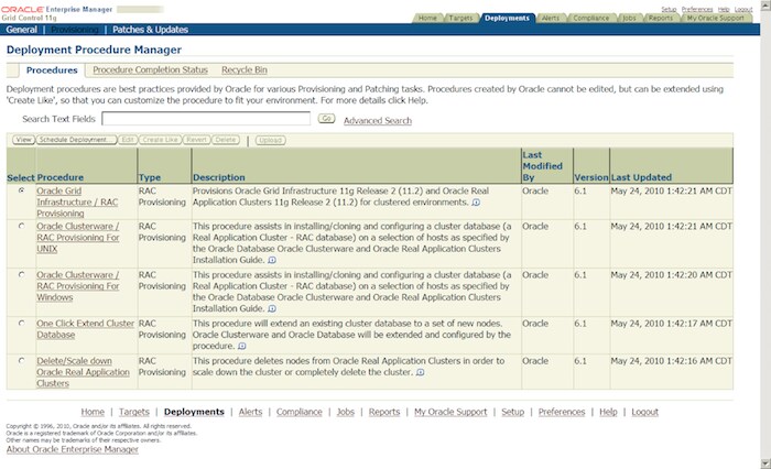

Clone Wizard versus the New Deployment Procedures
Oracle Enterprise Manager supplies a “Clone Wizard” which was the original way of cloning Oracle software and databases using Enterprise Manager. This functionality is not certified to work with Oracle Database 11.2 and will ultimately be superseded by the new Deployment Procedure technology that we will explore in a later section. However, the Clone Wizard is worth having a look at, to see how Enterprise Manager first started with cloning Oracle Homes in a simple, wizard driven way. We will use this to clone an Oracle 10g Database home.

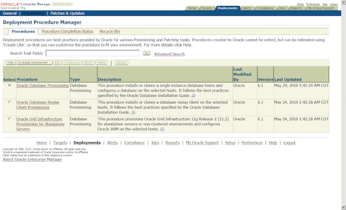

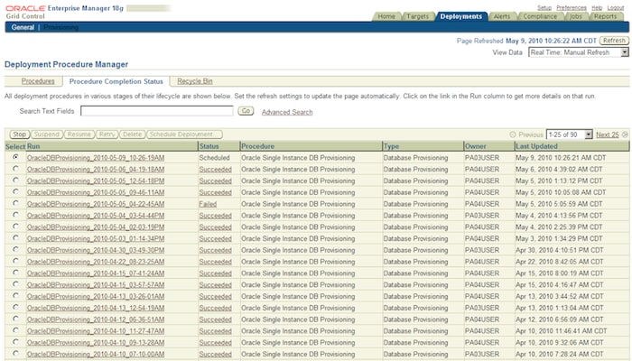

Login to the Oracle Enterprise Manager Grid Control console, and move to the Deployments Tab (seen in Figure 1). Under the Cloning section, notice that there is an option to clone the Oracle Home as well as the Oracle Database. Click on the Clone Oracle Home link.
havewala-provisioning-f1
Figure 1

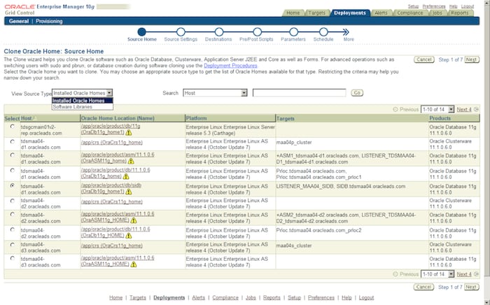

This starts the Clone Wizard and brings up the Clone Oracle Home: Source Home page (Figure 2). Now, you can select the Source Home to be cloned.
Notice that the default Source Type on this page is “Installed Oracle Homes”, and hence the table shows the installed Oracle Homes on different hosts that can be cloned by this provisioning procedure. The platforms, database versions and patchset levels are also visible as also the targets on each host (so it is possible to understand what software is present in the Oracle Home being cloned).

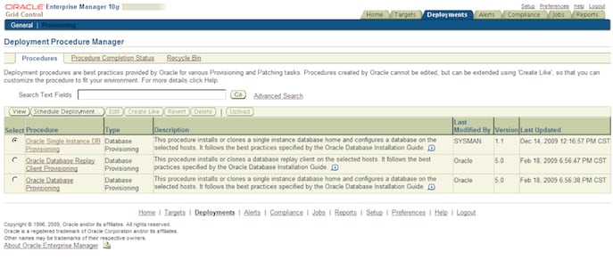

The page clearly mentions that the Clone Wizard can be used for cloning Oracle software such as the Oracle Database, Clusterware, Application Server, and so on. However, for advanced operations such as switching users with sudo or pbrun, or if you want to include database creation along with the software cloning, the use of the more sophisticated “Deployment Procedures” is recommended – these are a highly customizable series of pre-defined steps that we will look into in a later section in this article.

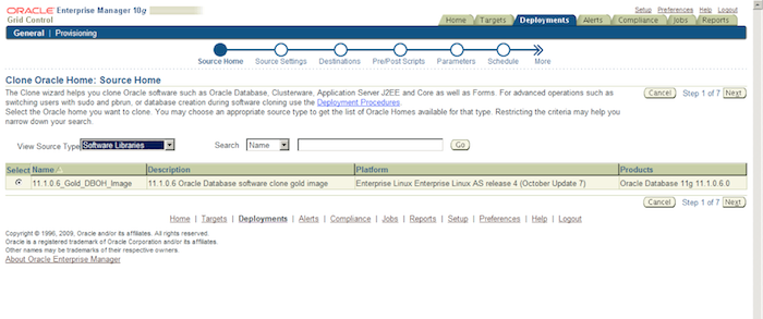

Note the different types of Oracle Database 10g and 11g homes available for cloning, and also the Oracle CRS and Oracle ASM homes – all of these can be cloned. You have selected the /app/oracle/product/db/sidb (OraDb10g_home1) on the tdsmaa04-d1.oracleads.com host as the Source Home. The exclamation mark signifies that there are critical patch advisories that apply to this home. This is obviously an Oracle Database 10g Home.
It is possible to change the Source Type on this page by selecting a different value from the dropdown box. If you select “Software Library” as the Source Type, then this will be treated as the source for the provisioning procedure. In the page that appears (Figure 3), an 11.1.0.6 Gold Database Oracle Home image can be seen in the list.
But what is this Software Library and Gold Image?
havewala-provisioning-f3
Figure 3
Software Library with Gold Copy or Image
A Software image library is used in the process of provisioning, as a means of storing standardized images that have been pre-installed and possibly patched upto an appropriate level. This is known as a “Gold” copy or image.
For example, a Gold copy could be an image of a fully patched Oracle Home (such as an Oracle 10g Home patched to 10.2.0.5 with the latest Patchset Update (PSU) or Critical Patch Update (CPU) applied), installed as per the corporate database standards and security standards, and with only the licenced options installed as per the coporate licence.
The options selected could be the Oracle Label Security Option and/or the Oracle Database Vault Option, if the corresponding licences have been purchased and if these options are considered necessary to be pre-installed with all new Oracle Database Homes as per corporate security policy. We should note here that the Oracle Installer allows these options to be selected when “Advanced Installation” and a “Custom” install of the Oracle Database software is being performed.
The Gold Copy could have these options pre-selected and pre-installed and therefore avoid any oversight on subsequent installations by the DBA, since the DBA would simply be using the Gold Copy to create a cloned Oracle Home.
The other possibility is that certain unlicensed options may be inadvertently installed during manual installations of the database, such as when Orace Database 11g is installed using the Oracle Installer and “Enterprise Edition” is selected under Advanced Installation. This would automatically preselect and install the Oracle Partitioning option and Oracle Advanced Security option, and if these database options are used in any way in the future, this usage would be detrimental to Oracle license compliance.
The Gold Copy would however prevent such an event by ensuring, in the first place, that such unlicensed options are not installed in the Gold Copy.
The Gold Copy or Image can be thought of as a managed set of software components (that can be the operating system software, Oracle software, or other third-party software), directives (executable instructions used for provisioning) and other information bundled together to construct an independent deployable unit. The Software Library in Oracle Enterprise Manager is used to maintain the software components that can be combined with other components as required so as to form the final software configuration (the Gold Copy) that can now be provisioned. The Gold Copy must also refer to staging, preinstall or postinstall directives.
Once the Gold Copy of an Oracle Home has been set up in this manner in the Software library, new Oracle Homes can be created on any other servers (on which the Oracle Enterprise Manager Agent has been installed) by simply running the Clone Oracle Home utility or the Database Provisioning Deployment Procedures (these are preferable to the former). The new Home will be an exact copy of the Gold image and as such will be of the same version, patchset level, and with all the appropriately licensed database options included in the Gold image. You no longer have to worry about the starter DBA in the application team installing the entire suite of options or patching the Oracle Home inappropriately, or not patching it at all.
Hundreds and even thousands of database servers can be provisioned in this way from the Gold copy in an automated matter and in much less time as it would take to perform the core software installation manually, patch to an appropriate level manually and also ensuring at the same time that all the database standards have been observed and only the licensed options have been included – a tall order for the manual method, no matter how scripted, when it comes to thousands of provisioned databases per year.
The Gold Copy Provisioning thus effectively reduces the implementation time and eliminates the overall human error inherent in a step-by-step manual process or in a manually scripted process.

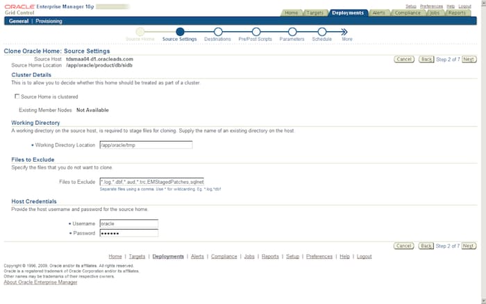

In the Source Home page (Figure 2), you selected an existing Oracle Home and then clicked on the Next button. This brings up the Source Settings Page (Figure 4). On this page, select a working directory on the source host to stage the files for cloning.
havewala-provisioning-f4
Figure 4
At this point, you would want to exclude certain files from the copy process – specify these under the section “Files to Exclude”. A default list of the files to be excluded is displayed. You can change this list if desired:
  *.log,*.dbf,*.aud,*.trc,EMStagedPatches,sqlnet.ora,tnsnames.ora,listener.ora,oratab
Logically, this list exists since there is no need to copy log files, data files, audit files and trace files from the Source Oracle system. You also need not copy Oracle SqlNet files such as tnsnames.ora, sqlnet.ora and listener.ora that may contain server-specific details (the hostname or IP address of the source server).
The operating system directories where Oracle Enterprise Manager patches are staged, or the oratab file do not need to be included as well – the latter is usually to be rebuilt differenty on each server as per the databases existing on that server.
Select Next. If there is insufficient space in the working directory location, such as happened when we initially selected /tmp, then the following warning appears. Clear the space in /tmp or choose another working directory on the server before trying again.
Review the following warnings before continuing. The issues below must be addressed before submitting the Clone Home job.
 tdsgcadmin01-rep.oracleads.com - Insufficient space on /tmp to clone this home to a different host.
The estimated space required to archive this home is 3417 MB. If cloning to the same host, archive space is not required.

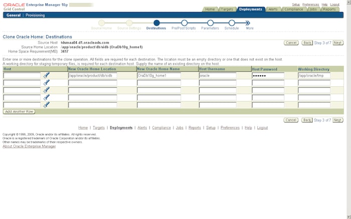

Destinations

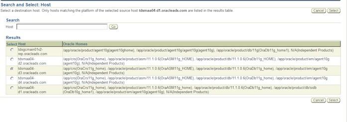

In the next screen that appears (Figure 5), the destination host can now be selected. The space requirement for the new Home is also displayed on this page. In our case it is 3417 MB.
havewala-provisioning-f5
Figure 5

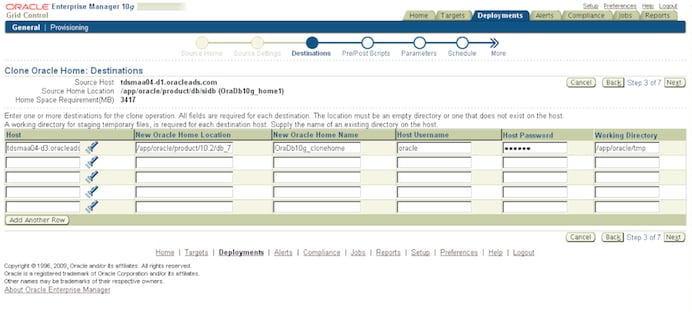

Click the torch icon next to the Host field on Figure 5. This brings up a list of target servers (Figure 6) with the same operating system as the source server – no other servers can be seen in this list, although they may be visible elsewhere as targets in the Oracle Enterprise Manager Grid Control Console.
Select tdsmaa04-d3.oracleads.com as the destination host. This already has an Oracle CRS (Cluster Ready Services) 11g Home, Oracle ASM (Automatic Storage Management) 11g Home, Oracle Database 11g Home and an Oracle Enterprise Manager 10g Agent home that are all marked as independent products.
havewala-provisioning-f6
Figure 6
After selecting the destination host, you need to enter the new Oracle Home location (Figure 7). The cloning will take place to this location. Also give a new name to the Oracle Home (in this case, the name OraDb10g_clonehome is used for illustration purposes).
Next, the host credentials for the destination host can be entered and the working directory is specified on the same page.
havewala-provisioning-f7
Figure 7
Notice that it is possible to add multiple destinations on this page, the effect being that multiple Oracle homes can be created on multiple target servers by cloning from the same source Oracle Home or Gold Copy. In this way, it is possible to automate the provisioning on hundreds or even thousands of destination servers from one master Gold image in the Oracle Enterprise Manager Software Library, or from a reference installation on one of the servers.

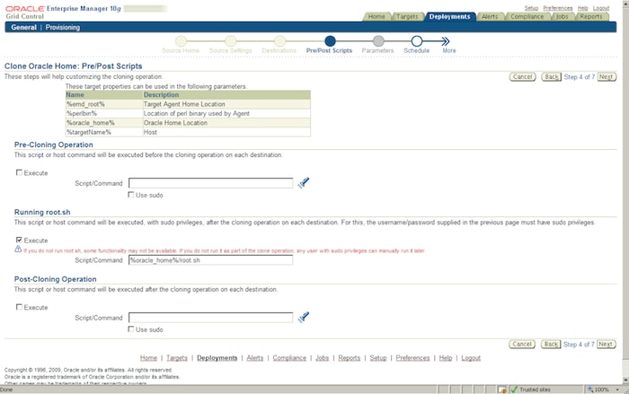

Pre-cloning and/or post-cloning operations (either scripts or host commands) to customize the cloning operation can be specified on the next page (see Figure 8). You can choose if sudo is to be used or not in these operations – this will not be required if the operations do not require root privileges.
However, the option “Running root.sh” does require root privileges. If and only if the oracle user you specified in the credentials page has sudo privileges, then you can choose to execute the root.sh script on this screen, otherwise the system administrator can be asked to run this script later. The warning displayed is that some functionality may not be available if the script is not run immediately after the install.

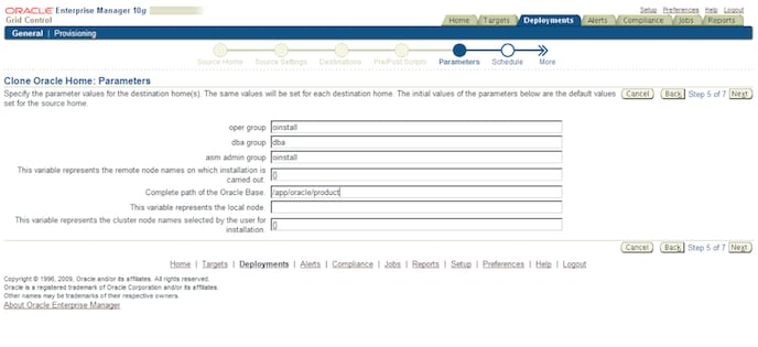

Click Next. This is followed by another page where you can enter a number of operating system specific parameters for the destination home, such as the names of the Oracle oper and dba groups and the asm admin group, the complete Oracle Base path and also the Oracle RAC node names if the destination is an Oracle RAC cluster of nodes. See Figure 9.
havewala-provisioning-f9
Figure 9

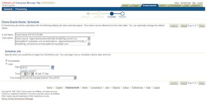

The following page (Figure 10) allows you to schedule the cloning process, either immediately or at a scheduled time. In this case, you decide that the job will be run immediately.
havewala-provisioning-f10
Figure 10

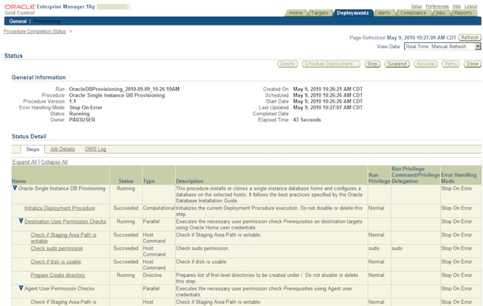

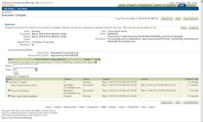

When you click on the Finish button, a confirmation that the Clone Home job has been submitted appears along with the message: “If you have chosen not to run the root.sh script as part of the clone, be sure to run it on each of the target homes after the job has completed successfully.”

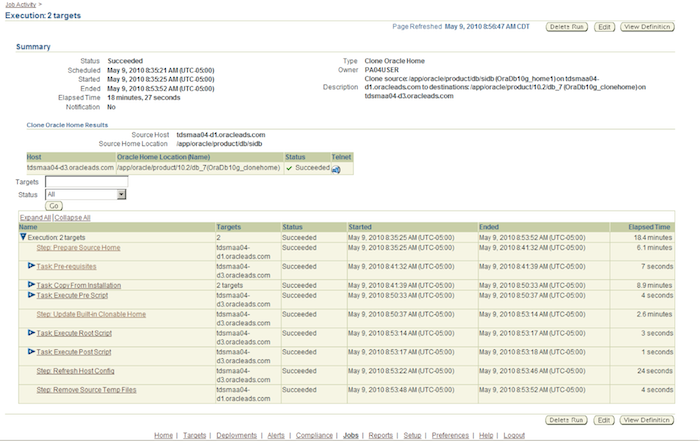

At this point, the cloning operation begins and its progress can be monitored by selecting View Job (Figure 12).
havewala-provisioning-f12
Figure 12
As the job starts executing its series of steps, the intial step is seen to be “Prepare Source Home”. If you click on this step, it displays the series of commands that are used to perform the preparation of the home. Essentially in this step, a Unix tar file is created in a temporary directory with the exclusion of certain files, and the tar file is then compressed. The output log of this step shows this process clearly and is reproduced below.

After the compressed file is created, the next step executed is “Check Pre-requisites” which checks for the space requirements in the Working Directory and the Oracle Home. Another step “Copy from Installation” transfers the file to the destination host, after which the pre-cloning scripts are executed as can be seen in Figure 13.
havewala-provisioning-f13
Figure 13
Another step in this job is to Update the Built-in Clonable Home. This step uses the Oracle Installer in the silent mode, and has the following output:

    3. Run the scripts
The cloning of OraDb10g_clonehome was successful.
Please check '/app/oracle/product/oraInventory/logs/cloneActions2010-05-09_08-50-39AM.log' for more details.
rmtree(/app/oracle/tmp/oemchd8627D0F9DD8A4EA6E040928D4B1A6F45, 0, 0)
2
At this point, the root script “root.sh” is executed. In this step the unix user oracle attempts to execute '/app/oracle/product/db/sidb/root.sh' as root on tdsmaa04-d3. To perform this activity, sudo rights are required for oracle on this server.
Next, the post-cloning scripts are executed and this is followed by the “Refresh Host Config” step. This step shows the following output:
  Output Log
 Starting collection...
 Successfully collected configuration for Host tdsmaa04-d3.oracleads.com.
 Capturing collected information into repository...
 Successfully recorded information into repository.
As can be seen in the log, the Oracle Enterprise Manager agent collects the configuration from the Host, this includes the information on the new Oracle Home which is now registered in the Oracle Enterprise Manager repository. After this, the source temporary files are removed from the working directory, and the overall Clone Oracle job has completed successfully (Figure 13).
A brand new Oracle Home has been provisioned on the destination server in this way.

So, instead of using the Clone Wizard, it is recommended to use the new functionality of “Deployment Procedures”. These are highly customizable sets of pre-defined steps used for database provisioning, allowing advanced operations such as using sudo or pbrun, and the possible inclusion of database creation along with the software cloning. We can now take a look at these procedures.
Move to the Deployments tab in Grid Control. Under the section “Deployment Procedure Manager”, select the Database Provisioning Procedures link. This displays available out-of-the-box and customized deployment procedures for deploying databases and replay clients (see Figure 14).
The Oracle Replay Client is a program which is available as part of the standard Oracle Client or the Oracle Instant Client. It is a multithreaded executable “wrc” – each thread responsible for submitting a captured session's workload. This is used for the Database Replay feature of the Oracle Real Application Testing Option (licensable) for Oracle Enterprise Edition.
havewala-provisioning-f14
Figure 14
Out-of-the-Box and Customized Procedures
As we have seen, Oracle Enterprise Manager supplies a number of out-of-the-box deployment procedures. Please note that it is not necessary to customize any procedure, in most cases the functionality provided by the out of the box procedures is enough. Customization provides an added benefit if you so desire.
On the Procedures page in Figure 14, it is possible to customize a procedure by simply selecting “Create like” (provided you are logged into Oracle Enterprise Manager as a user with the necessary rights) and create a new procedure with a new name. In a customized procedure, you can change the error handling of any steps (either stop on error, or continue on error) or you can disable or enable any steps.
The first procedure “Oracle Single Instance DB Provisioning” in the list above is such a customized procedure – this is obvious due to the different update dates and the different owner visible on the page (Figure 14). This is a copy of the out-of-box procedure “Oracle Database Provisioning” but with some minor steps disabled for the environment of the test. You will use this procedure for the purpose of this demonstration.

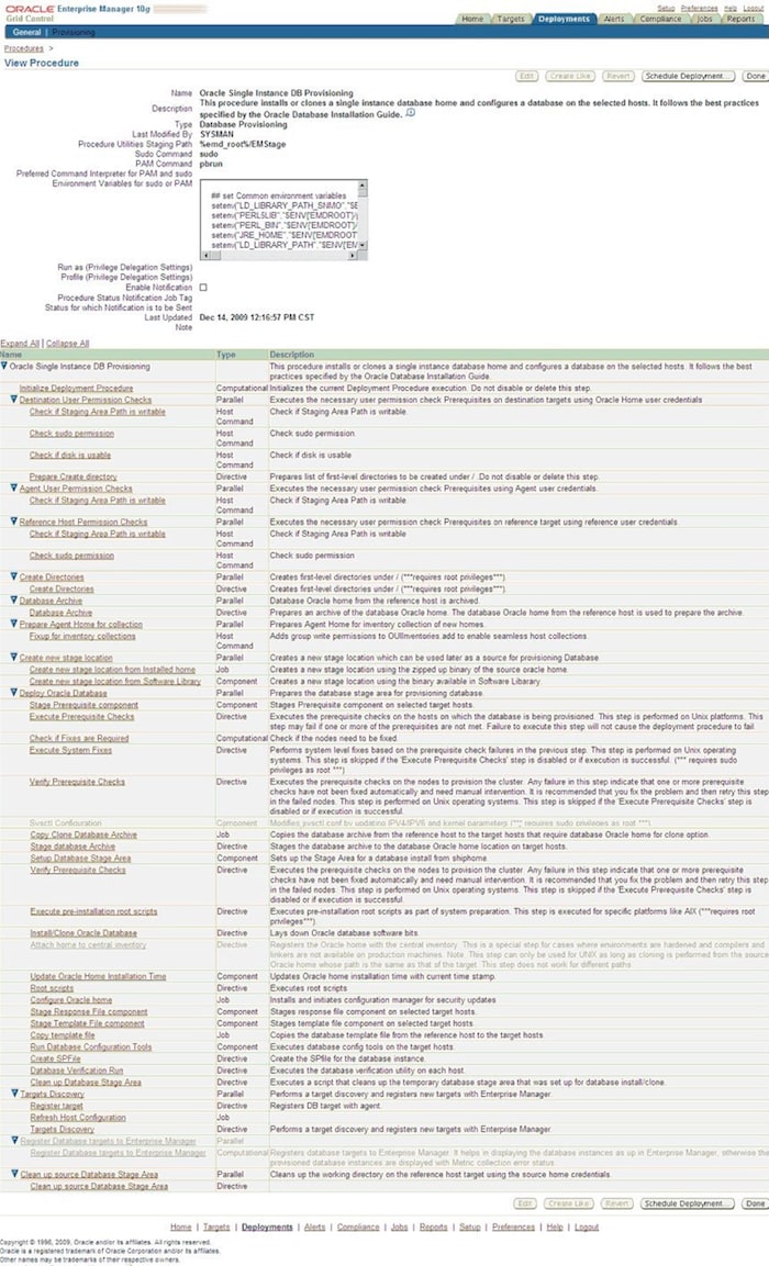

Select the “Oracle Single Instance DB Provisioning” procedure and click on the View button. This displays the detailed series of steps of this deployment procedure (Figure 15).
havewala-provisioning-f15
Figure 15
Ignore the fact that the “Register Database Targets in Enterprise Manager” step has been disabled, this step is normally enabled and is only disabled in this case because of the particuar testing environment that we have used. This step does not need to be disabled in a normal scenario and for all purposes you can consider it to be enabled, as it is in the normal out-of-box procedure.

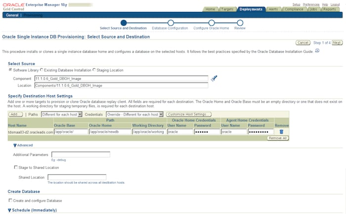

Schedule Deployment
Back on the list of procedures in Figure 14, select the “Oracle Single Instance DB Provisioning” procedure and click on Schedule Deployment.
This brings up the Select Source and Destination page (Figure 16).
havewala-provisioning-f16
Figure 16
On this page, select the Software Library radio button. This will allow you to use a Gold image from the software library as the source for the provisioning operation. Alternatively, you could choose an existing reference installation as the source. The other possibility is to select “Staging Location” which will allow you to use components created using the installation media in the software library.
At this point, use the Gold image as the source. Click on the torch icon, this brings up the Components page in Figure 17. Simply select the existing “11.1.0.6_Gold_DBOH_Image” from the list.
It is also possible to upload a different component at this point if you wish, by clicking on the Upload link on this page. This will upload it to the Software library.
havewala-provisioning-f17
Figure 17
After selecting the Gold image, you will be brought back to the Select Source and Destination page (Figure 16). Click on the Add button under the Specify Destination Host Settings section to add the destination host. This displays the window in Figure 18.
By default, only suitable hosts best suited for provisioning the Oracle database are displayed in this window. Select Show all hosts to display all the hosts, and click on the Go button. Tick the host tdsmaa03-d2.oracleads.com and then the Select button (Figure 18).
havewala-provisioning-f18
Figure 18
You are now back on the Select Source and Destination page (Figure 16). Click on the button Customize Host settings if you want to provide additional information such as Agent credentials, Custom Oracle Home name and Custom Host name. You would do this if your agent home and Oracle Home credentials are different. This brings up the Customize Host settings window (Figure 19).
havewala-provisioning-f19
Figure 19

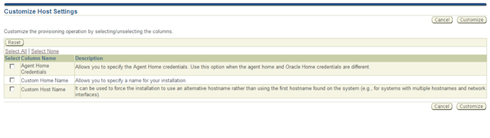

Tick Agent Home Credentials and click on Customize. This will take you back to the Select Source and Destination”page with the Agent Home credentials now appearing on this page as well (see Figure 20). Now, fill in more settings for the target server like the Oracle Base directory location, Oracle Home and the working directory, as well as the Oracle Home credentials and the Agent Home credentials.
Multiple Targets
We should note here that it is possible to add multiple destination targets on this page for the same provisioning session. Thus you can easily schedule a provisioning of multiple targets from a single Gold image, a reference installation, or the staging location.
You can change Paths to “Different for each host” and Credentials to “Override – Different for each host” once multiple targets are added on this page (Figure 20).
havewala-provisioning-f20
Figure 20
As the Additional Parameters on this page, you can provide any Oracle Installer parameters you want to be used, such as –debug. You can also specify a shared location to stage the binaries. This location should be shared across all destination hosts. Specifying a shared staging location in the case of multiple destination hosts will obviously reduce the provisioning time, since the binaries will not need to be copied to each destination host before installation can start. They only need to be copied to the shared location by the deployment procedure.
Tick Create and configure Database to also include a database in the provisioning operation along with the installation of the database software binaries. If this is not done, you will have to use the Oracle Database Configuration Assistant (DBCA) to manually create and configure a database.
At the bottom of the page, you can chedule the provisioning operation, either to run immediately or at a future scheduled time. Go to the Next page when you are done.

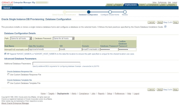

Configuring the Database
The Database Configuration page now appears (Figure 21).
havewala-provisioning-f21
Figure 21
On this page, you can specify the Database Configuration details. Type in the Data File location, Oracle SID (instance name) and domain for all the destination hosts you have specified, as well as the database password. The path and the password can either be the same for all the hosts or different.
Under the Advanced Database Parameters section, you can specify Oracle Database Configuration Assistant (DBCA) arguments in the Additional Database Parameters box, such as the characterset to use for the database.
In the other check boxes, you can specify if you want DBCA to use the Custom Database Response File and/or the Custom Database Template File, these can be used to create and configure databases as per corporate database and security standards. For example, it will be possible to exclude or include certain database options, set certain parameters and so on. If no templates are specified, default out of the box templates will be used by DBCA.
It is also possible to create a database that uses Oracle Automatic Storage Management (ASM) for data storage. Simply use a response file with the appropriate answers and settings for ASM.
Move to the Next page. Figure 22 appears.

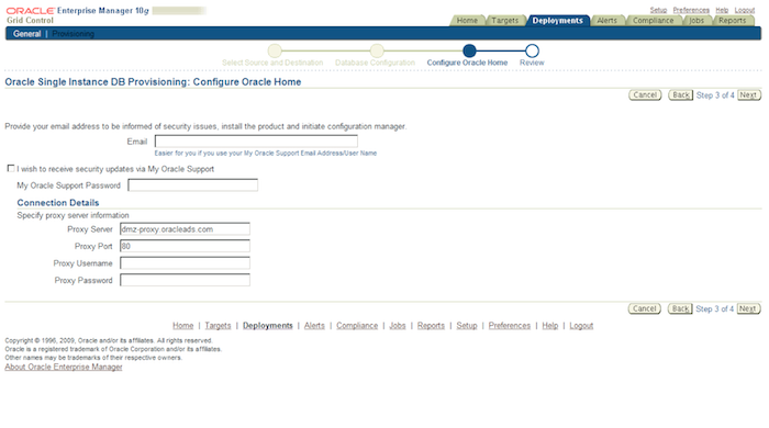

On this page, you can specify an Email address and your Oracle Support password to receive security updates from Oracle Support. Select Next to move to the next page.

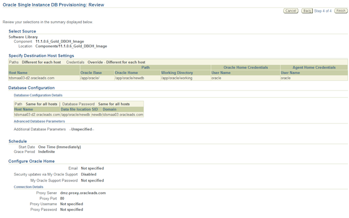

The Review page is now displayed (Figure 23). Check all the settings on this page and make sure they are correct. Then click on the Finish button.
havewala-provisioning-f23
Figure 23

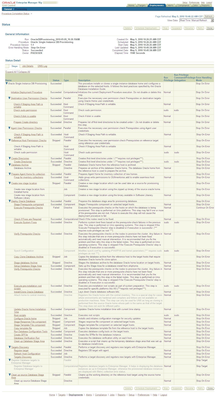

Drill down on the procedure you just launched by clicking on the corresponding link on this page. This enables you to see the progress of each of the steps as they are being executed (Figure 25).
havewala-provisioning-f25
Figure 25
You can now sit back, relax and wait for the steps to complete.
Some steps may be skipped depending on the prior selections in the question and answer screens. The procedure checks all the required software and hardware pre-requisites and makes sure that the database is provisioned using the Oracle recommended best practices. Some of the failed requirements are also fixed automatically, such as kernel settings.
After some time, the steps complete successfully and the deployment procedure is completed and appears as status “Succeeded” (Figure 26).

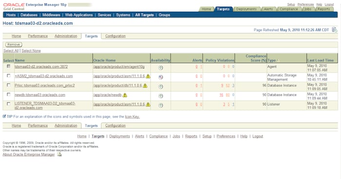

After the database targets are registered in Oracle Enterprise Manager, the new database “newdb.tdsmaa03.oracleads.com” along with its newly provisioned Oracle Home “/app/oracle/newdb” appears in the list of Oracle Enterprise Manager targets, such as the Host Targets screen seen in Figure 27. The status is also seen as “Up”.
We should note here that there may be a gap of a few minutes after registration, before the new target appears in Enterprise Manager. Simply refresh the screen after a few minutes.
