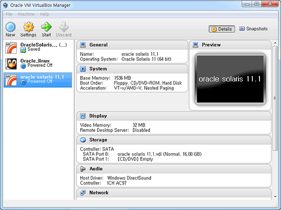

  1. Using Oracle VM VirtualBox (shown in Figure 1), install Oracle Solaris 11.1 on your system.
    Note: If you do not have Oracle VM VirtualBox installed, you can download it here and then refer to the Oracle VM VirtualBox User Manual for installation information. You can also download the Oracle Solaris 11.1 VM for Oracle VM VirtualBox image—a preinstalled virtual machine that provides a convenient way to evaluate Oracle Solaris 11 from inside Oracle VM VirtualBox.
    Figure 1
    Figure 1. Oracle VM VirtualBox

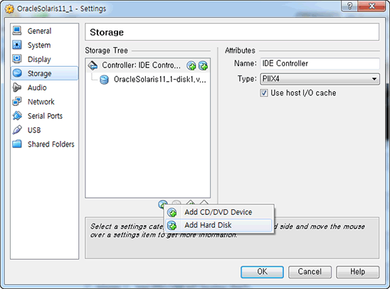

  2. Add a disk to be used in the configuration ZFS, as shown in Figure 2.
    Figure 2
    Figure 2. Adding a Disk

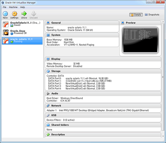

  3. Add three more disks. When you are done, Oracle VM VirtualBox Manager will look similar to Figure 3.
    Figure 3
    Figure 3. After More Disks Are Added

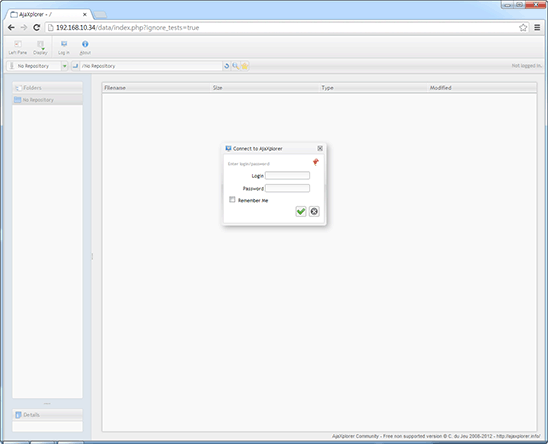

  1. For a normal PC using a Web browser, the client connection and diagnostic messages are displayed first. Then, as shown in Figure 4, a security warning is displayed stating that the initial user ID and password are both admin. The password can be changed after the initial login.
    Figure 4
    Figure 4. Security Warning

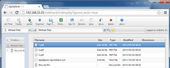

    Figure 5
    Figure 5. Connecting to AjaXplorer

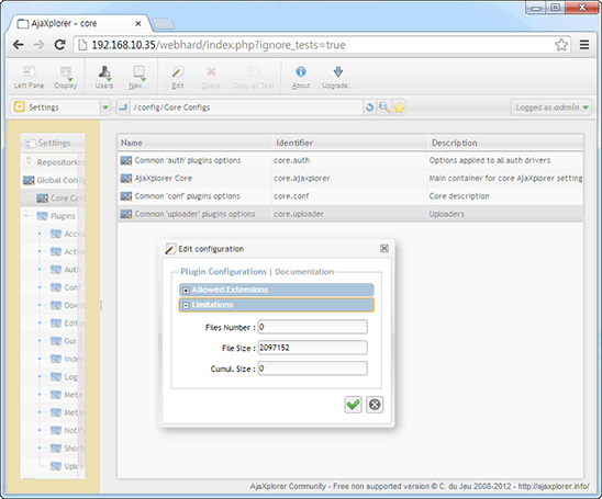

  2. In order to check and set the file size limit, select Settings and then select Global Configurations, Core Configs, Common 'uploader' plugins options, and Limitations. You can then see and change the file size, as shown in Figure 6.
    Figure 6
    Figure 6. Checking and Changing File Size Limits
  3. As shown in Figure 7, using a Web browser, you can use the Web storage.
    Figure 7
    Figure 7. Using the Web Storage from a Browser

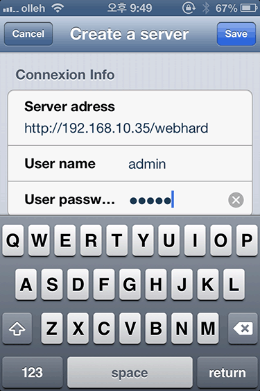

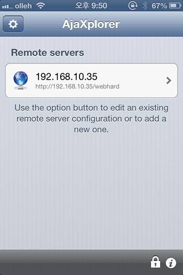

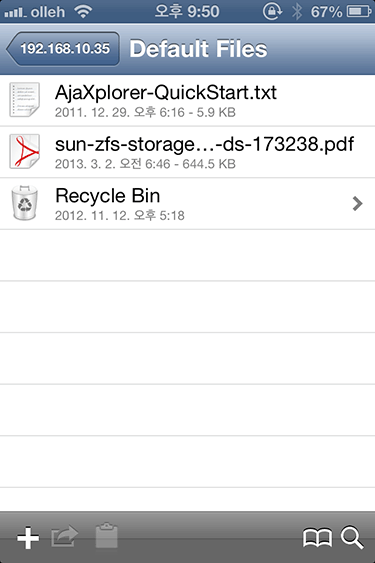

  4. As shown in the Figure 8 through Figure 12, you can use the storage in the same way using an Android-based smartphone or an iPhone.
    Figure 8
    Figure 8. AjaXplorer for iOS
    Figure 9
    Figure 9. Server Settings
    Figure 10
    Figure 10. Created Server
    Figure 11
    Figure 11. Server Connection
    Figure 12
    Figure 12. File Access

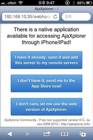

  5. A native application, which costs US$0.99, is available for accessing AjaXplorer through an iPhone or iPad.

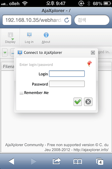

    As shown in Figure 13 through Figure 15, even without using that app, you can use a mobile Web browser to access the storage.
    Figure 13
    Figure 13. Connected Screen on Mobile Web Browser
    Figure 14
    Figure 14. Login Screen on Mobile Web Browser
