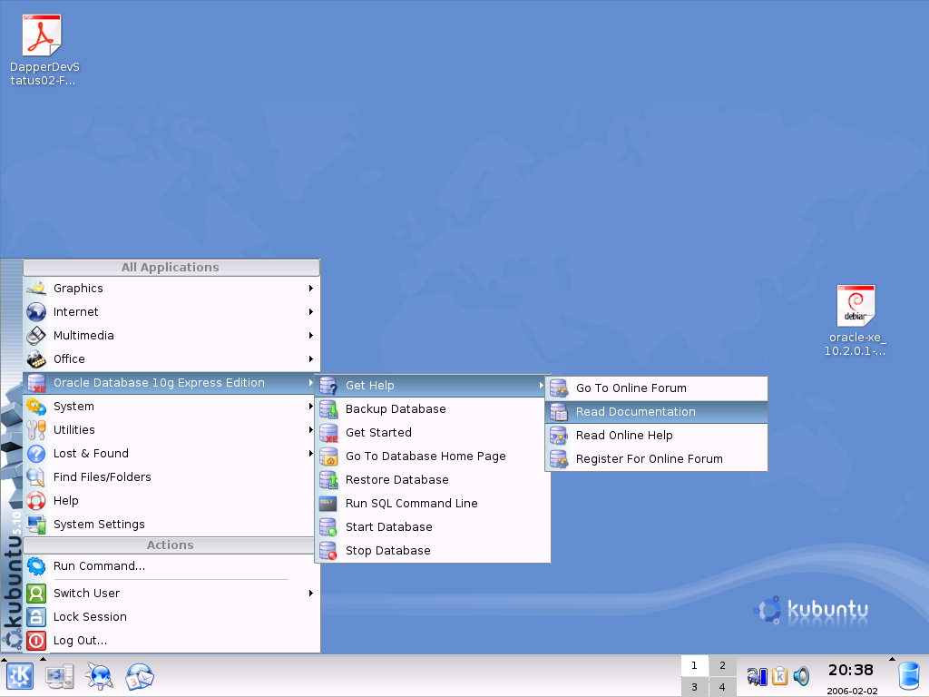

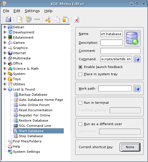

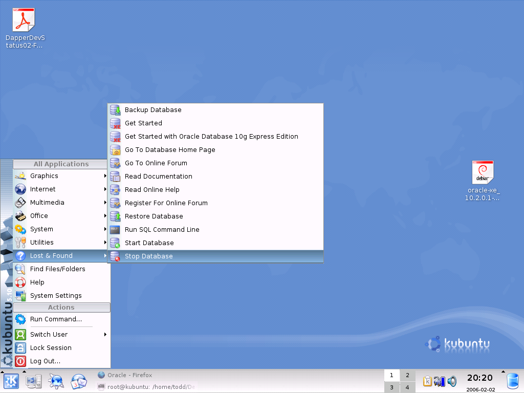

Q. Hey, if it's installed, where are my menu items?
A. With this beta you will find XE's lost menu items, in the conveniently named Lost & Found. But before you run off to fix the structure with KDE's menu editor, you might try rebooting. For me, a reboot seemed to refresh the menu structure, offering a more presentable menu.
Q. Minor menu item anomaly after reboot: The refreshed menu still has an extra "Getting Started with XE." Why?
A. I guess they really want us to get started with XE!

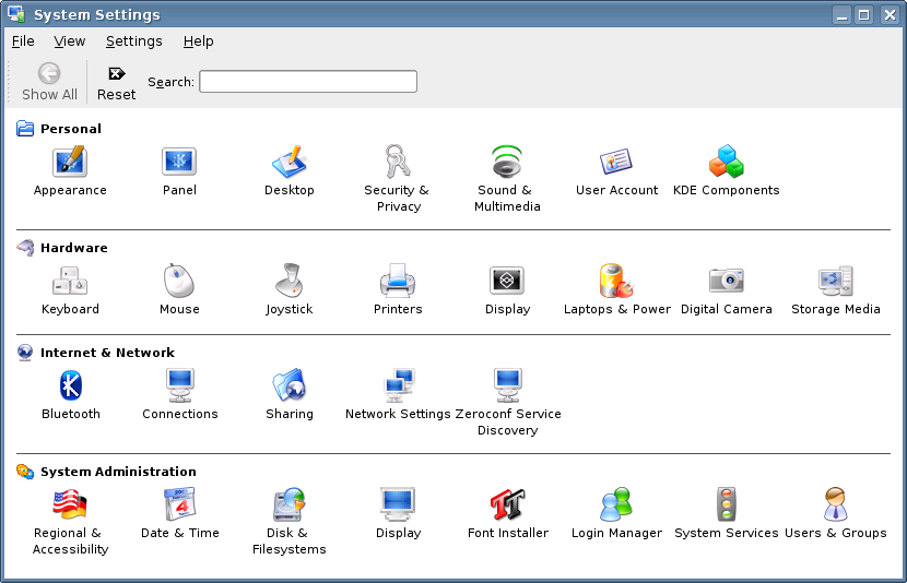

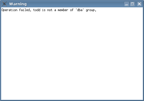

Q. How come my user 'todd' can't start the database using the created menu item?
A. User 'todd' is not a member of the 'dba' group. You can add the user by navigating to the System Settings using the adminstrative mode to add user 'todd' to the 'dba' group.
