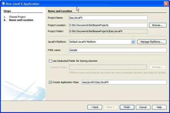

We start this adventure with NetBeans. Choose File->New Project, choose JavaFX, and then choose JavaFX FXML Application (see Figure 1). This creates a very simple JavaFX app that includes a main application class, a controller class to provide the actual backing logic for the window defined in Scene Builder, and the FX Markup Language (FXML) file containing our window definition (XML) code.
Figure 1
Figure 1. Creating a Simple JavaFX Application
I used "EasyJavaFX" for our project name (see Figure 2).
Figure 2
Figure 2. Naming the Project

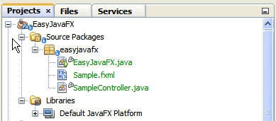

Here's a quick summary of the three files (see Figure 3):
  • EasyJavaFX.java contains the main application class. We won't do anything with this class for our example, because its primary purpose in life is to load the window definition code contained in the FXML file and then show the main stage/scene. You'll keep the JavaFX terms straight with ease if you relate them to a theater: a platform holds a stage, which contains scenes.
  • SampleController.java is our controller class, which provides the "brains" behind the graphical interface. If you open the SampleController, you'll see that it includes a property and a method tagged with @FXML. This tag enables the integration of the visual controls and elements you define using Scene Builder, which are stored in an FXML file.
  • Sample.fxml is the definition file for our sample window. You can right-click and edit the file name in the tree to view the underlying FXML—and you may need to do that if you change file names or properties by hand—or you can double-click it to open it (visually) in Scene Builder. We'll take a look at that next, but first a quick look at our little project.
Figure 3
Figure 3. Project Files

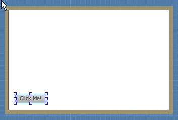

Opening Sample.fxml in Scene Builder results in the display of a very spartan window (see Figure 4).
Figure 4
Figure 4. Scene Builder Window
Let's rework it a little. For a complete walkthrough of Scene Builder, see the JavaFX Scene Builder User Guide, but here's the nickel tour: stuff and navigation to the left, picture in the middle, and properties on the right. We'll make some small modifications as follows.
First, click the entry for Button in the Hierarchy panel (bottom left), which selects the button in the middle Content panel. Move it down and over a bit to make room for the second button (see Figure 5).
Figure 5
Figure 5. Adding a Button

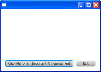

Right-clicking the project in the Projects window to the left and clicking Run provides the satisfying results shown in Figure 9.
Figure 9
Figure 9. Outcome of Running the Project
