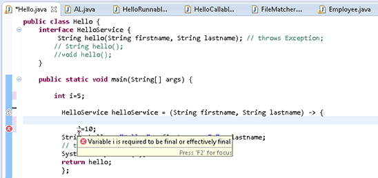

A variable used in a lambda expression is required to be final or effectively final. To demonstrate this, declare a local variable and initialize the local variable:
int i=5;
Assign the variable in the lambda expression body. A compiler error—Variable i is required to be final or effectively final—gets generated, as shown in Figure 5.
Figure 5

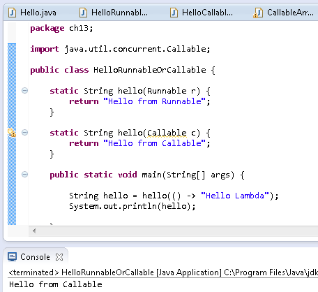

Inferring the Target Type in Overloaded Methods
When you invoke a method that is overloaded, the method that best matches the lambda expression is used. The target type and the method argument type are used to resolve the best method.
In theHelloRunnableOrCallable class in Listing 15, twohello() methods (thehello() method is overloaded) with return typeString are specified: one with parameter typeCallable and the other with parameter typeRunnable.
Thehello() method is invoked with a lambda expression as a method argument. Because the lambda expression—() -> "Hello Lambda"—returns aString, thehello(Callable) method is invoked, andHello from Callable is output because thecall() method ofCallable has a return type, whereas therun() method ofRunnable doesn't.
import java.util.concurrent.Callable;
public class HelloRunnableOrCallable {
static String hello(Runnable r) {
return "Hello from Runnable";
static String hello(Callable c) {
return "Hello from Callable";
public static void main(String[] args) {
String hello = hello(() -> "Hello Lambda");
System.out.println(hello);
Listing 15
The output fromHelloCallableConditional is shown in Figure 23.
Figure 23

References to Local Variables
In providing an alternative to anonymous inner classes, the requirement for local variables to be final in order to be accessed in a lambda expression was removed. The requirement for a local variable to be final to be accessed from an inner class is also removed in JDK 8. In JDK 7, a local variable accessed from an inner class must be declared final.
The requirement for a local variable to be used in an inner class or a lambda expression has been modified from "final" to "final or effectively final."
