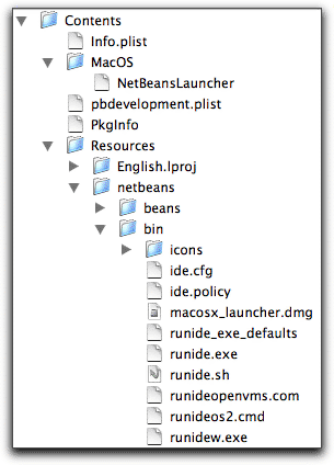

Consider again the sentence from the NetBeansLauncher instructions that says in order to locate the NetBeans root directory, "First it looks into NetBeansLauncher.app itself." This implies that NetBeansLauncher is a directory with the name "NetBeansLauncher.app". In the mounted disk image, either right click or Ctrl-click on the NetBeansLauncher icon and choose to "Show Package Contents".
(Click image to enlarge.)
The structure is the same for all Mac OS X applications. There is a Contents directory with an XML file named info.plist, a text file named PkgInfo, a MacOS directory, and a Resources directory. If you don't have a creator code registered with Apple the PkgInfo text file should contain only the following.
AAPL????
If you have a creator code, use it inplace of the question marks. Ordinarily the MacOS folder contains a small stubfile that launches the Java VM. In this case the NetBeans team has written their own application. We will look more closely at a property list file in the next section. For now, take a look at the contents of the Resources directory.
You can see the contents of the same netbeans package inside of the Resources subdirectory. This is your key to deploying on Mac OS X. Add in the necessary pieces and then just bundle up your ordinary distribution in the appropriate location. If you have a more flexible build process you should also strip out those pieces that aren't needed for the Mac OS X application such as the Windows executables.

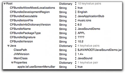

Press "Create Application" and enter the name "JavaSoundDemo". A Mac OS X application is created for you. You can show the package contents of the generated application as before. You can view the property list with Apple's Property List Editor or with any text editor. It is just an XML file with properties stored as name - value pairs.
The Java properties indicate the location of the jar file, the name of the Main class, and the version of the JRE to be used. The other properties include a pointer to the icon file and to the Java application stub file that is the native executable.
