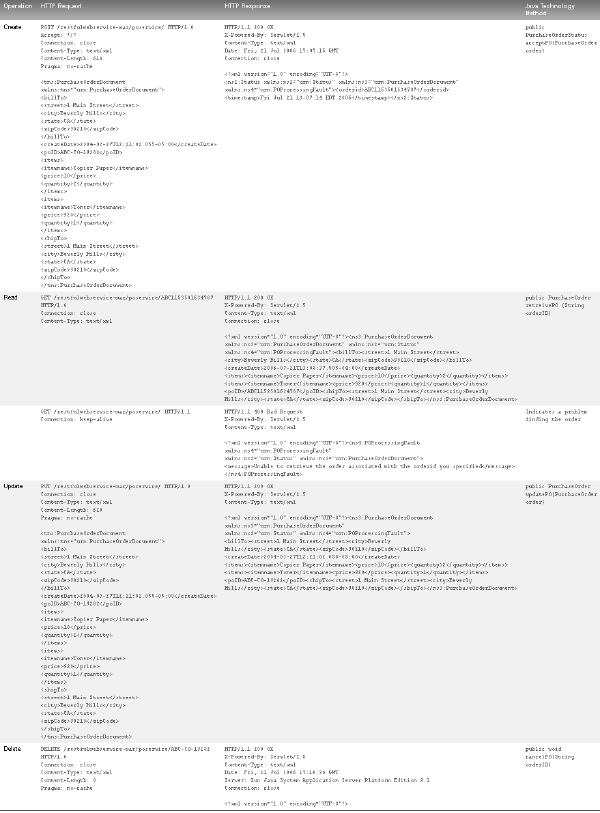

Table 3 shows the HTTP request and HTTP response messages for the operation in the implementation of the purchase order service.
Table 3: HTTP Request and HTTP Response Messages for the Purchase Order Service
(Click herefor larger sample.)
Use cases in which the service needs to indicate an exception can do this by setting the appropriate HTTP status code and response message on the MessageContext. For example, a response to an order retrieval process with an invalid ID can be implemented by setting the HTTP 400 status code and including the XML from the POProcessingProblem.xsd schema. Code Fragment 1 illustrates this.

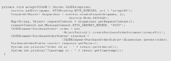

Code Fragment 3 demonstrates how to make a similar POST request, but it differs from Code Fragment 2 in that it sends and returns JAXB-generated objects rather than handling strings directly.
Code Fragment 3

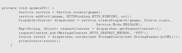

Code Fragment 4 demonstrates how to make a similar PUT request using the Dispatch interface.
Code Fragment 4

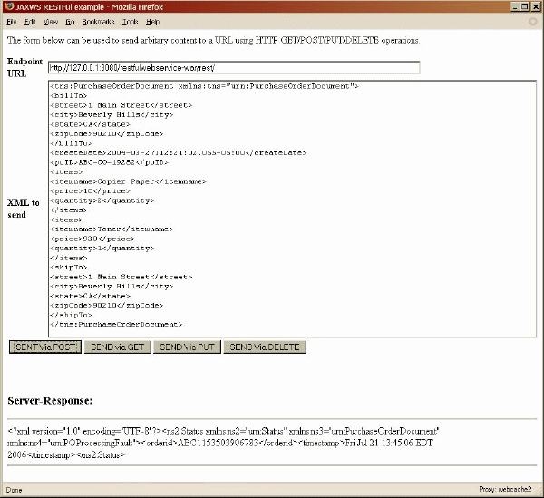

Accessing Services Using Browsers
Because RESTful web services deployed in JAX-WS are exposed using the standard HTTP protocol and methods, they can be easily accessed from browsers. In addition to using simple GET and POST requests directly from browsers, developers can leverage the capabilities of the JavaScript technology XMLHttpRequest object that most modern browsers support. This is the same object used for building AJAX user interfaces (UIs).

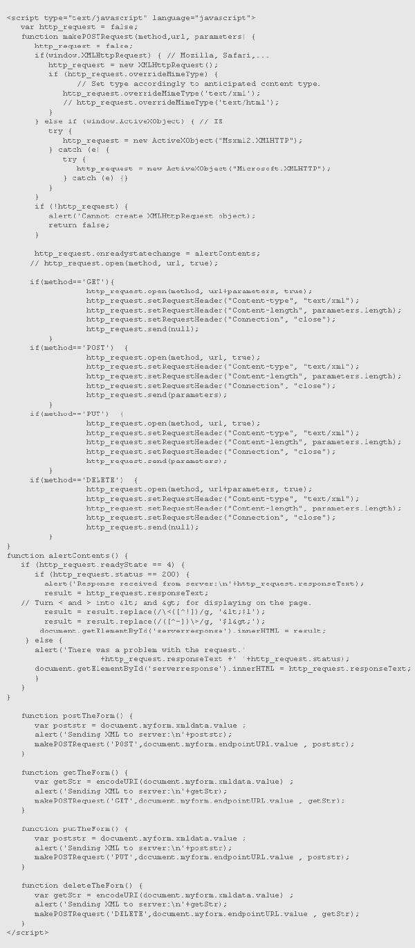

Code Sample 4 shows a simple script that is included with the downloadable sample code and test client that you can use to test RESTful web services from browsers.
Code Sample 4
Figure 1 shows the display resulting from this code.
Figure 1: Resulting Display

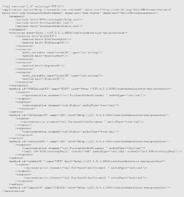

Web Application Description Language (WADL)
The style of documenting RESTful web services that this article has previously described is fine for use by developers, but it prevents tools from programmatically consuming such services and generating artifacts specific to programming languages. For example, a WSDL file can be consumed by various tools and proxies or by generated stubs that applications can use directly. A research effort from Sun Labs called Web Application Description Language (WADL)attempts to resolve some of these issues by providing a means to describe services in terms of schemas, HTTP methods, and the request or response structures exchanged. The schema in Code Sample 5 shows a sample WADL description for the example discussed previously.
Code Sample 5
