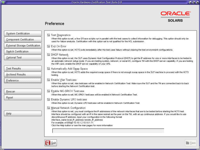

  • On System Under Test (SUT)
    • Using GUI: To manually configure the IPs, click Options and select Manual Network Configuration, follow the instructions to input the network configuration and then click Save button.
      image:System Under Test

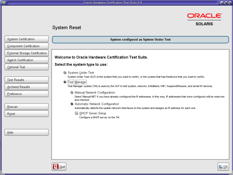

  • On Test Manager (TM)
    • Using GUI: Select Manual Network Configuration and then click the OK button.
      image:Test Manager Window
